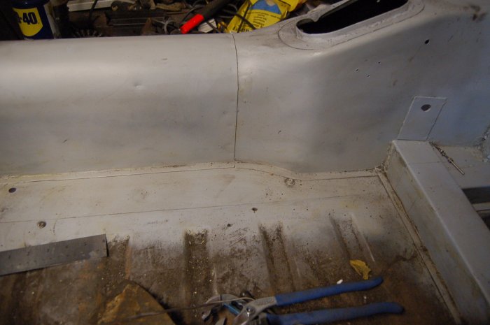

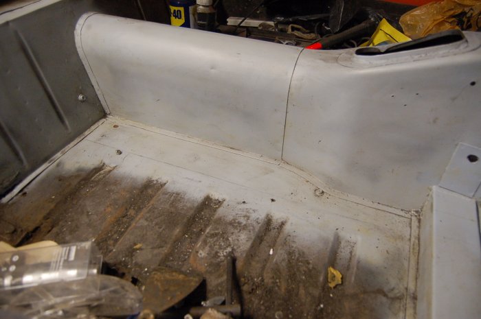

still trying to figure out how to repair things. Just when I think I've got it sorted I get a curve thrown.
My Sprite project - An experienced restorer has advised I should cut the floor pan a few inches out from the transmission and join the new half floor to the remains of the old with an overlapped (joddled) joint. I can see this is more forgiving for cutting accuracy and ease of fitting. He's also advisesthat a butt joint although strong tends to induce fatigue failure either side of the joint. The other school is that a joddled joint is a bodge and it should most certainly be butt welded. As a beginner I'm swayed towards the overlap and joddle - the car isn't going to be concours or anything close but hopefully solid. The floorpan is also relatively thin (1.2mm) so again I presume an overlap is more forgiving. I've enclosed pictures - you can hopefully see the line where I'm intending to cut. (the grey primer is great for marking out in pencil)
Any thoughts
Harry
