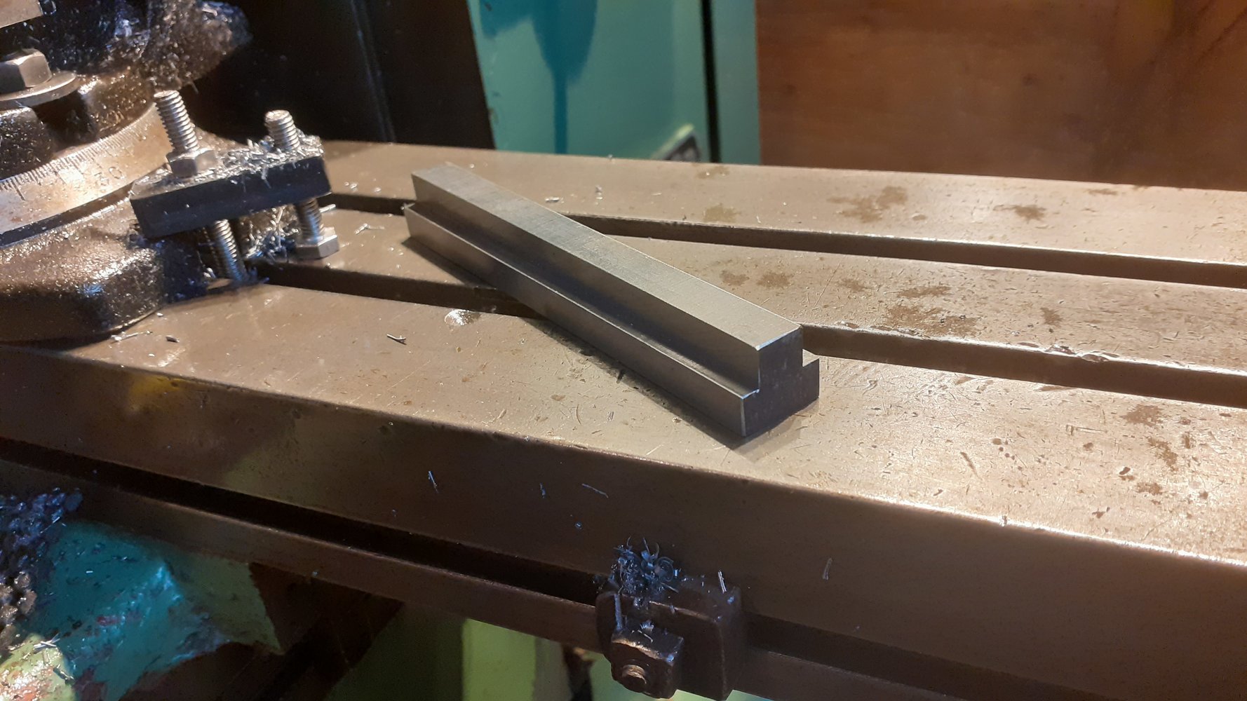

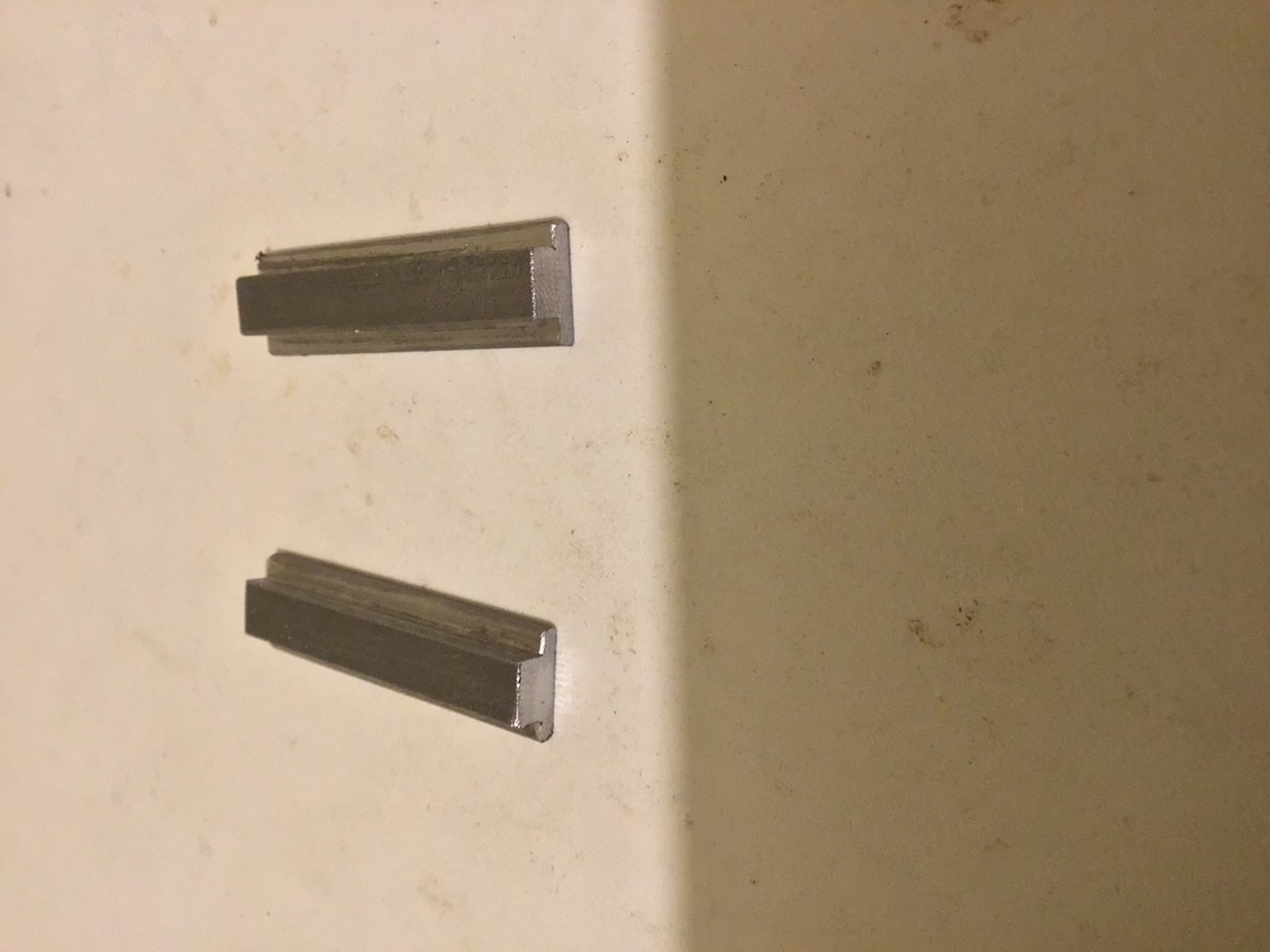

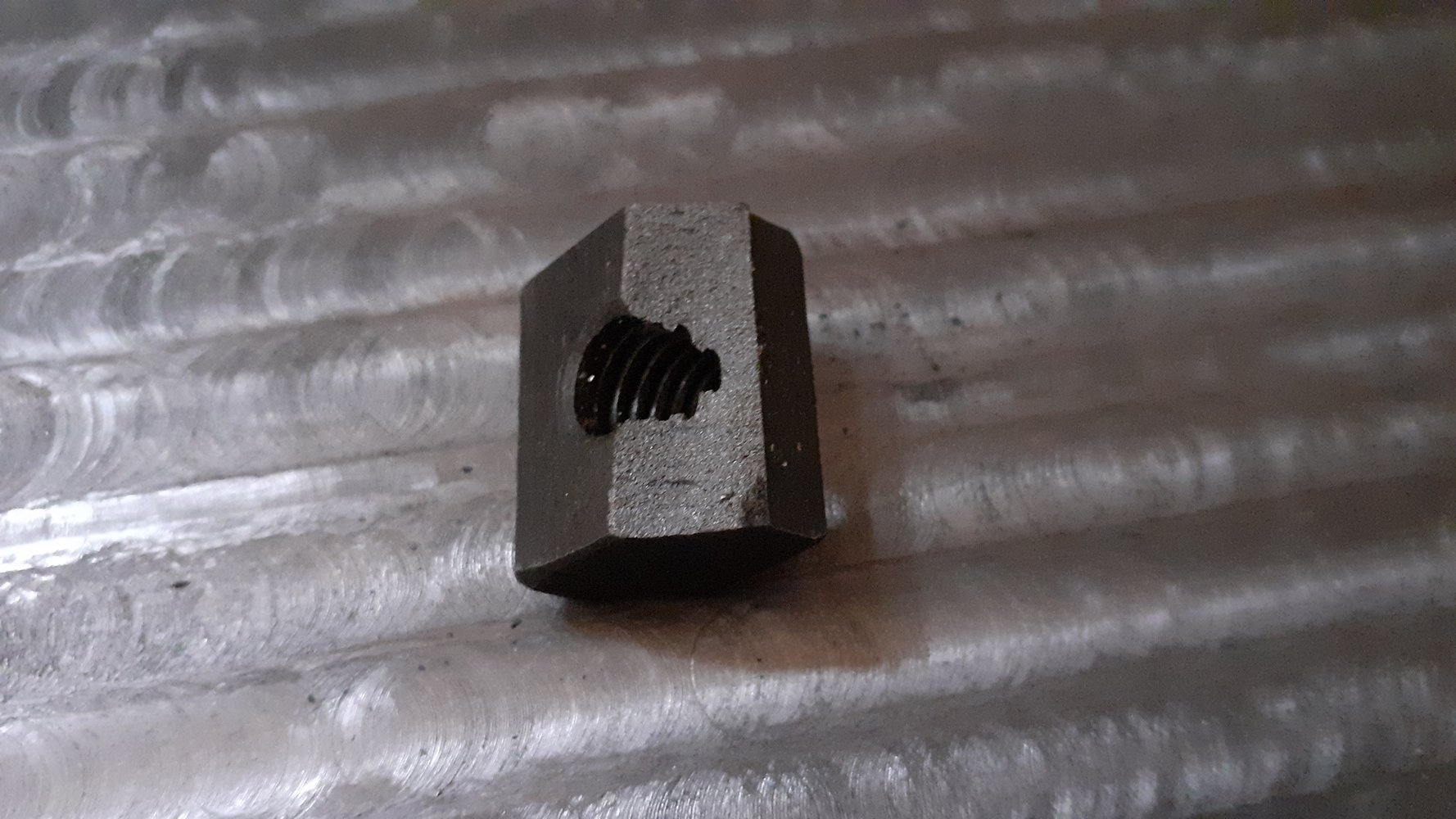

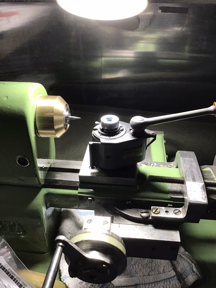

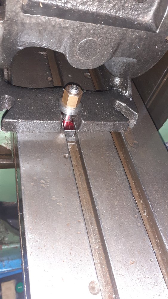

spent the afternoon milling some long small long T nuts ready to fit the Multifix QCTP they are 50mm long 6mm thick , had to file the last 1/2 mm because I couldn’t get enough meat above the vice and get a good grip, once fitted they should not have to be removed the only bit that will be undone fairly regularly will be the 10 mm bolt in centre of the 8mm plate that is going on to the T’s so do I need to harden and temper them.
thanks Dell
