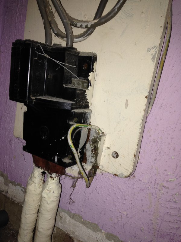

Quick couple of questions for the sparks:
Conclusive proof that ignorance is bliss!
After 10+ years in our house I felt the need last night to check if our supply was TN-S or TNC-S.
Turns out it's TN-S, all well and good. However, after taking some pics in the deep dark depths of the under-stair cupboard I've spotted a few concerns with the Earth bonding arrangements.

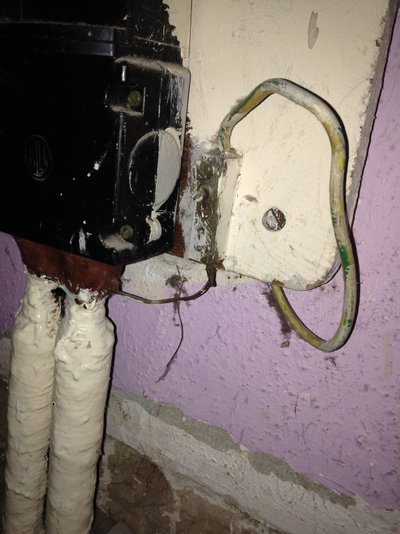

Firstly the Gas and water pipe Earth straps are bought back to the earth strip in the Consumer unit rather than an external earth block. The CU is then bonded to a 2 way earth block which in turn is bonded to a clamp on the incoming supply pipes/conduit.

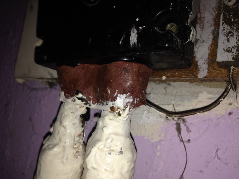

From the looks of it the connection between the earth block and the clamp is being made by a bare piece of copper cable maybe 1.5mm - 2.5mm CSA!

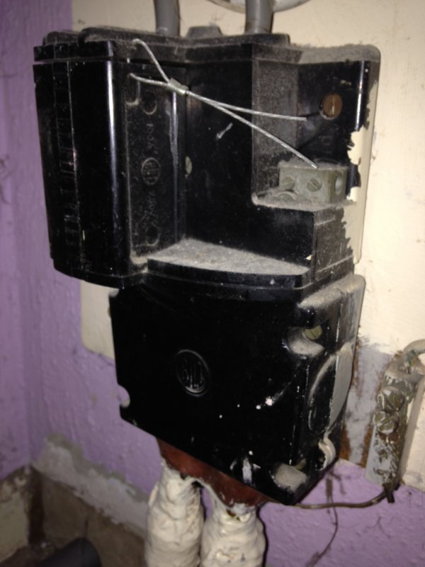

The main 100A fuse unit looks like a TNC-S unit with provision for a PEN type Earthing terminal.
So, after all that rambling: is the Pipework bonded to the CU earthing strip OK and how should I deal with the main Earthing conductor? Can an independent Spark sort this out or does the DNO need to rectify it (if so how do I get them involved and who do I contact?).
Pic below shows the incoming pipe clamp and the tiny copper connection to the main earth terminal. The clamp is not really visible but is there under the brown/red hardened putty type stuff:
