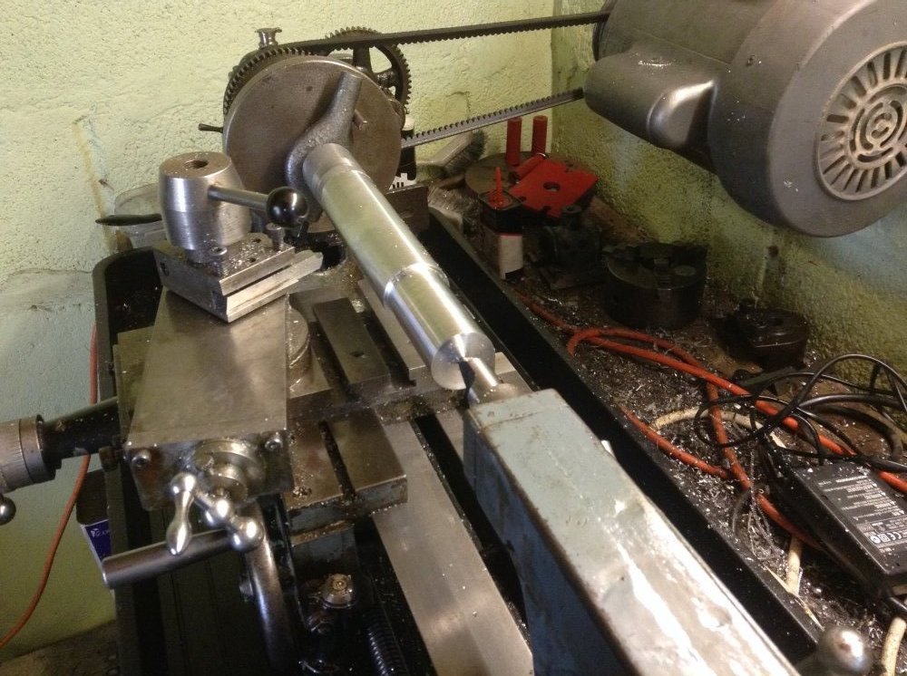

Actually I meant 'expressing' in hundredths of a mm, if you can turn work to that tolerance (four tenths of a thou) then fair play to you. The thing is that the originals won't have been produced to such tight tolerances so replicating them to 'microns' isn't necessary nor practical, if the micrometer even repeats to that scale.
I didn't mean to cause you any offense, just point out that no-one uses microns as a term in regular machining.
I'm planning on cutting the thread with a tap as it's an imperial lathe with an odd combination of change wheels and I can't remember the set up for an approximation of 1.5mm! On my previous attempt at making this stem (two years ago) I cut the thread on the lathe. I cut the thread first and then made a male threaded mandrel with a centre hole in it to support the part between centres. By the time I got that far I thought I was home and dry and messed up turning the diameters! Got a bit further today with the two final diameters for the Lower yoke and bearing finish turned within spec.No harm in working to the closest tolerances you can on a one off. I spy a thread dial on the saddle, are you going to cut the threads on there too?
With so much attention on the diameters I probably got the length wrong!If you have copied the original to 0.01mm there shouldn't be any hoping involved![]()
I cut it from solid bar but drilled a 10mm hole right through for the tank vent.Did you cut it from solid bar or tube?
Lol. It's fine where it matters! The middle bit will have a fair taper due to the length but that's not important thankfully.Have you checked it for taper?![]()
