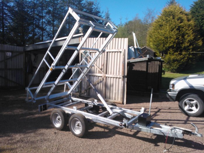

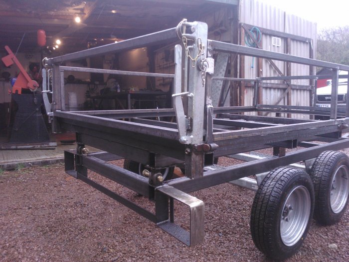

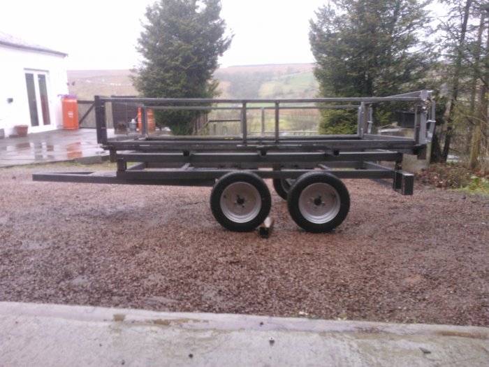

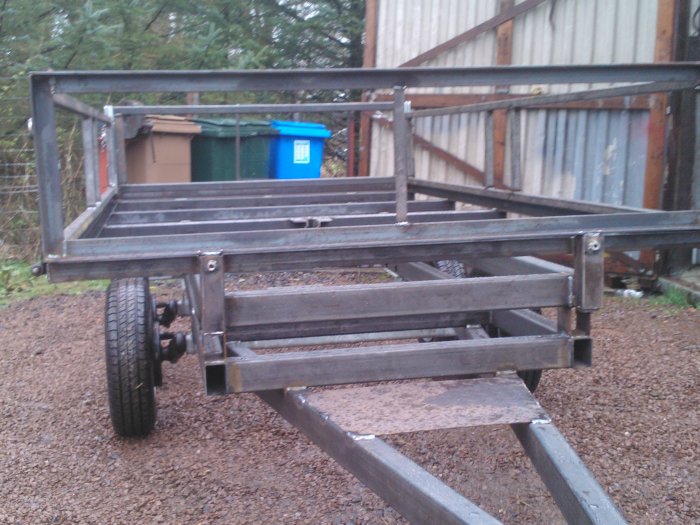

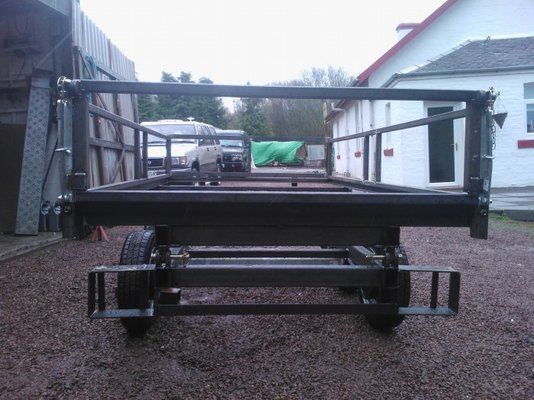

Decided a while back that I wanted to build an 8x5 tandem axle tipper trailer after getting the axles, hitch and wheels from "Feen" on here!
The fabrication has taken me just under 3 days - plenty of brew breaks
those with a good eye will notice a little bit of "welsh" engineering in there
Just got to dismantle it and get it up to the galvanisers next week and then wait!

total weight of the chassis, tipper bed, sides, tailgate and headboard was 210Kg. Very happy with that weight as I will keep the overall weight of the completed trailer under 500Kg
