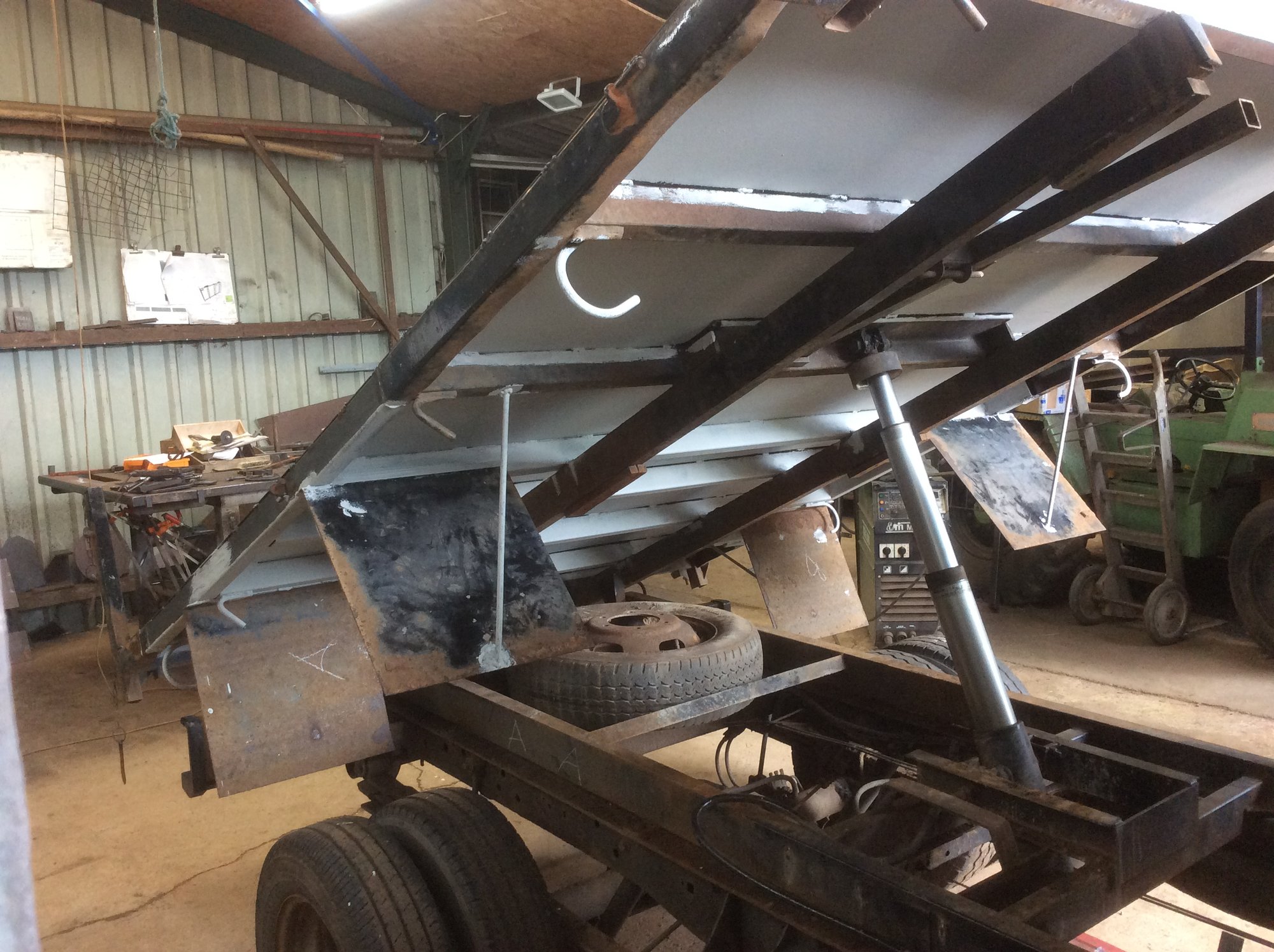

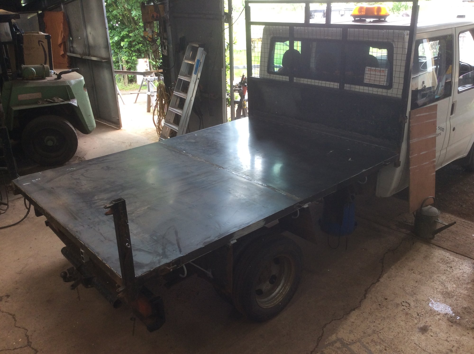

N nickk Member Messages 5,874 Location Hay-on-wye Jun 18, 2019 #1 truck repair in the workshop this week,usual box,80/40 & 60/40,then 2 mm sheet floor,managed to get some large sheets,so made a butt joint in the centre ,instead of an overlap,for clean ejection of materials.

M MoreWellie Forum Supporter Messages 1,885 Location Warwickshire, UK Jun 18, 2019 #2 Pretty sure you won't have a problem with nickk said: clean ejection of materials. Click to expand... with a nice shiny smooth floor like that Edit: getting them to stay still might be an issue though!
