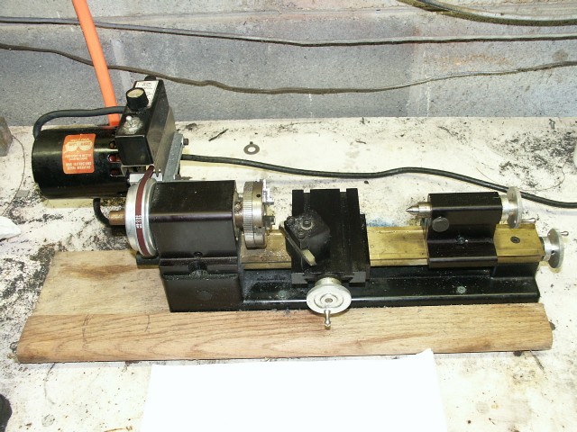

Picked this up off ebay locally:
It is tiny. 3" swing and 8" between centers. Big enough for my needs.
It is a Craftsman, made by Sherline (same as their 4000 model). Seems to work well. There is a bit of slop in the chuck at times. Seems it has been overtightened in some places. Will probably pick up a 4-jaw chuck later. Tempted to get the thread cutting attachment.

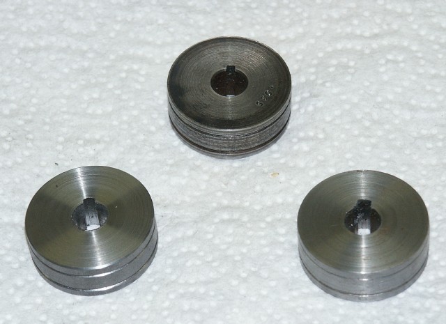

I decided a first test would be to make a roller for my MIG feeder. I had aametalmaster make one (thanks again) and happened to have some SS the right size.
Top is the stock .035/.045 roller. Left is the 0.023/.030 roller I made (60 deg V-groove) and right is the one by aametalmaster. Note key slots cut by jig saw. They all work well.
Been fun and learning a lot. Picked up a drill chuck, parting tools and some cutting bits. Always wanted a lathe as there were many times I wish i had one.
