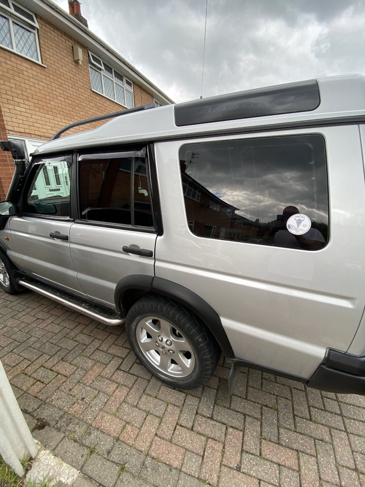

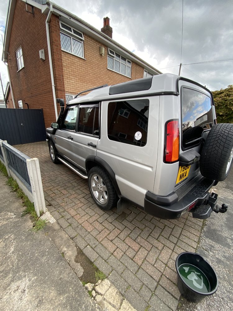

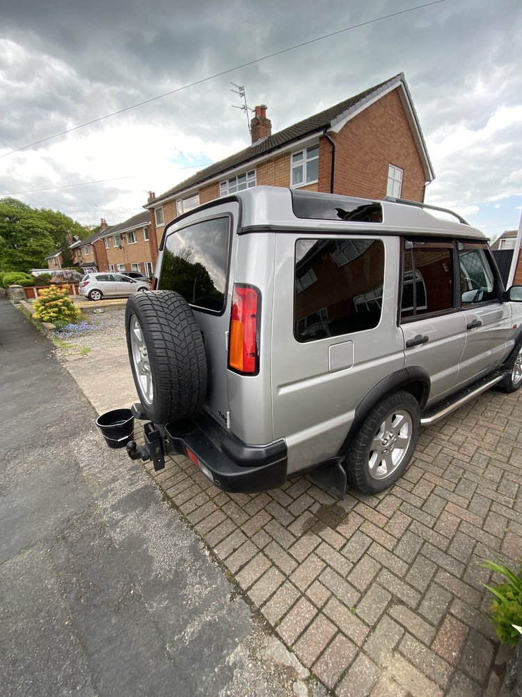

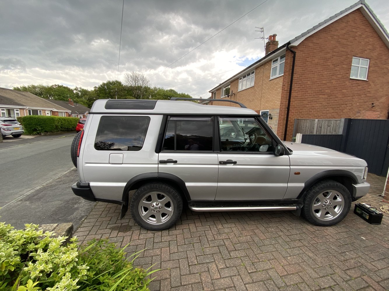

You do that to template the windowHave you put the film on the outside of the glass ? or just placed out there before fitting to the interior .

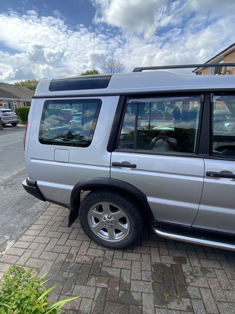

Yeah first pic beforeThe windows in the bottom few photos look quite dark. Are the photos before and after, the first ones look lighter?
I see dogs in cars with their snout poking out of the window. They seem to lap it up. Putting a window down seems to work well.

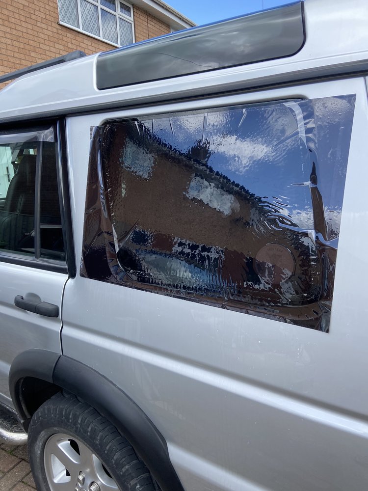

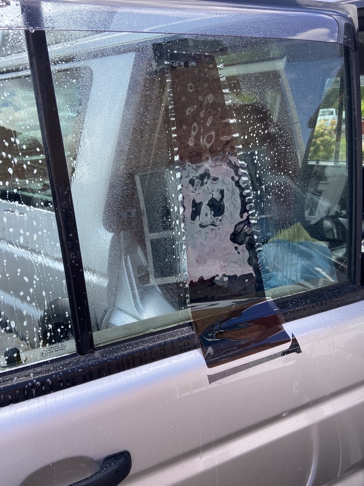

Still a bit of moisture, it keeps wicking back up and i cant get behind the trim. Ill keep squegeeing itNice job! Is the edge starting to crease in a couple of spots in the last pic?
A bit of gentle heat will help get any creases and bubbles that form out.
If you pre-shrink them they're less likely to crease like that but as I said, just use a bit of gentle heat from a hairdryer or heat gun and they'll come out just fine.Still a bit of moisture, it keeps wicking back up and i cant get behind the trim. Ill keep squegeeing it
