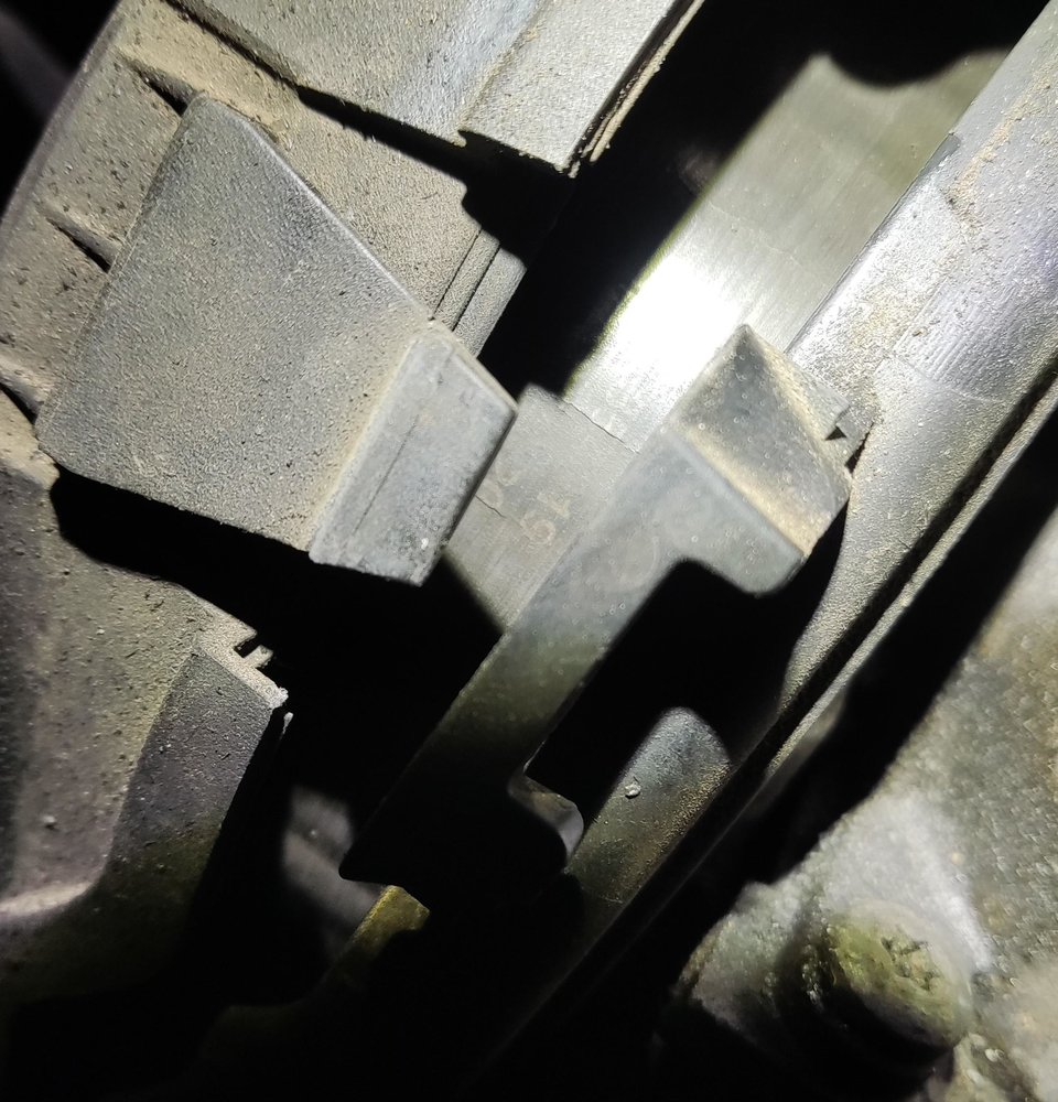

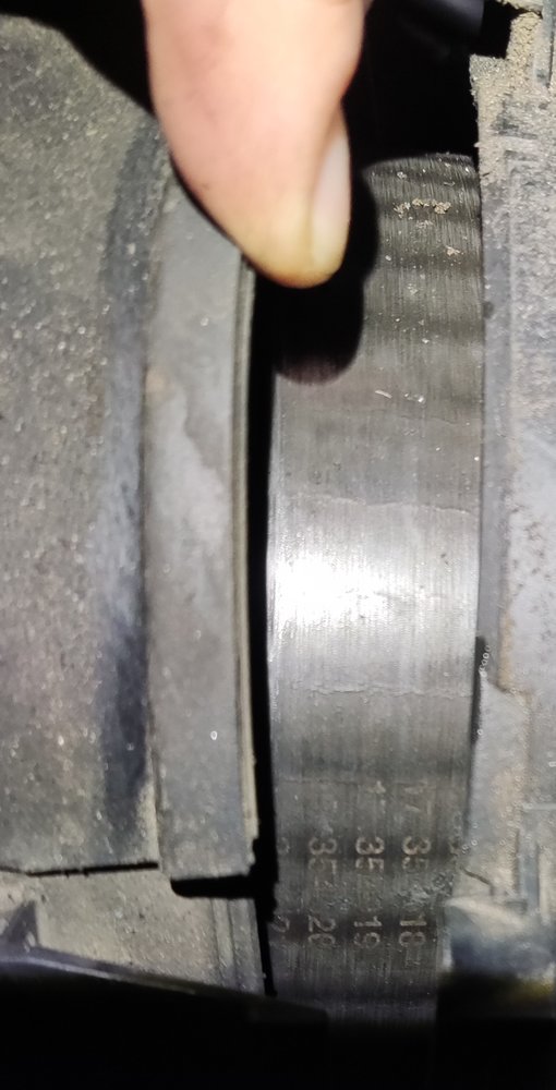

Planning to do a service on our Volvo XC90 D5 (2005) in a couple of weeks time, so buying the parts in advance.
Oil change, oil, pollen and fuel filter change, aux belt and pulleys and thought I'd check the timing belt condition...
Belt was supposedly changed at 100,000 miles according to bloke I bought the car off and the service book (recommended 108,000) so should be good condition - car now on 147,000 miles.
I bought the car on 110,000 and was thinking the belt should be fine until 200,000 miles
I'm glad I checked but was shocked to see how bad it is (I don't think it was changed when the service book says!)
Wife using the car today to and from work (everything crossed) but am going to change it this weekend now! (along with water pump and pulleys)
