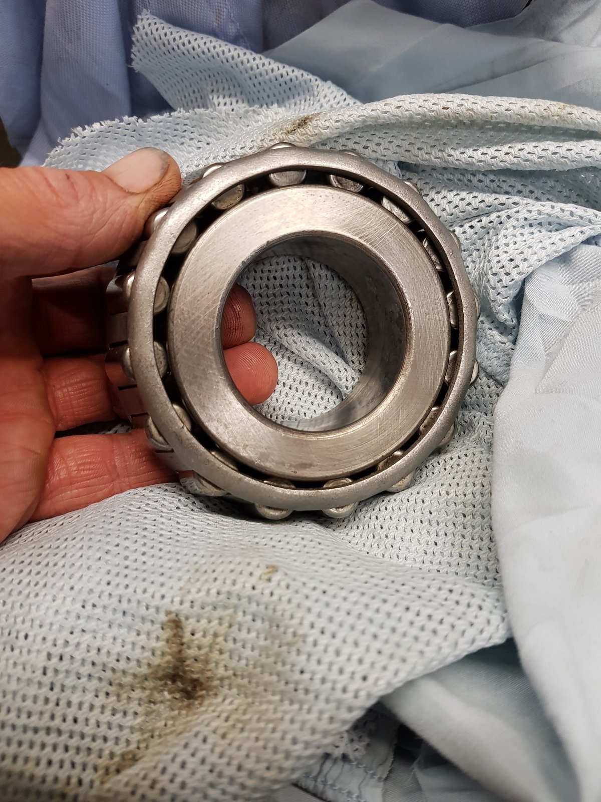

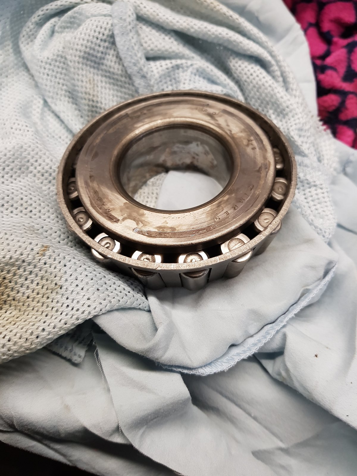

You're not going to get lathe class clearances on a landy wheel bearing.
Can't quite get where the need for precision comes in on Timken taper bearings. You set that yourself. Yes, the inside of the cone and outside of cup need some precision, but will be near enough for either lathe or wheel bearing, and the rest is up to the person shimming the bearings on assembly.
