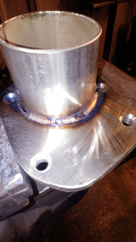

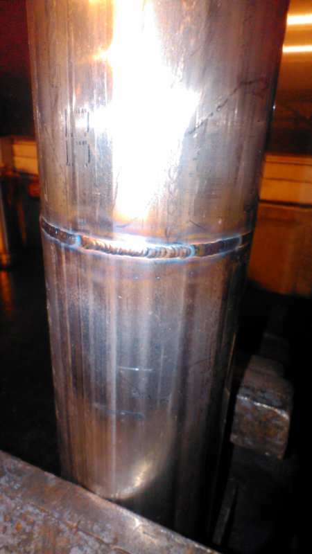

I'm the same. Doesn't matter to me what the part has got to do but if it's going into service and the weld is right through Id feed on the inside every time. I don't like coking and no matter what people say it DOSE reduce weld life.On performance gear I'd prefer to see back purged joints personally
I'd go so far as to say I'd be sending it back with none purged weldsI'm the same. Doesn't matter to me what the part has got to do but if it's going into service and the weld is right through Id feed on the inside every time. I don't like coking and no matter what people say it DOSE reduce weld life.

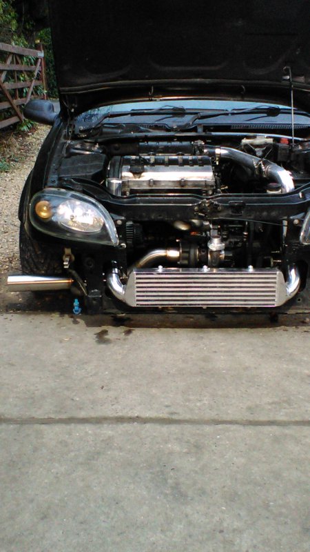

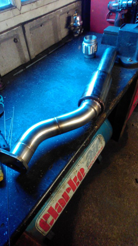

OK I gt want you mean personally I'd go for 1 5/8 its look fine in a maverick iv had and a Plymouth fury
