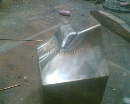

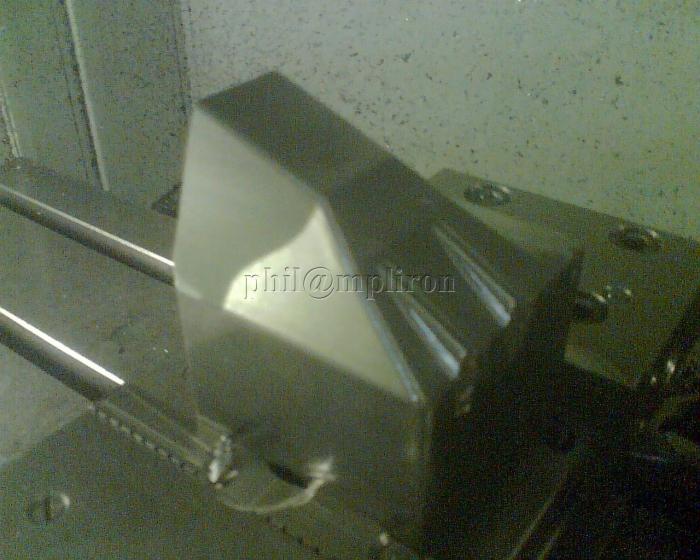

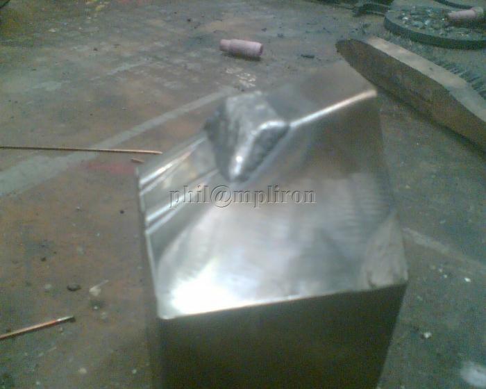

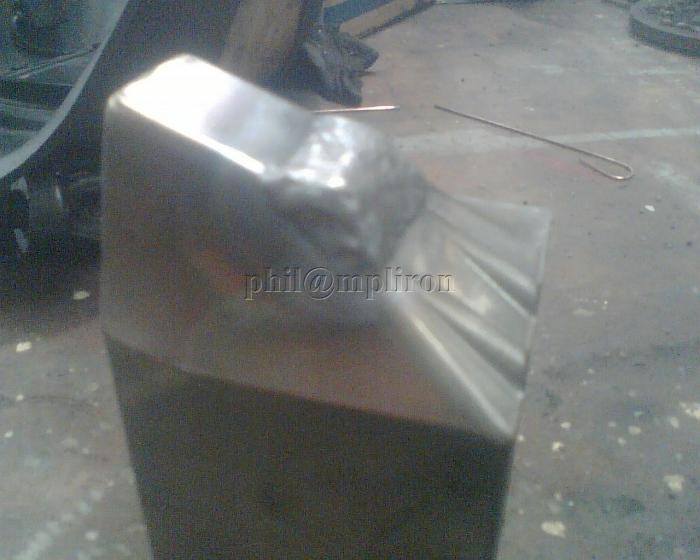

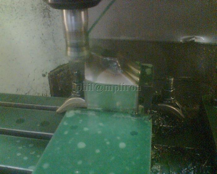

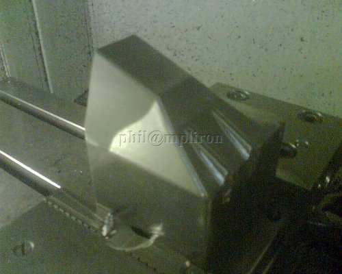

Still quite new to the forum so if you can't see my photo's sorry, thought i'd post some photo's of what i did this lunch time. I had to change the shape of a form punch on a presstool for landrover.
The punch is made from D2 tool steel, i built this up with hss rods, While i was welding my programmer changed the cad model and wrote the new CNC program, once it had cooled down we recut the form, thankfully it all cleaned up first time
The other half of the tool needed metal off so just a recut needed.
Who needs food anyway
