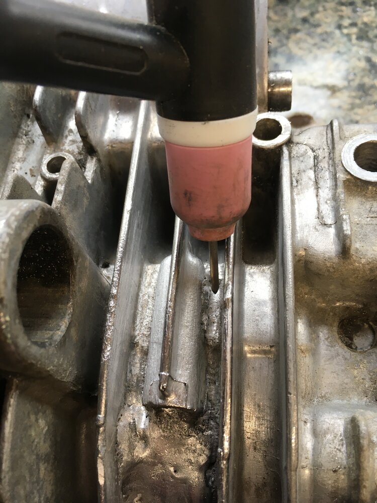

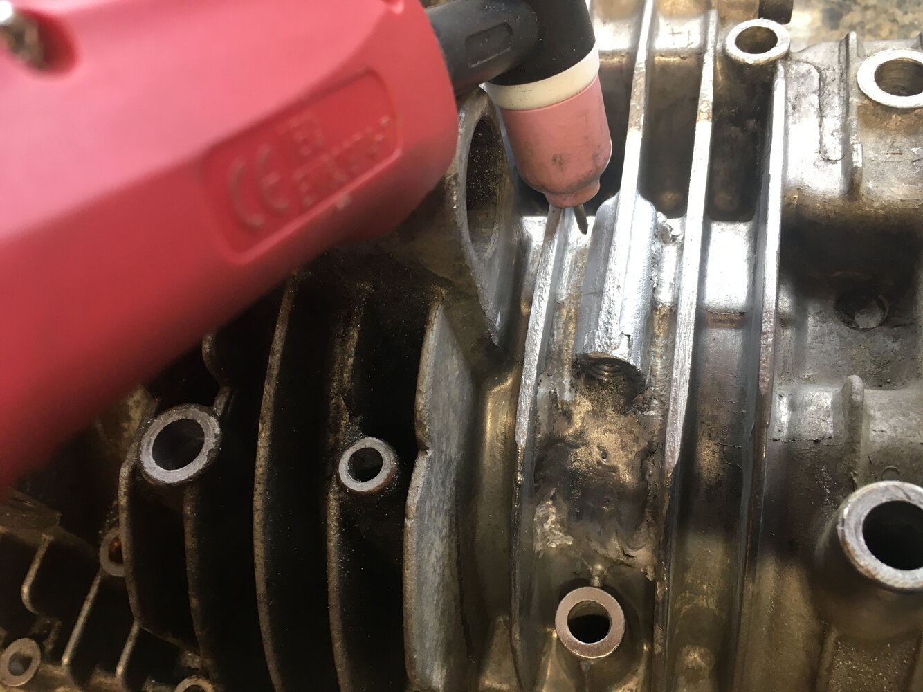

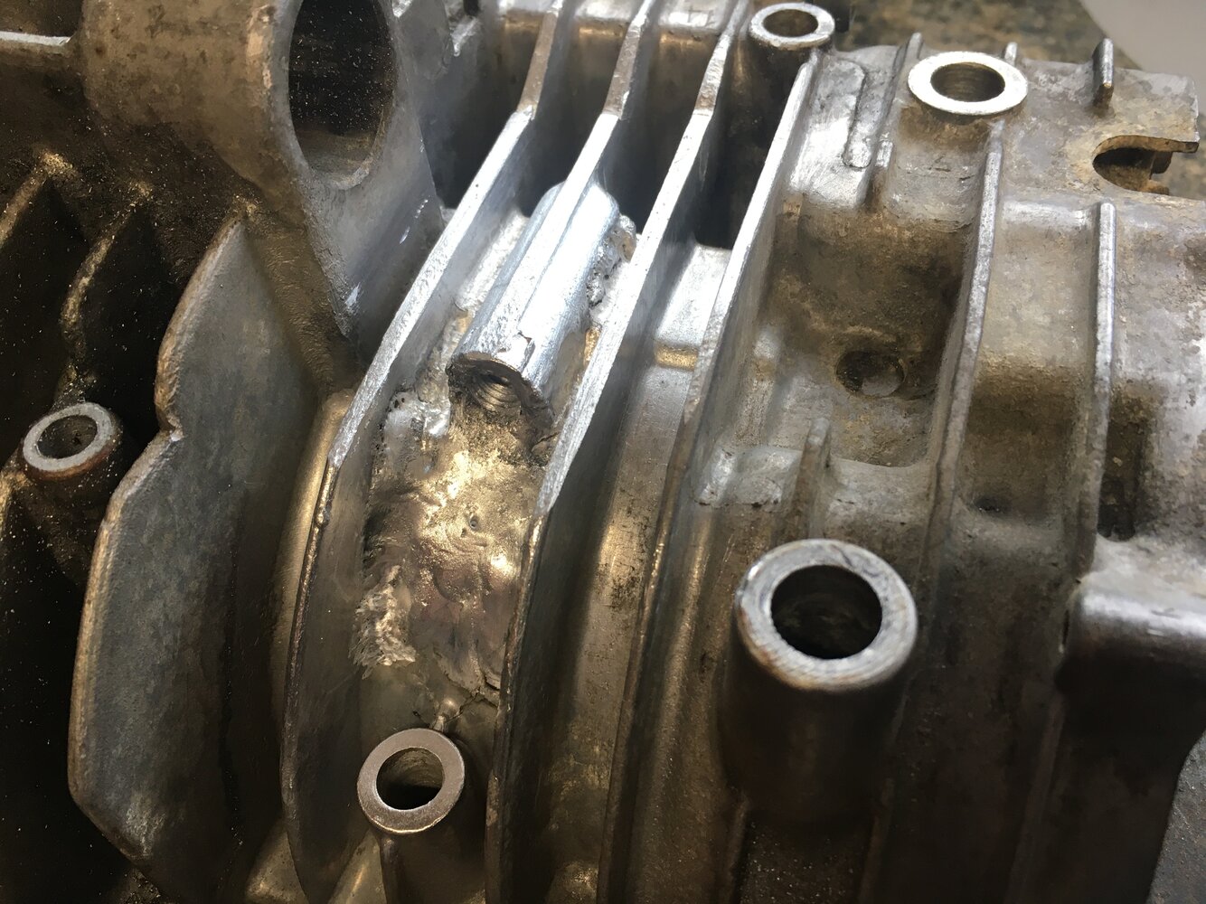

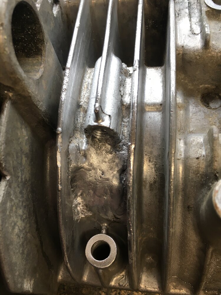

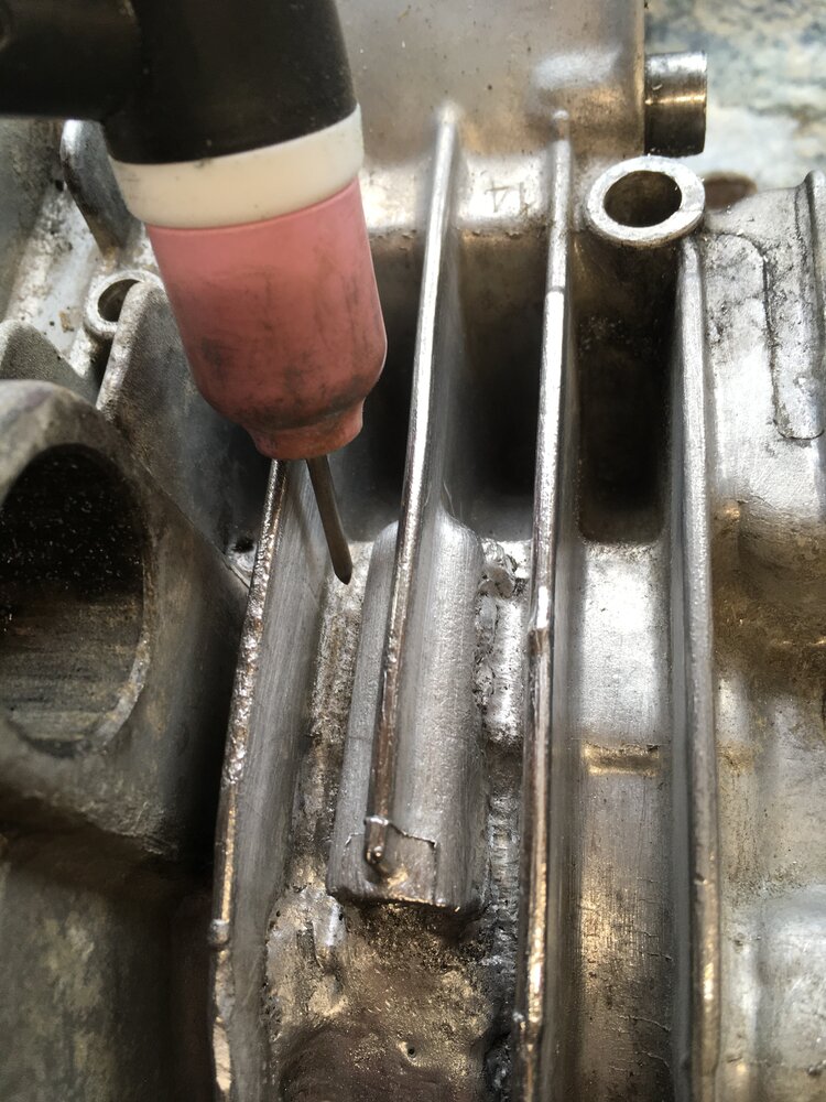

Hello everybody. Recent lurker as I’ve been teaching myself tig welding over the past couple of months with the aim of repairing an old Suzuki motorcycle crankcase which was damaged when a big end bearing let go. I’ve made a start and as expected, welding low-quality oil soaked (50 years) cast aluminium has not been easy. But I’ve made some progress. Now I’ve hit an access snag.
I need to weld both sides of the threaded boss at the base where it is cracked. Two problems. Firstly in order to get down to the crack i need to extend the tungsten, almost 1” protrusion. Being a learner this is not ideal. Also when i strike up an arc it is reluctant to go where i need it. It is attracted to the walls of the boss or the walls of the cooling fins. Ideally iwant it to strike the bottom of the trough so i can build up weld between the boss and fins.
Any thoughts or suggestions? Regards. Chris
