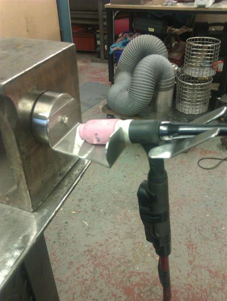

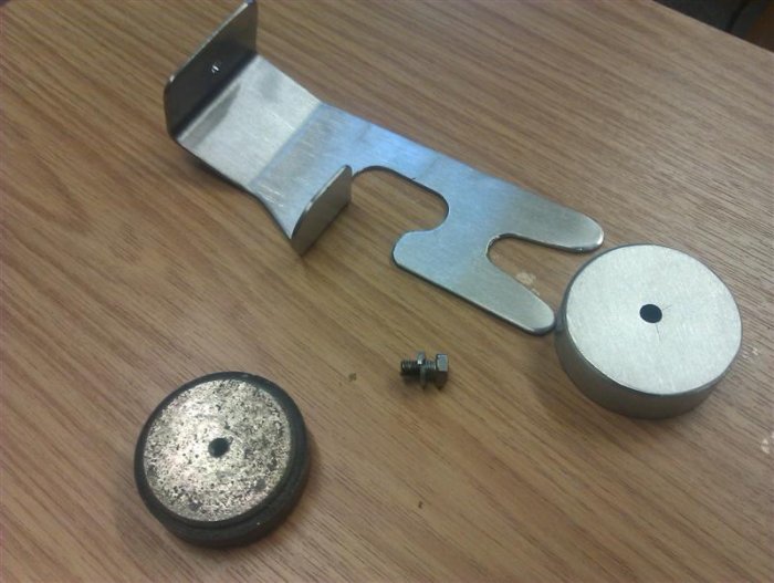

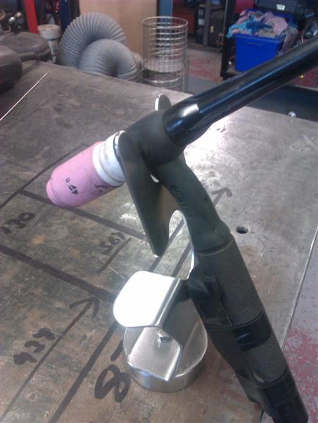

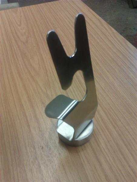

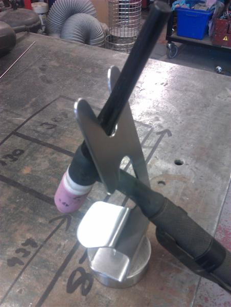

After dropping the tig torch for the upteenth time on the job I'm presently on I decided to make a magnetic torch hook,
So a magnet from an old speaker with an M6 hole tapped through the steel core, its a bit scabby so a knocked up a cover from a piece of tube and a disc, it will also protect the brittle magnet from knocks, 6mm bolt holds it all together.
hook is made from 2mm stainless sheet.
