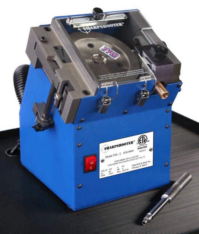

as i now enter the world of tig...a whole host of new stuff awaits....like this pic of a bench mounted tungsten grinder....nice....almost as expensive as the tig machine......i want one!!!!
i made a jig for.my bench grinder. Just a bit of tube cut off at whatever angle you want the tungsten sharpened too, then a bit of flat bar welded on so it sits square on the grinder rest. Put tungeten in, twist as you grind and job done
