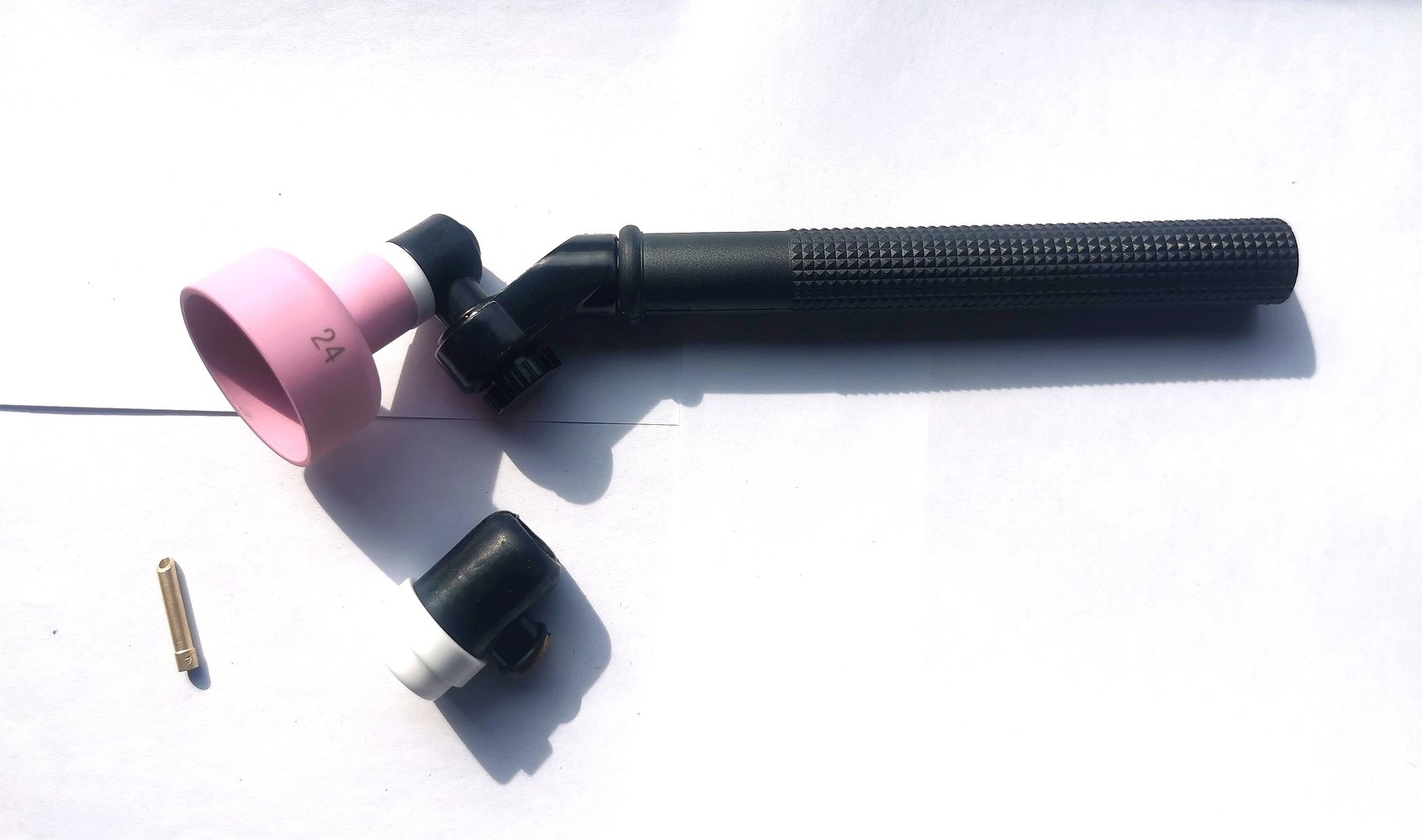

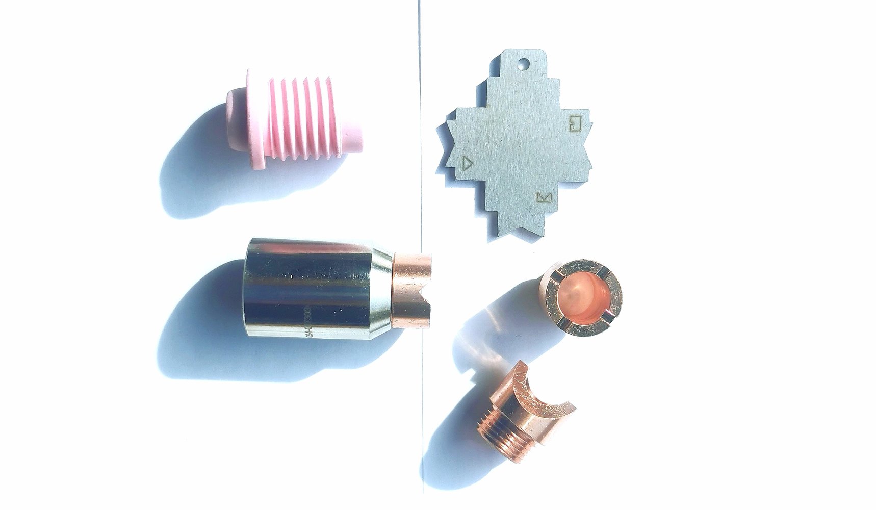

I used to have such a set for spot welding of thin stainless steel (up to 1 mm) with an overlap. I dropped the nozzle on the floor and the ceramics broke. And here comes the new set. There is a lot of work ahead of him.
Does anyone know where you can buy a separate ceramic insert?? Buying a complete set every time is not fun.
It is a pity that my welding machine does not have a program SPOT mode, but I have trained myself to give a short pulse with the button.

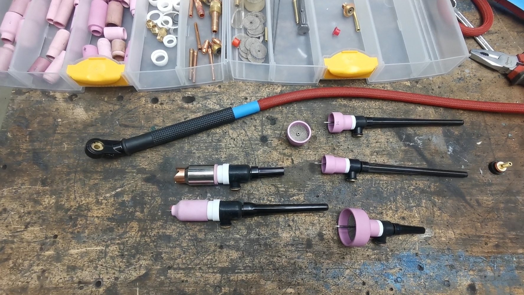

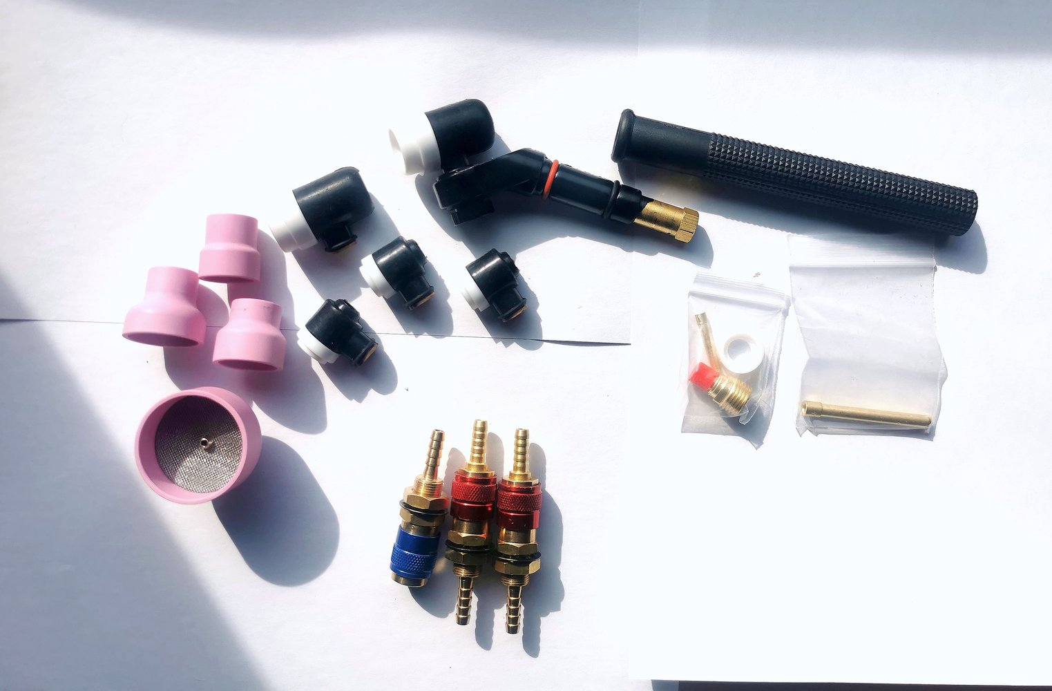

also decided to upgrade my homemade torches with a super soft cable (similar to CK).
According to the principle - one handle, and ready-made heads with different electrodes and cups are put on it (head #9 and #26).
Of the pleasant things - fast connectors of small diameter (~ 6 mm).
