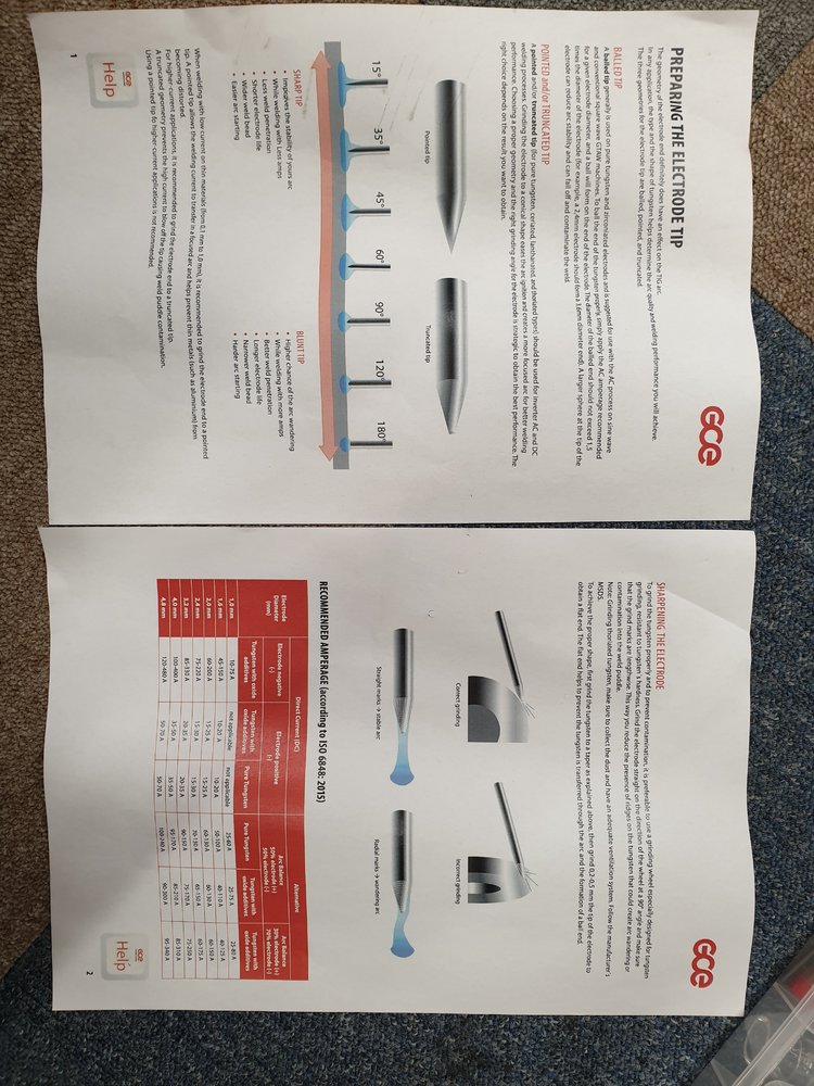

just ran a few practice beads this weekend on my SWP DigiArc 160A invertor. I am running 1.6mm 2% Thor.
Seem to be struggling to keep the tungsten sharp and I don't appear to have my scrap metal clean enough. What is an optimal mild steel thickness for practice runs? TIA
