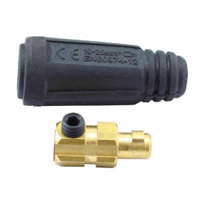

P PSweeney Member Messages 265 Sep 27, 2017 #1 Hi the heavy power wire going into the DINZE plug on my TIG torch has come loose. The plug looks to be moulded, are these replaceable ?

500e Always buy fire insurance a flood is a hard start Messages 9,373 Location South West Sep 27, 2017 #2 Normally they have Allen screws the rubber shroud is very tight
gordon stephenson Member Messages 7,468 Location Skelton in Cleveland U.K. Sep 27, 2017 #3 As above, illustration is miss leading, the brass connector faces the other way, But as said, the rubber shroud is tight,

pedrobedro Man at Matalan Messages 13,106 Location CX near Chesterfield Sep 27, 2017 #4 Before you install the cable into the Dinze plug put some 8mm copper tube round it and beat it flat for the grub screw to bite on. Stops it fraying so quickly and coming loose again.
