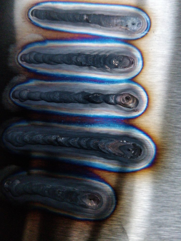

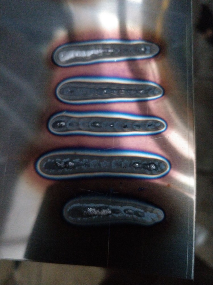

Right, managed to find some time to get back to this, I've done a few more runs with the test piece clamped down to a big chunk of 16mm Alu
I've been leaving a couple of minutes between runs to allow heat to dissipate

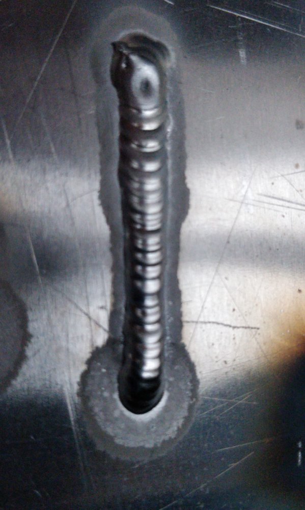

Rear
One of the things I noticed was the 1.6mm filler was also discoloured

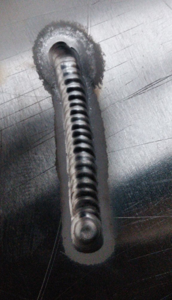

Now, I thought I'd have a bit of a play with some old test pieces to try a lap joint - first try so it's a bit rubbish, but it isn't black
Which suggests to me that I'm putting too many amps in - so I measured, rather than guesstimated the material thickness, what I thought was 2mm is actually 1.5mm and the 1.5mm is actually 1.0mm
Rather than scaling down, I'm going to get hold of some thicker stainless for practice - an old phrase that I try to apply at work, It looks like I should have used here - 'never assume, always check'.
