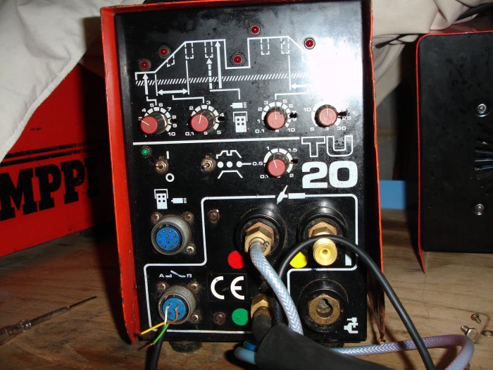

Just one question, (at the moment) that photo, above.
Bottom left switch/terminal/thingy/thing/what ever it is.
WHY has it got wires sticking out of it. It looks completely wrong, but i've
seen this several times, on various units, shirly they could've been put inside the unit. (and a switch put there to do (whatever) the...you know what i mean) i hope..

The item at bottom left is a 4-pin socket, probably to connect to a switch on the torch. Looks like someone has bodged the connection, due to not having the matching plug, by pushing wires into the socket holes.
