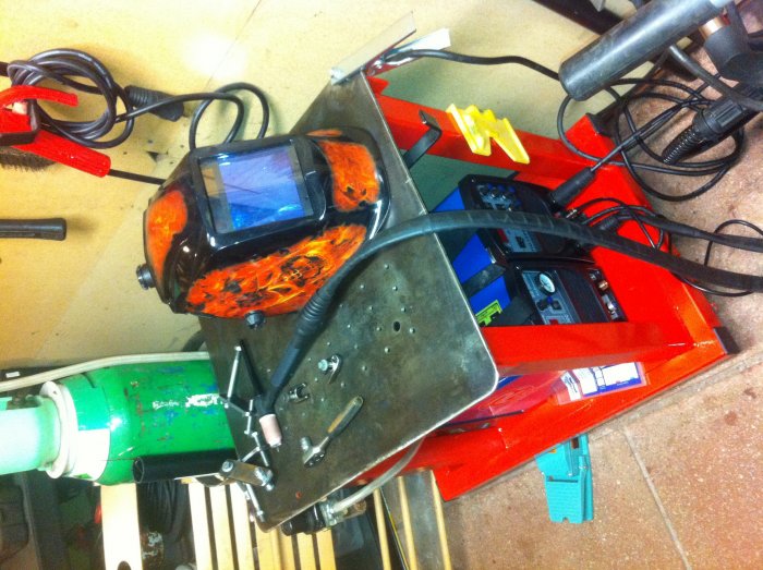

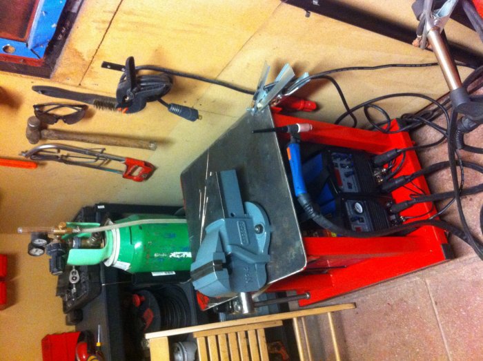

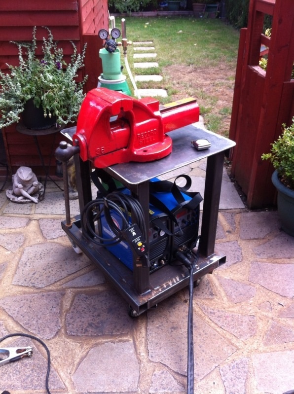

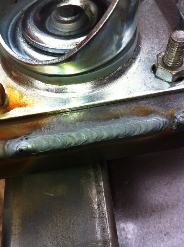

Since moving out of my garage I've had to downsize my welding table as space is very limited in the shed.

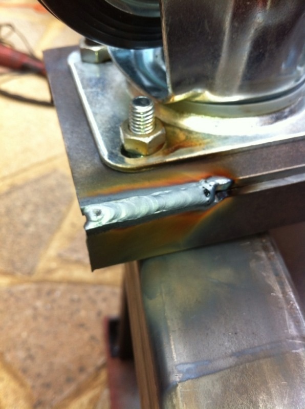

I'm using just what's to hand other than the front two casters.

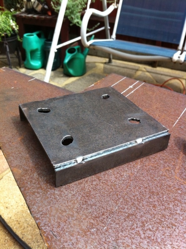

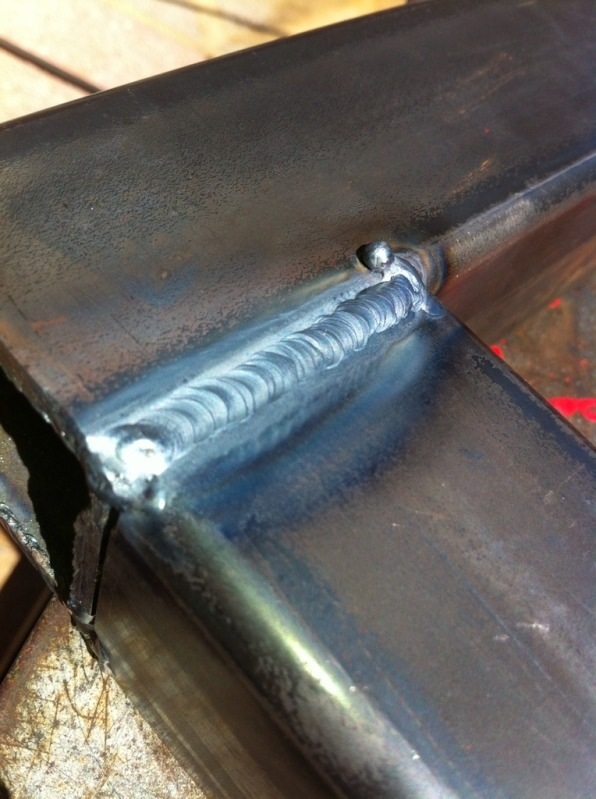

I've mainly used tig as I really need the practise, couple of bits I migged just to save a little time when I started to rain and had to pack up.

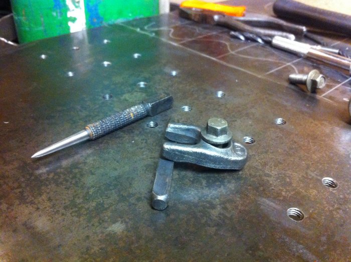

Left to do is strapping the bottle on and adding more hooks for the leads, thinking of adding some rod holders too.
Also the top will have some captive nuts for the vice to bolt to when needed.
