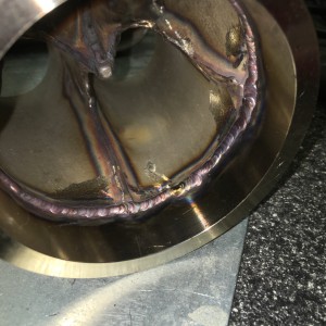

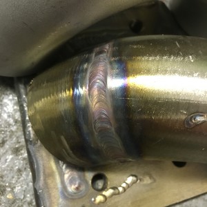

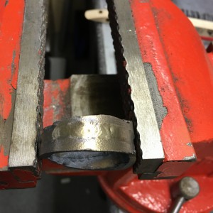

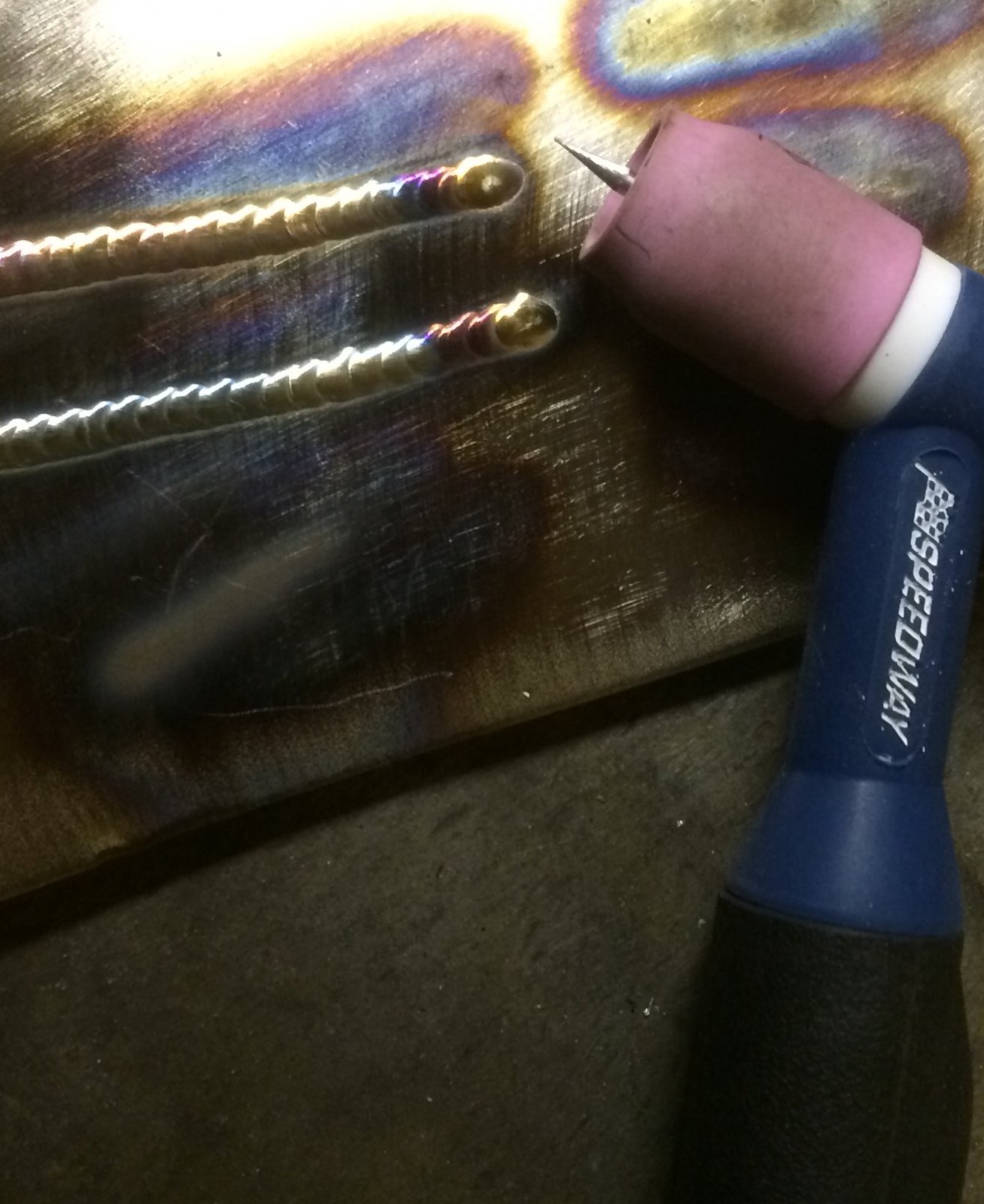

Hi All,
I've just purchased my first TIG machine. I'm planning to build a turbo manifold and do some exhaust work.
I have done a small amount of TIG welding back when I did my apprenticeship but that was some 10 years ago now but I've done a lot of MIG in recent years.
Been practicing on some off cuts but I have some questions on how to tackle the actual welding.
The pipe is 1.5" Sch10 with a 2.7mm wall thickness 304L.
Firstly, I'm getting a small amount of grey film form on the weld. I'm guessing this is a bit of overheating due to the size of the off cuts. Ive tried to turn the amps down and added a bit of pulse to keep the heat input minimum but I still get it a bit. Will this be a problem when I weld the larger pieces. Or will they dissipate the heat better?
The next thing I need to know is if should do this in one pass. Or fuse the root then cap. I've done the above with no filler just fusing, will I even need filler?
Any help much appreciated!
Thanks
Tom
