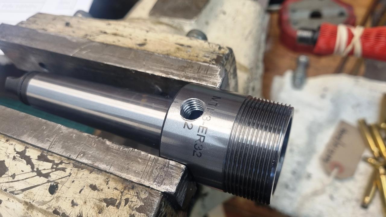

Finding myself with a good few through coolant bits I thought it would be a good idea for me to actually use them for the purpose designed. I forget who but there is a very good youtube video out there about making a through coolant retaining bolt for the Mill. Most of my deep hole drilling and trials and tribulations happen on the lathe so I thought I would stick with that.

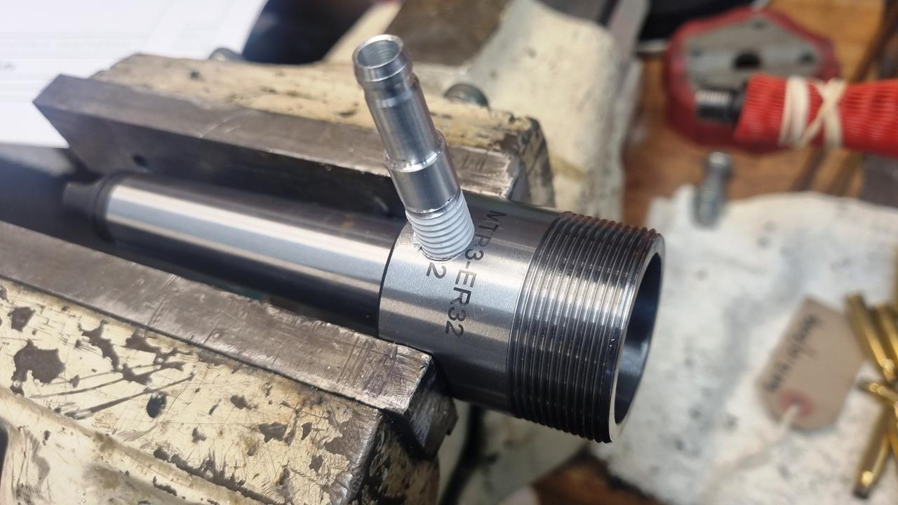

First up was the purchase of a suitable ER32 3MT arbour. Then a tang insert from ARC Eurotrade: https://www.arceurotrade.co.uk/Catalogue/Chucks/Drill-Chuck-Arbors/Screw-In-Tangs so then to modify it to take a spigot I had turned up earlier:
After I had fitted the spigot I found it intruded a little into the back of the Collett housing so I cleaned it out with the die grinder, turned out fine:

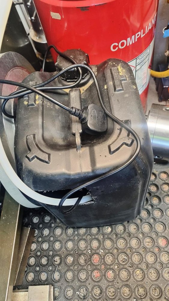

But then I needed a resevoir a return tank and associated pipework. The simple answer is a 20 L drum a hole cut in the side and a small (cheap) pond pump:

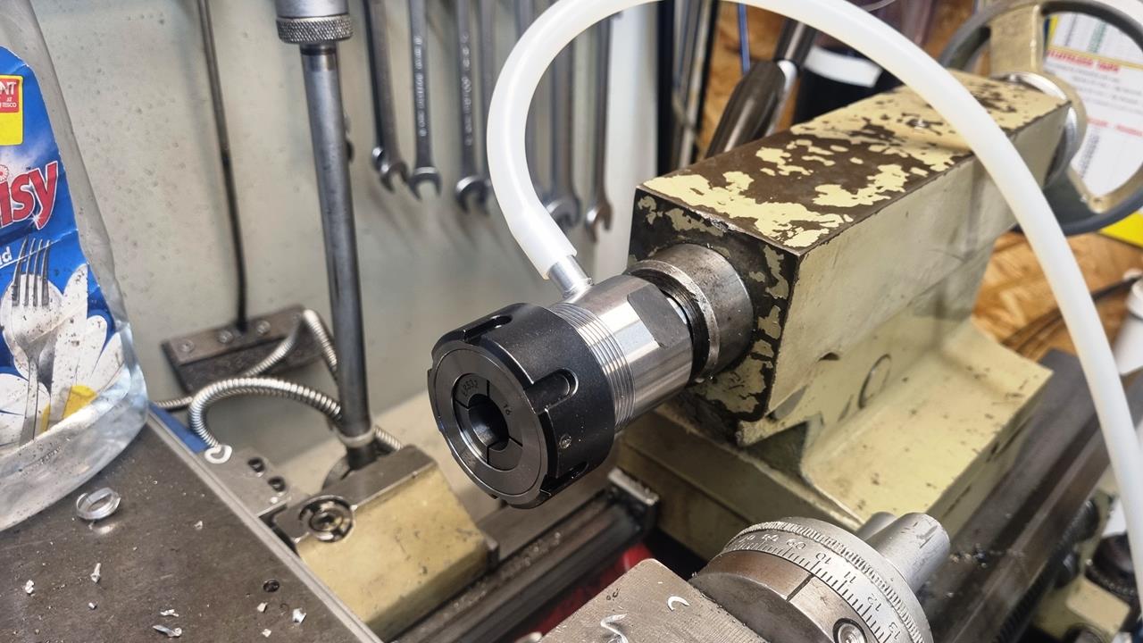

Feed and return in silicone tube. This is how it looks all fitted up:
All ready to go. The Colletts of course are Coolant rated so they don't squirt coolant everywhere and it goes down the tooling. I have made a small catch tank to return the coolant to the "reservoir". I am very hopeful this enables me to cut stainless and titanium with less hassle, we will see.
