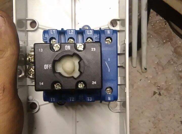

I picked up a motor at a boot sale which had a switch unit and a plug fitted, seller was all "it's ready to go, I wired it all up fine" - yeah, ok, it was cheap enough, soooooo...
He'd used a 3 phase switch and put live to L1, neutral to L2 and EARTH to L3.
Do not switch your earth!
