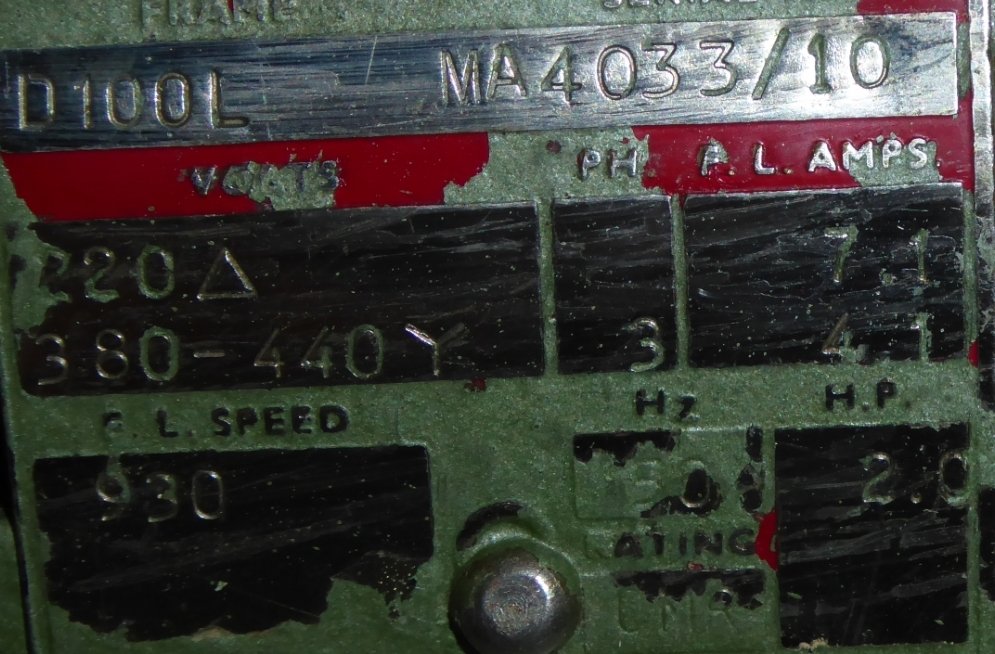

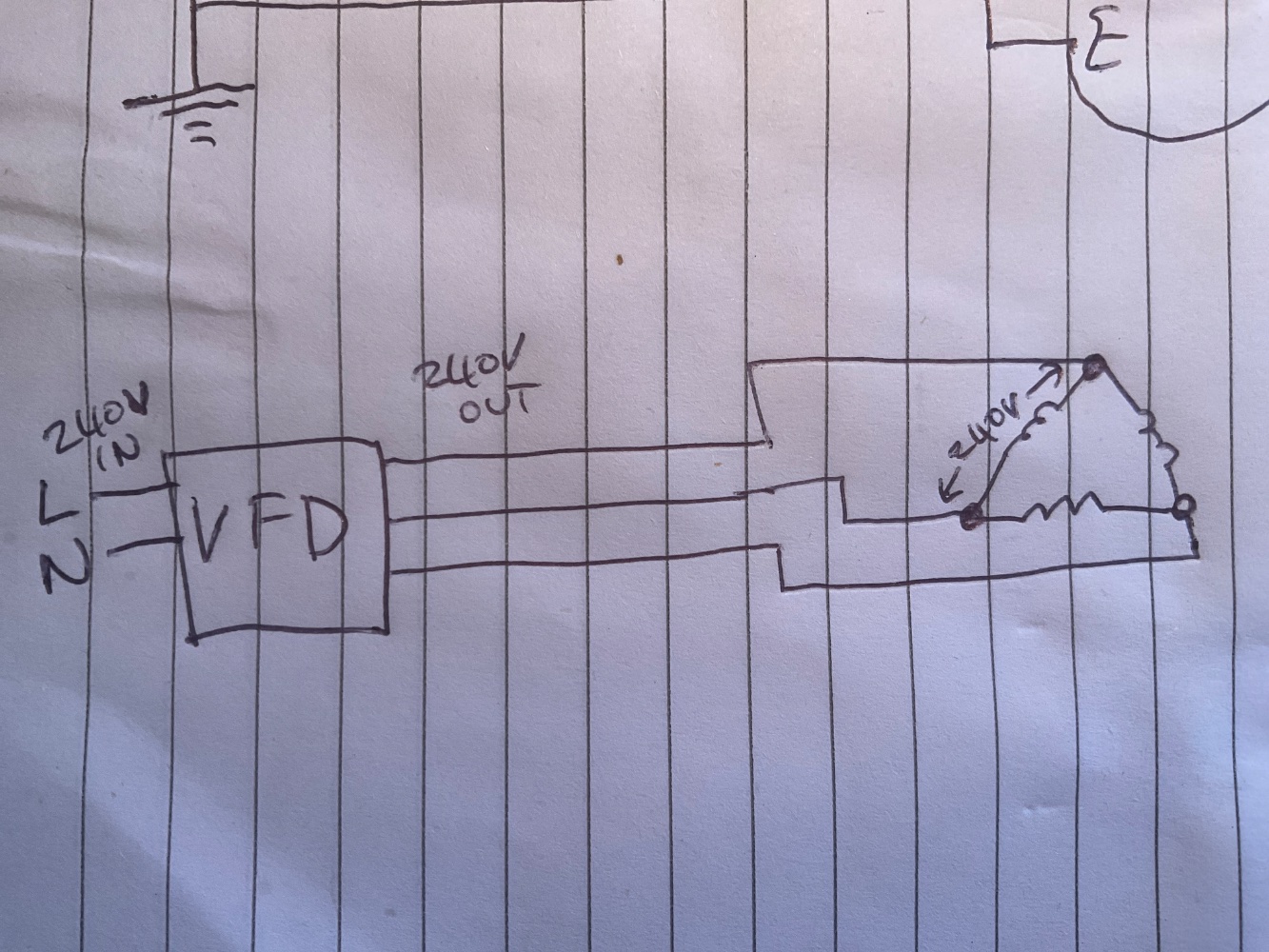

Wiring a 3 phase motor for VFD is generally very straightforward.
Check the data plate on the motor says 240V in Delta
Set the motor into delta configuration
Wire the 3 outputs on the VFD to the 3 motor terminals
Wire a plug into the VFD
Add a run switch, and speed pot if you like.
It's fiddling with the parameters that takes a bit of doing but you really only need a few of them to be correct for basic functions. The better units have auto-tune which will configure the motor parameters for you but even if you don't do that it will be easy to get it running at least somewhat.
