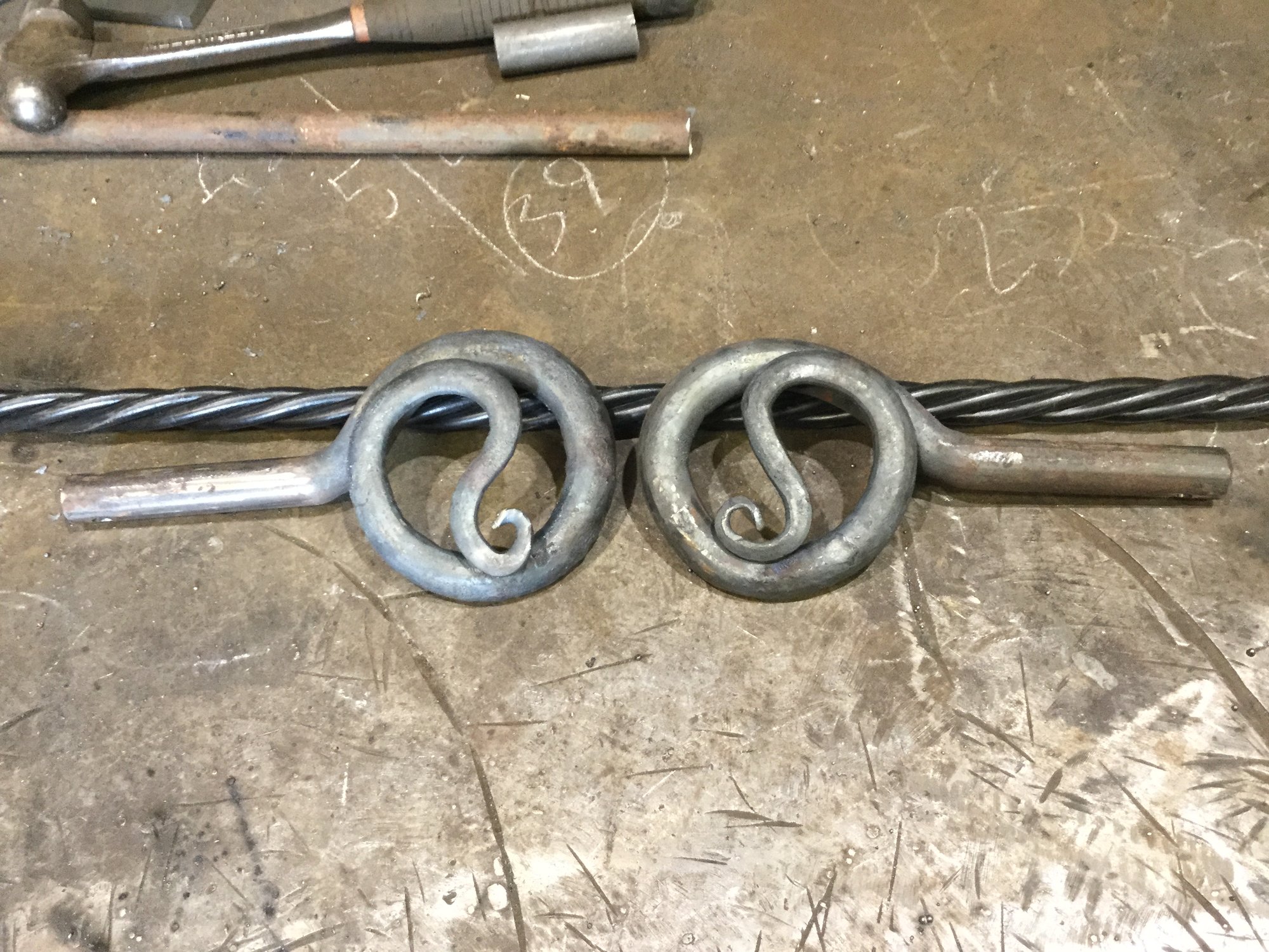

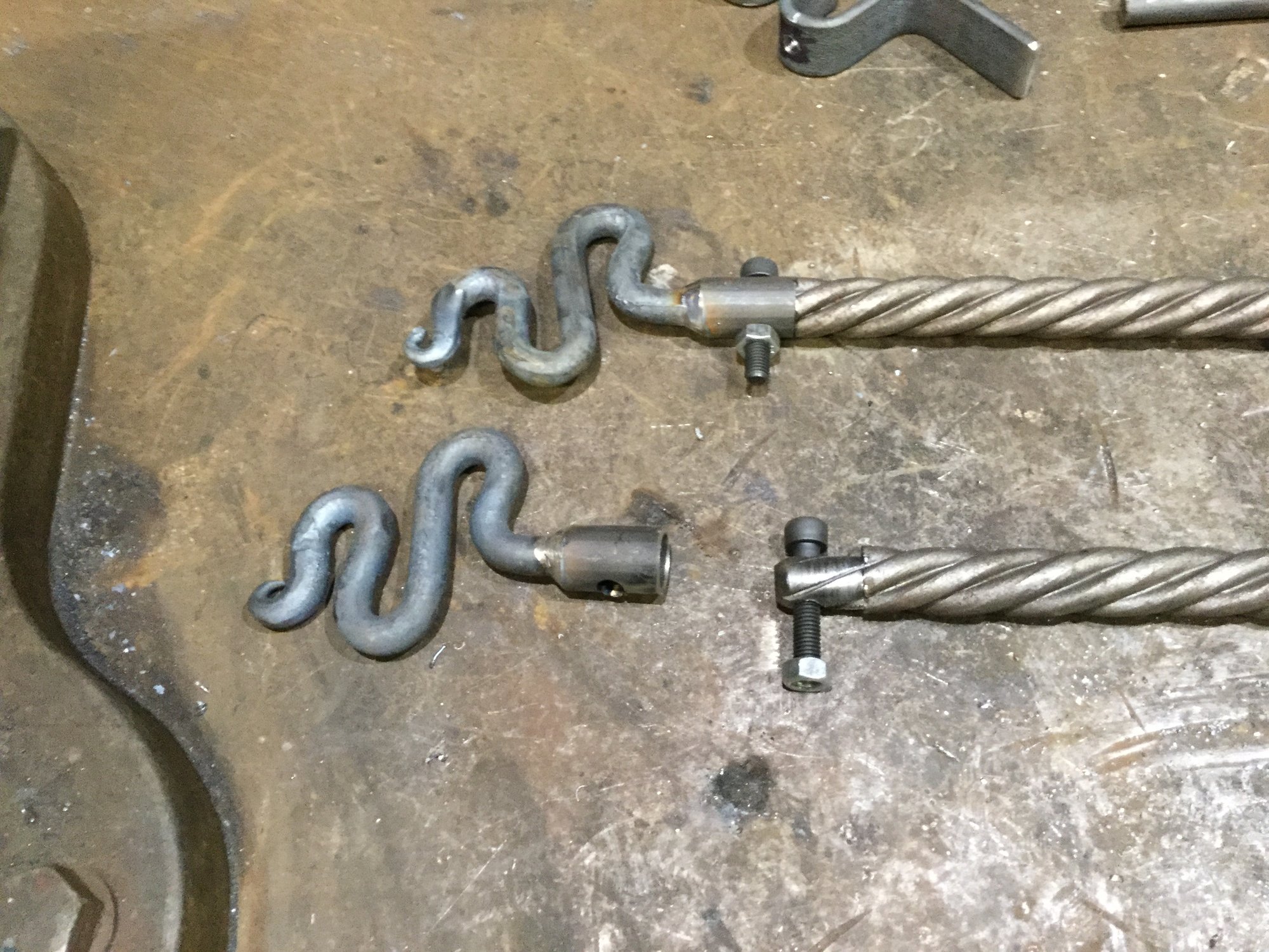

Hi folks, I have one of my least favourite jobs coming up...curved curtain poles for an oast house. To give clients the ability to add/remove curtain rings I usually roll them from hollow tube and socket the finials into the ends, then drill the tube and tap a thread so a grub screw can be tightened up against the finial tenon to keep it locked in.
Ideally I'd use 20mm x 2mm wall tube but I've had no joy before with threading the 2mm wall as the thread just strips as I tighten up the screw, I've tried with 3mm, 4mm and 6mm screws. I have however managed to thread 21.3 x 3mm wall tube before, but I'd prefer to use 20mm O/D tube. Part of the reason being is so I can use 20mm solid bar to forge the finials from, and then the shoulder of the tenon would flow seemlessly into the tube diameter. I'm aware that there's 22mm diameter solid bar which would flow well against 21.3mm tube, but I'd rather stick with 20mm and 20mm.
Can anyone offer any tips or tricks for threading the 2mm wall tube? I don't want to weld nuts onto the back face of the tube. Sometimes I overlook answers that are staring me in the face! The only thing that's springing to mind at the minute is to drill all the way through the tube and thread the tenon and switch from grub screws to a pan head slotted screw - but that's becoming a bit of a faff.
