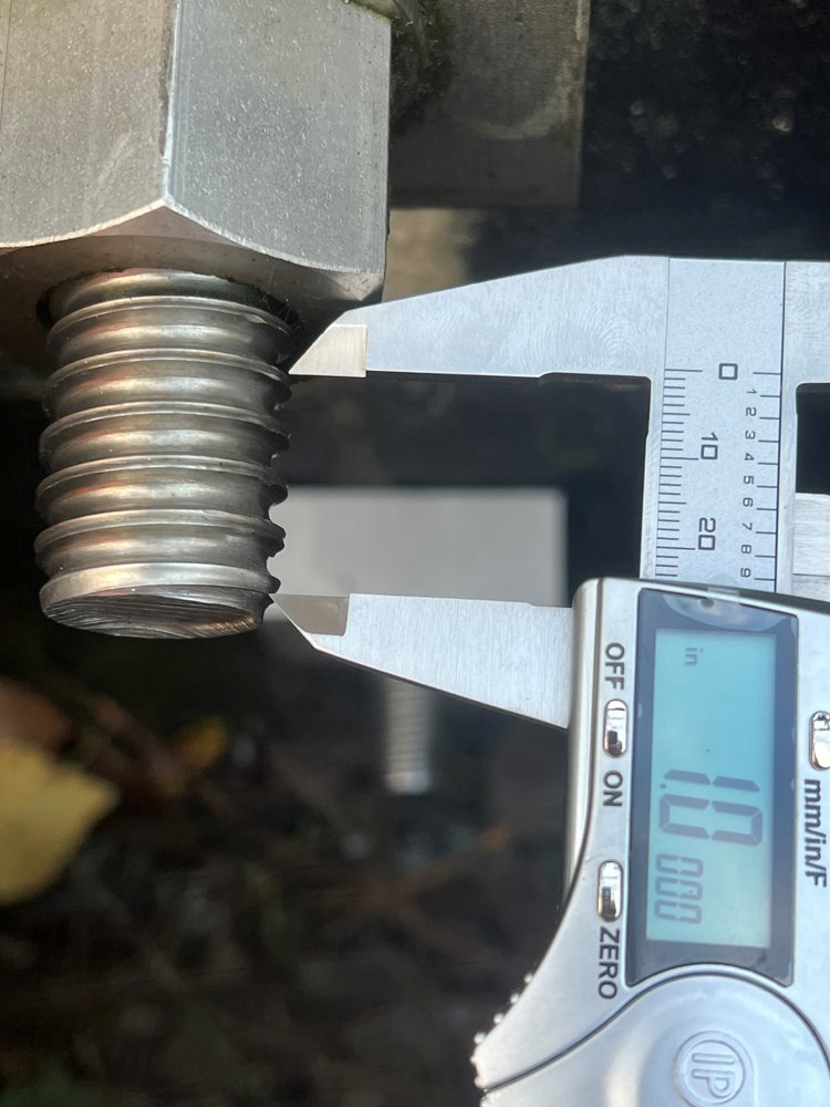

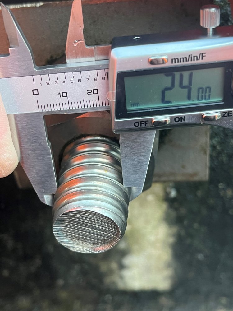

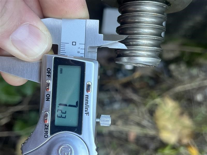

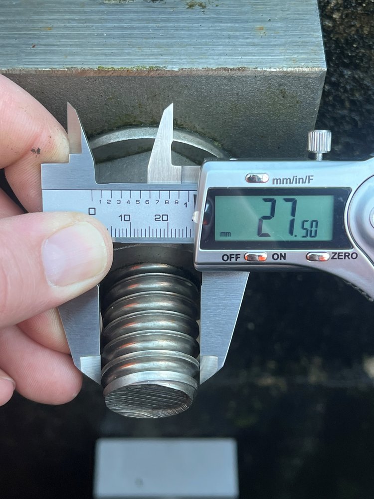

I noticed in the Op's photo, the end was simply sawed off, and the tread rolling process rolledThat looks awfully similar!
I have attached some pictures if this help

Actually, I think that's a macalloy bar in the pic.
