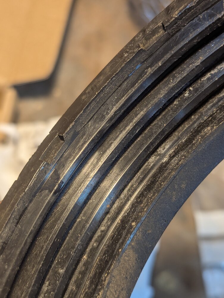

Hello all, currently in the process of adding an internal pump / swirlpot to an alloy fuel tank (60's) car.
I've opted to use a 90's range rover assembly which drops in from the top and is clamped by means of a female screw down ring.
In an ideal world I'd like to make a 'receiver' to be welded into the top of the tank with a male thread, which will take the female 'nut/ring:
I'm trying to work out the thread form of the female ring, which is what I need help with

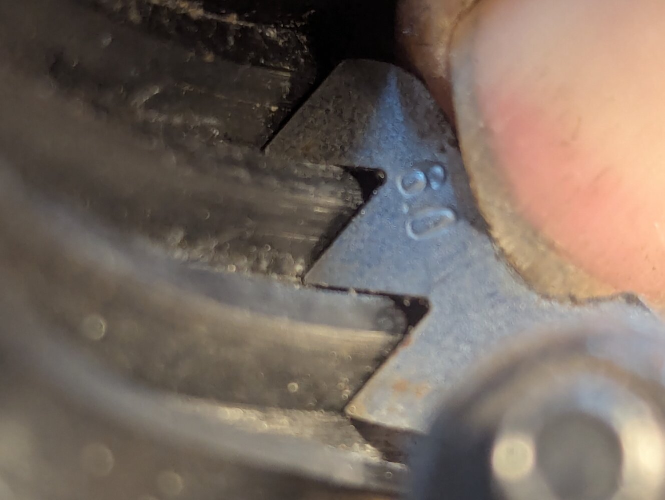

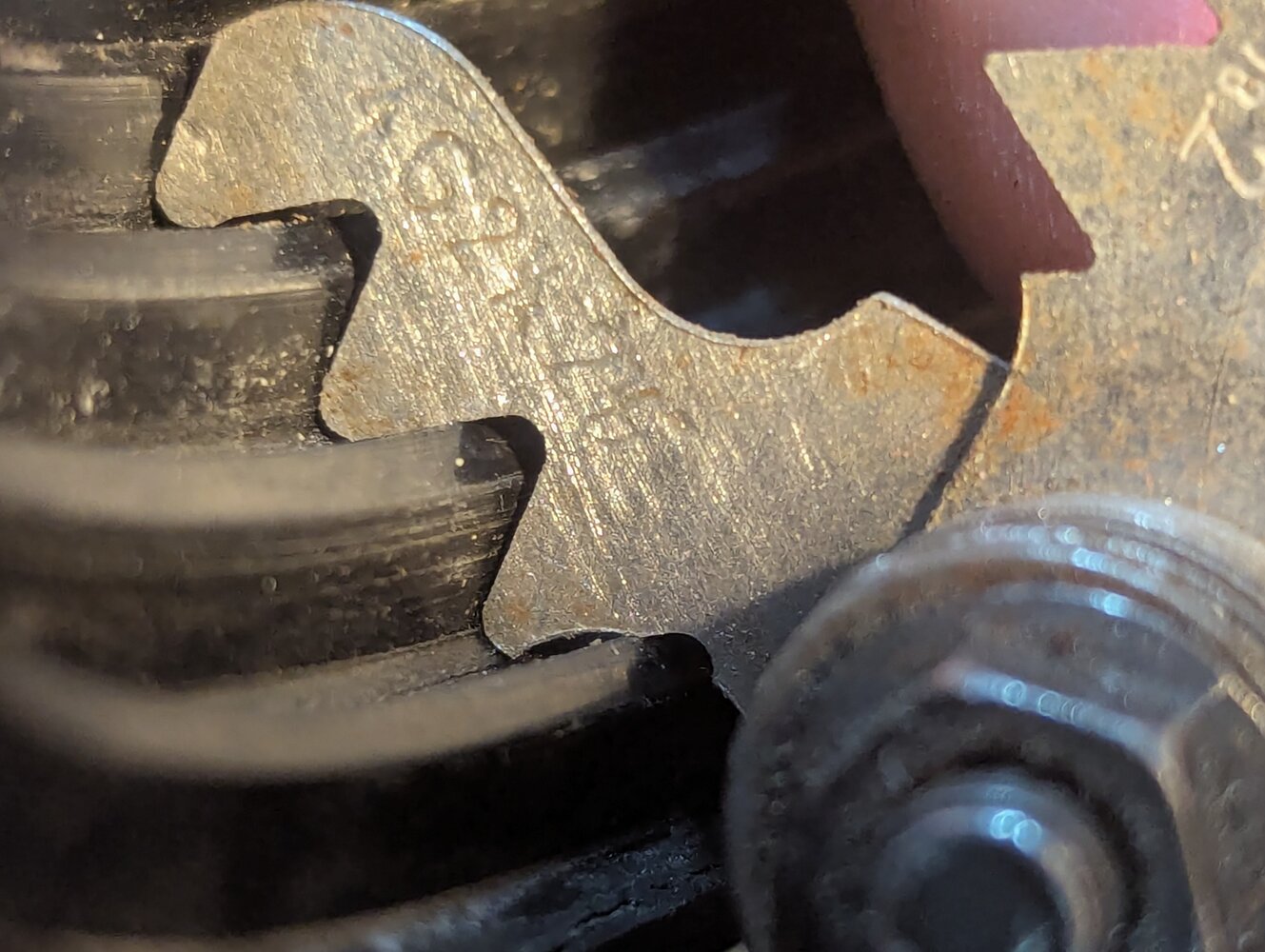

They look a bit Acme with flat peaks and troughs, a 6mm pitch gauge seems to match, as does another which is labeled '4G 2 1/4. 2 1/2'

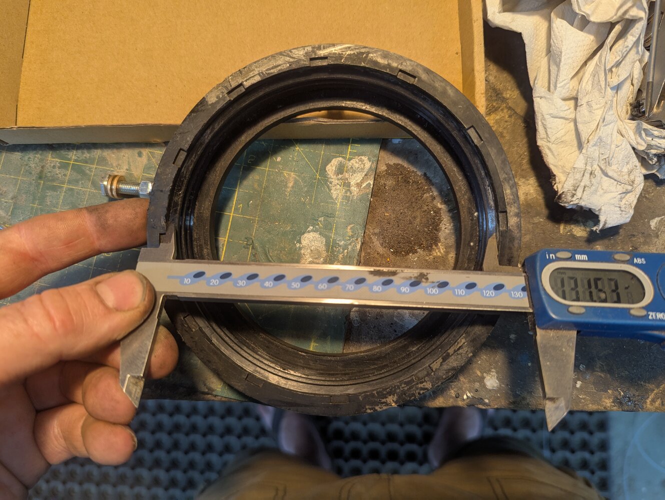

Major diameter is around 131.5mm or 5.175"
Any ideas please?
