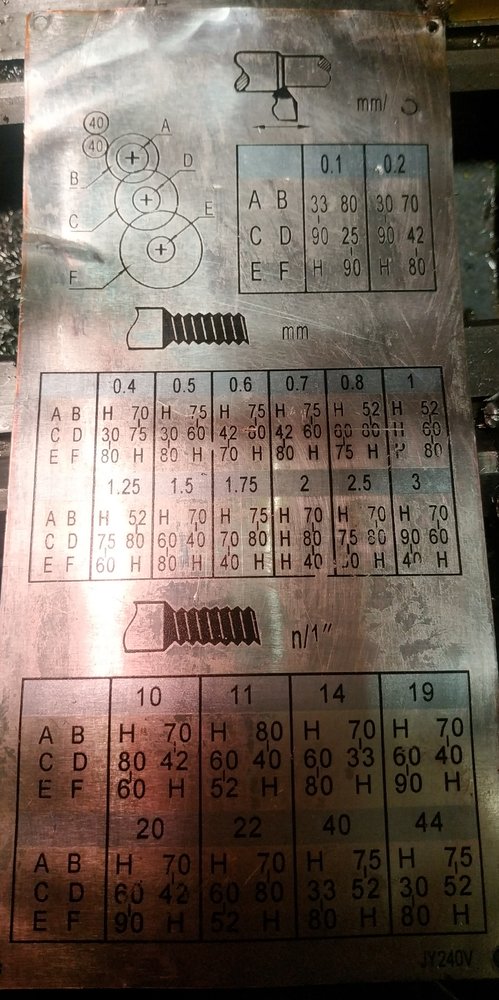

Just about to cut a thread but the pitch is not on the diagram
Could anyone help me work out what I need for 0.75mm pitch?
Based on 0.5mm example, a 45 tooth gear could replace C but I dont have one.
I will buy some extras, but can it be done with the ones I have?
Could anyone help me work out what I need for 0.75mm pitch?Based on 0.5mm example, a 45 tooth gear could replace C but I dont have one.

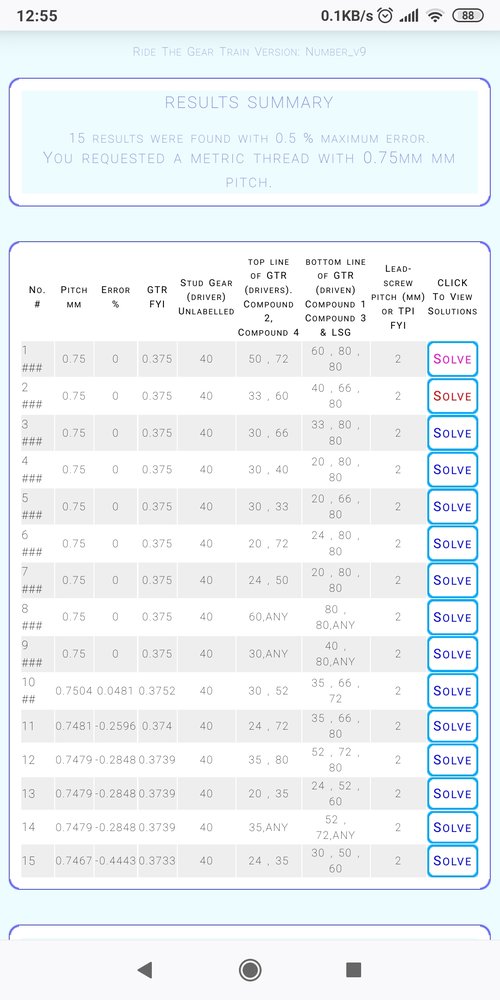

It'll be easier to edit that than go though all the menu pages. Plus, I didnt see a page to enter my gears but the url will let me. A few of the defaults dont match mine.
