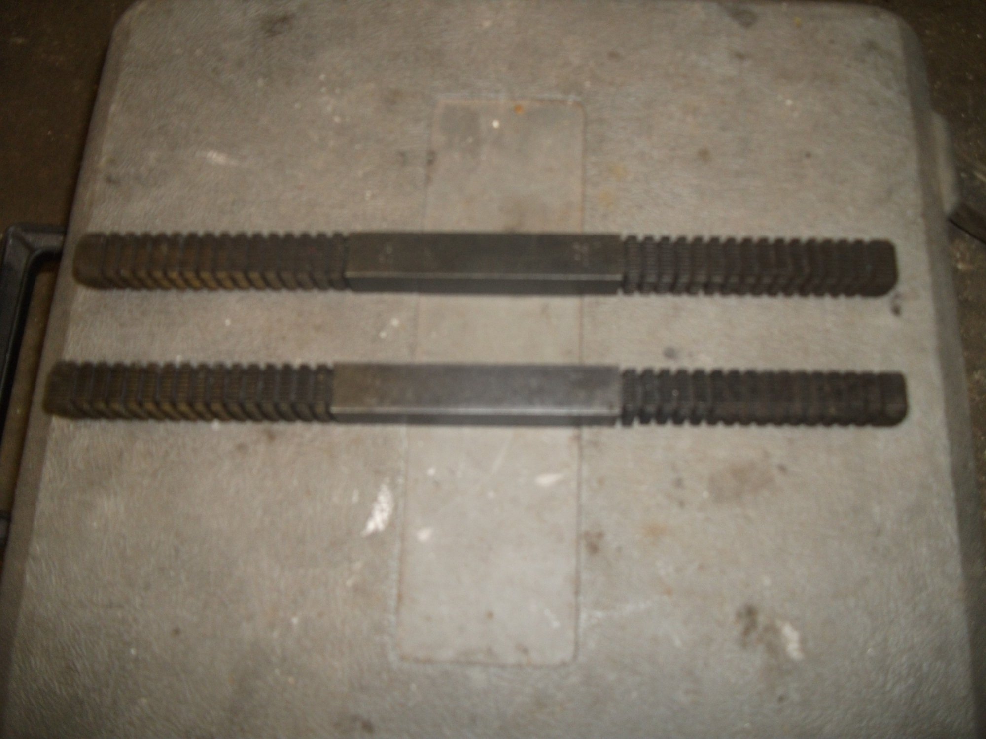

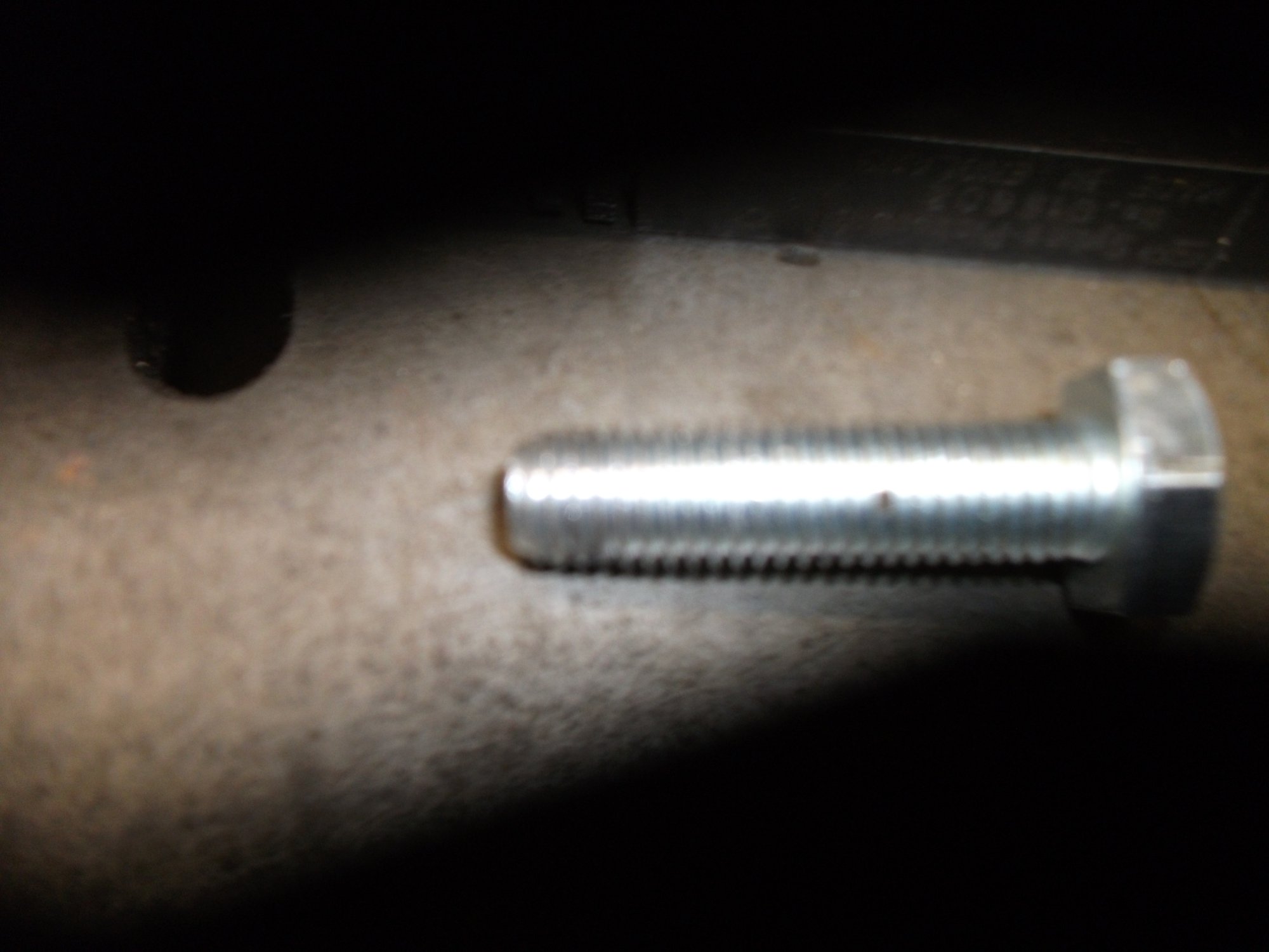

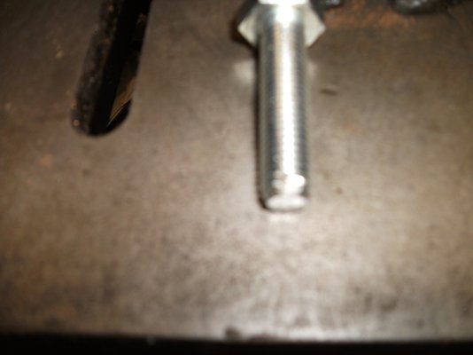

not used very often but invaluable when u do use . simply chose the right thread pitch and file across the damaged thread end. theres about 8 v in the file so as it goes across 6 good threads it does not run off on the damaged thread . 1st pic restored 3d pic damaged with big hammer
. Only needed it once to repair the thread on a big bearing puller (Also a Sykes by coincidence
