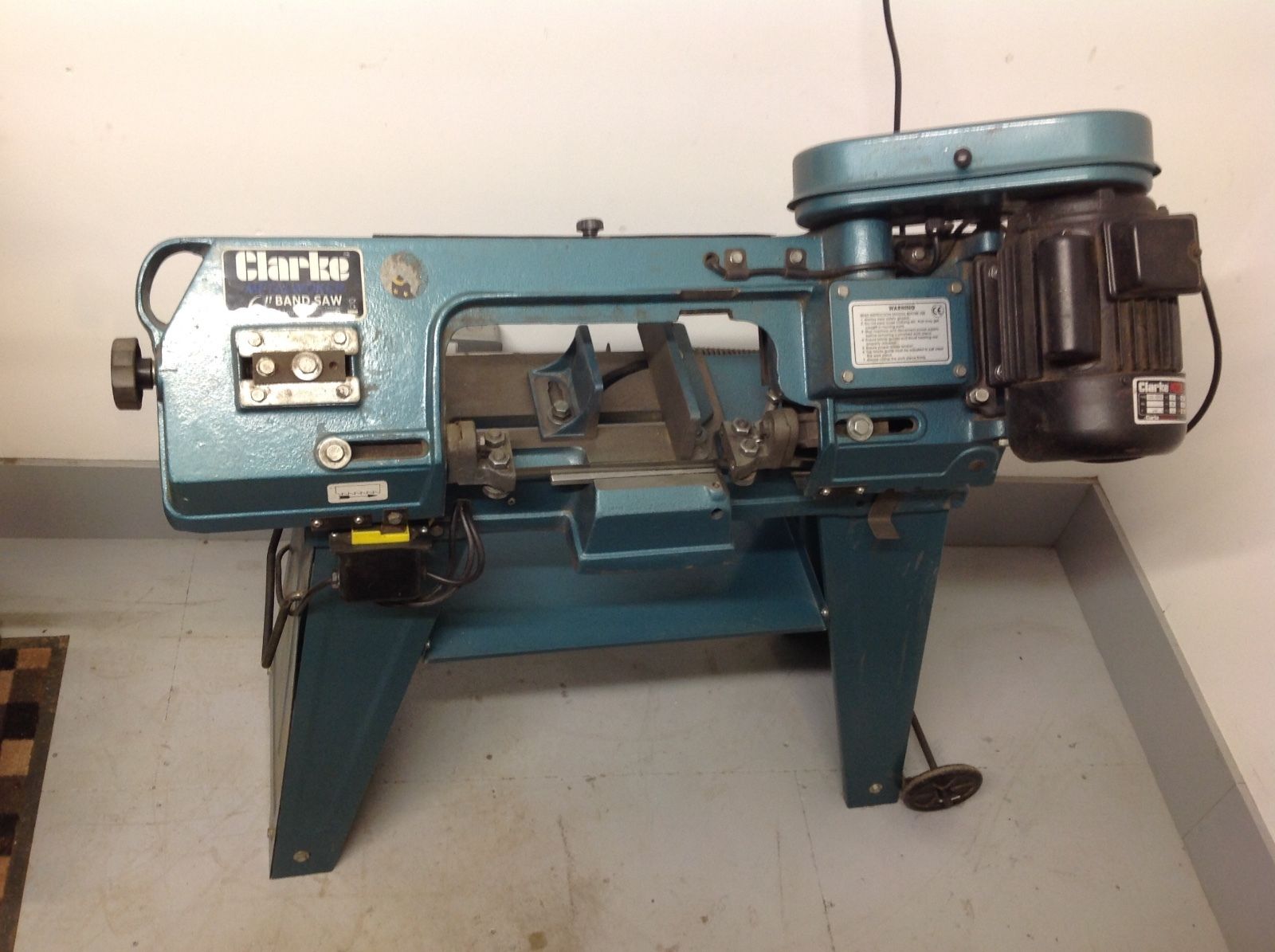

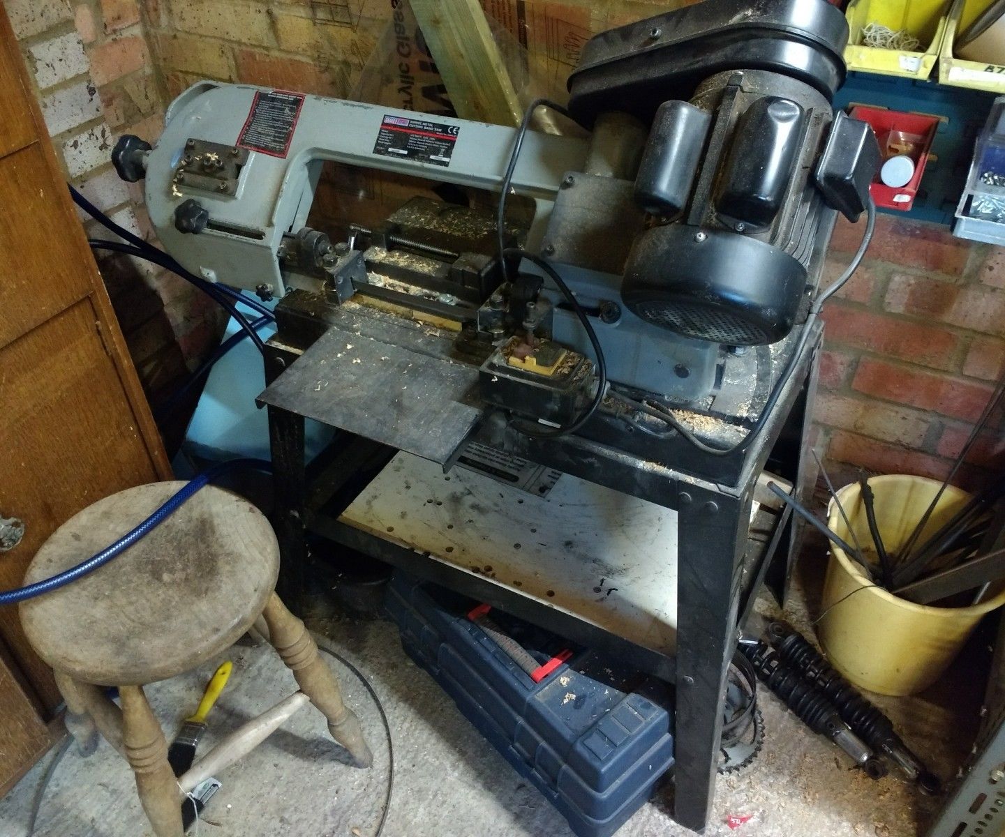

Cheers Paul, I shall have a look when I get some time on it, helping the father with their caravan and some other bits and pieces tomorrow. Maybe get some time come the weekend.The vertical bade alignment can be fine tuned by loosening these bolts slightly and twisting the blade guide mounting a bit, also it need to be adjusted to make sure the bearing is supporting the back of the blade,
