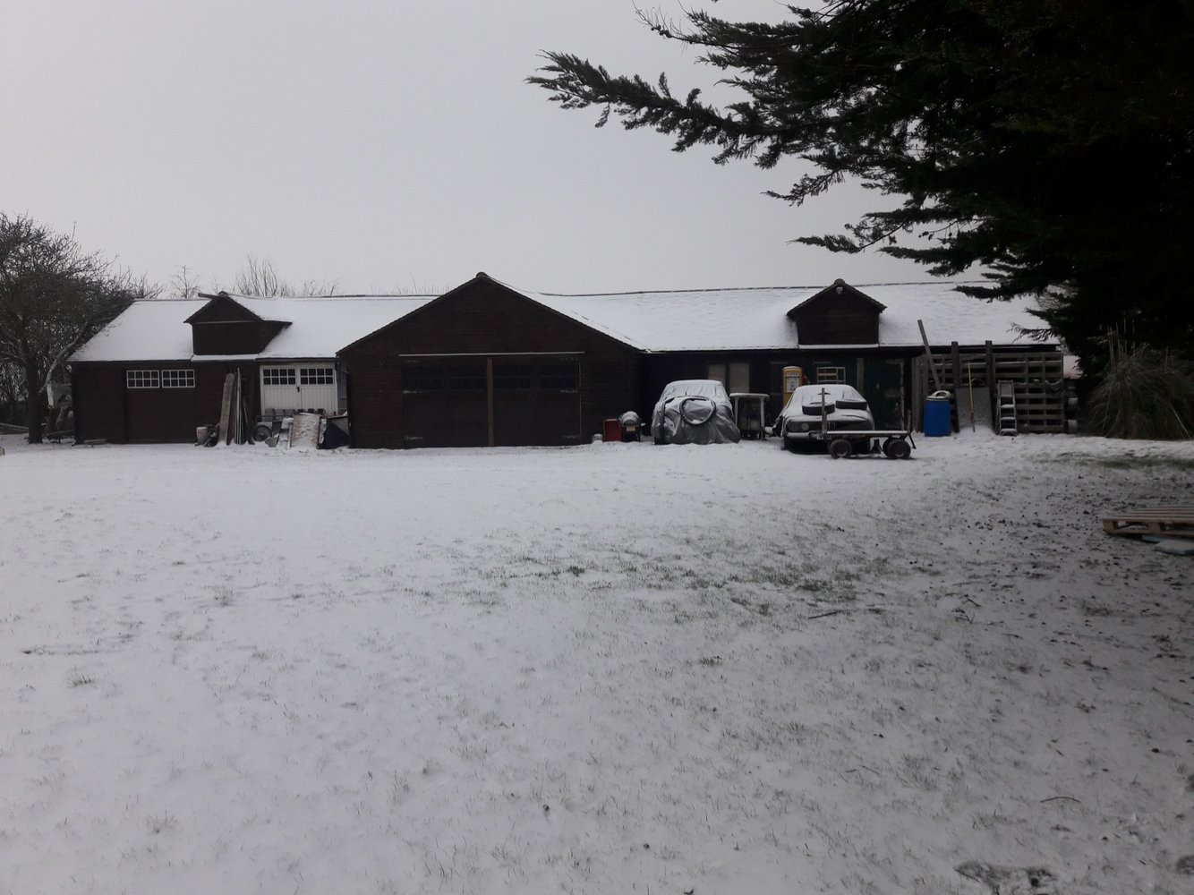

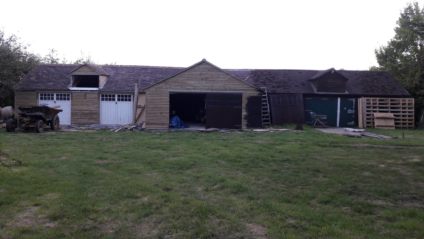

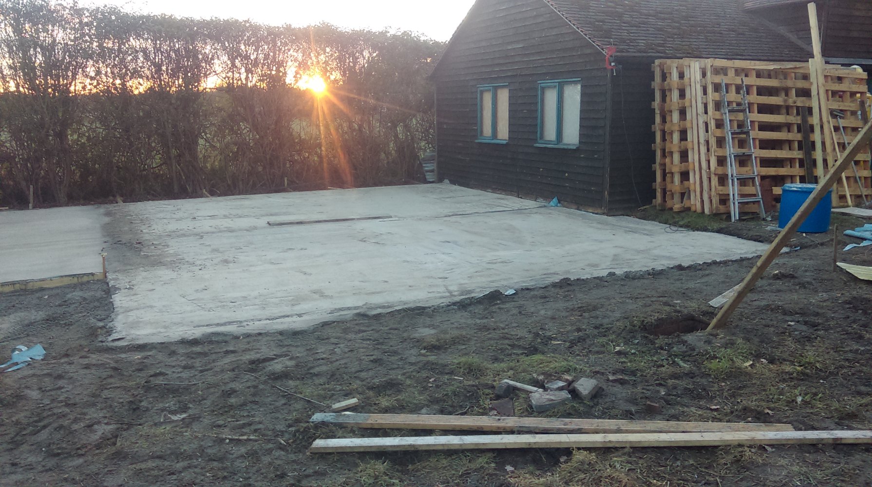

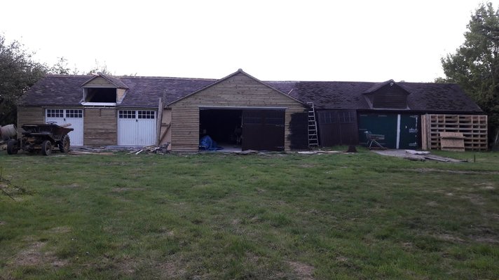

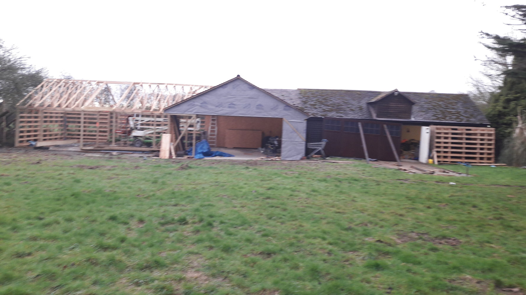

3mtr x 3mtr pallets free from a local plastic sheet firm, tannalised fence post type wood round the base, between pallets and along the top, roof trusses from Ebay, rockwool dropped down the gap, toasty, cheap, very quick to put up fantastic insulation for noise and heat / cold, screw anything anywhere,
