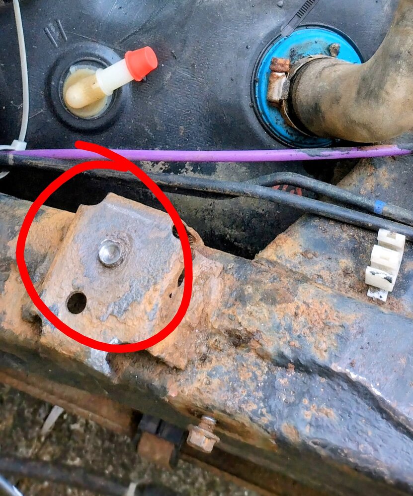

This is the front left mount of the tub on my Hilux a notorious focus of rust.
To remove the tub had to open a hole in the floor so that I coul drill the head off this bolt. It had cirrided so badly that what was 17mm across the flats varied between 13.5 and 15.
Anyhoos, the tub is off and I need to get that bolt out. My thoughts are to place a suitable (M14) nut over the remains of the M12 bolt, then use my SIP Migmate 130 to weld down through the centre of the nut to attach the two.
My very first attempt was not a success, mostky due to the state of the migmate. It was gufted6by a friend after laying around in his garage oir a few years. Thanks ro members on here repkying to my intro I have stripped and cleaned the wire feeder and guide and it works so much better...
So, to my question, at last! How would you approach this on a SIP Migmate 130? In fact is it even realistic to attempt it this way?
The bolt is a M12, the wire is 0.8mm and the SIP only has switches to regulate the power.
I am assuming that this needs the switches in High,Max and wire feed somewhere around the middle.
Would ut make sense to try to build the height of the bolt remains with some beads of weld then grind back to fit all the way through a nut first?
