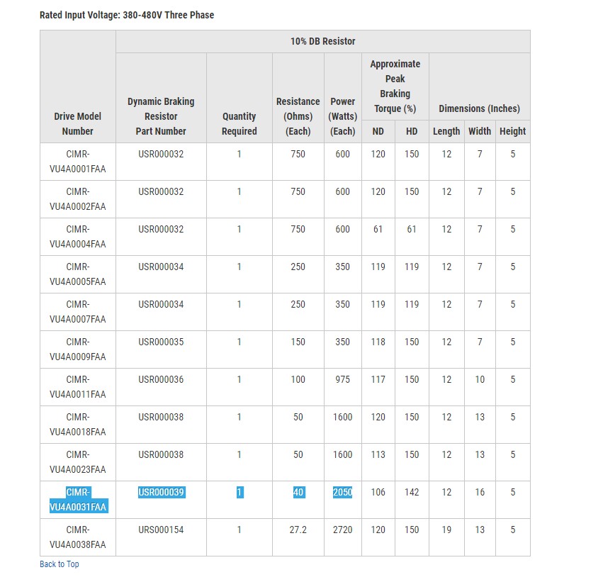

I am thinking about putting a braking resistor on the VFD that I have on the lathes spindle.
The Yaskawa info I have found says this
So basically 40 Ohm and 2050 Watts.
I have a few dead 22Kw servo drives and they have internal resistors that could stop the spindle from 2000rpm in 1/2 second. The ratings from the servo drive manual says this for the resistor.
So basically it is saying 20 Ohms but it gives 2 values for the power, 400 continuous and 32KW peak.
I have a few sets of these so could link in series to give me the 40 Ohm Yaskawa say but continuous would only be 800 Watts but 62kw peak.
What do you think, bearing in mind a spindle will be stopping in a second or so max, would that resistor have enough of a power rating?
