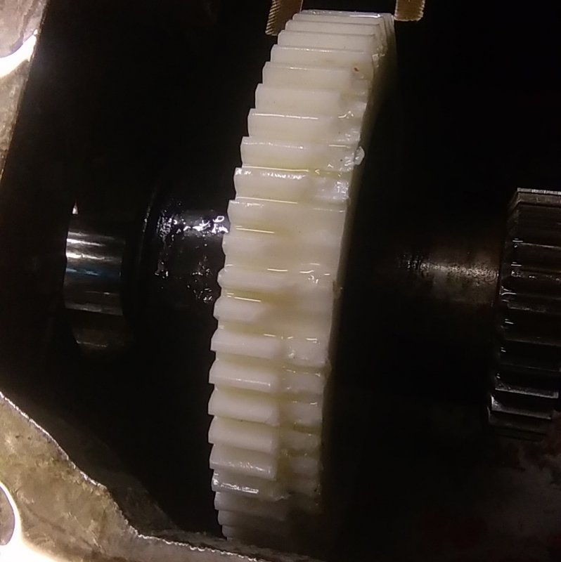

I was taking a heavy cut a while ago and got a bit of edge weld-up on the tool which loaded the motor so much it nearly stalled. After that it was a bit noisy in the headstock but I ignored it till last week when all of a sudden it started jumping out of high gear. So I pulled th elid off and found the plastic gear I had made 4 years ago had sheared a load of teeth.
Looks like I'm making a new gear tonight....
