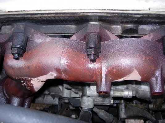

Over the last couple of months, I have been hearing a little chuf, chuf noise on startup - which sounded very much like an exhaust problem. Decided to give the system a once over.
Happily, the central section (with two very expensive Cats) all looks OK. I know the back boxes are OK, so I decided to have a look at the front downpipe - all looked good.

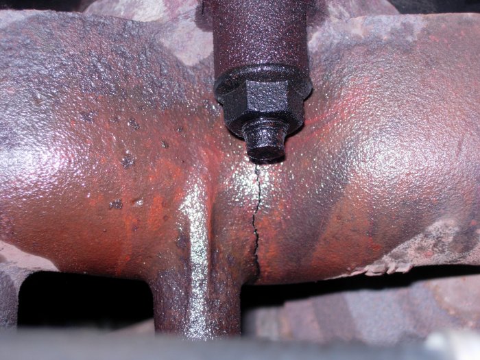

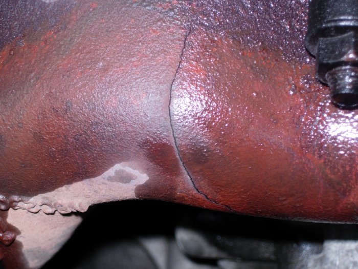

Then I saw it - laying on my back, looking up into the engine bay, I noticed what looked like a small crack in the underside of the rear exhaust manifold. These cars are actually know for this, so it was not a copmplete shock. However, just to get a better handle on the condition of the manifold(s) I removed the heat sheild from the engine bay. Here is the sight that greeted me:
In short, both front and rear manifolds have cracked. The parts (new) are about £300, so with tyres, I'm in for £500 (ouch!)
There are a couple of second hand ones on the bay for about half the new price, but I guess it's probably worth buying new (can't imagine used ones would be particularly long-lived; so it could be a big flas-economy).
With the heat sheild in place, these cracks are not visible and, truth be told, the chuf, chuf isn't that loud - so I'm hoping that the MOT tester may not spot it (giving me a little longer to sort it).
These are cast manifolds, and I did think about getting hold of some Stainless wire and having a go at MIGing them - but that in itself could be a costly 'experiment'.
So, all things considered, I guess I'll just bite the bullet, buy the parts and do the job.
If you want to run one of these wonderful old cars, then I guess you have to be ready to accept the cost. I'm estimating £500 for this year's MOT and whilst that hurts, this car is a keeper, so over the remaining life, it'll pay for itself.
