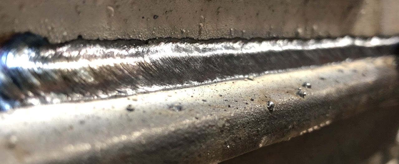

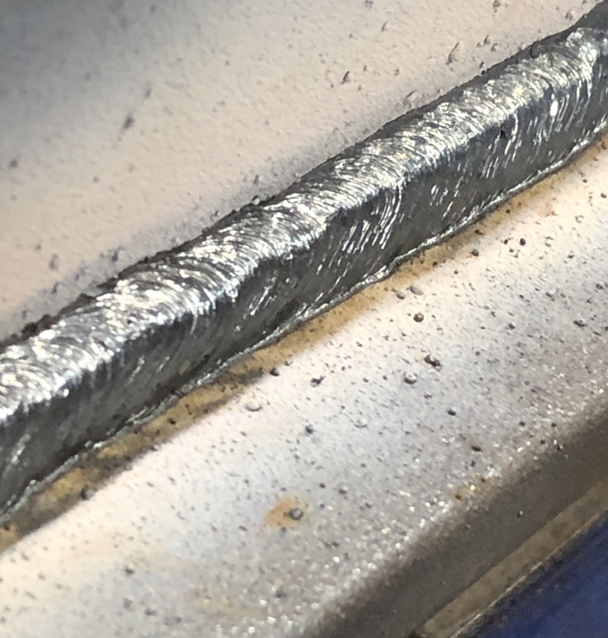

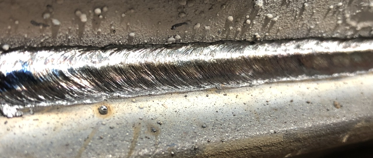

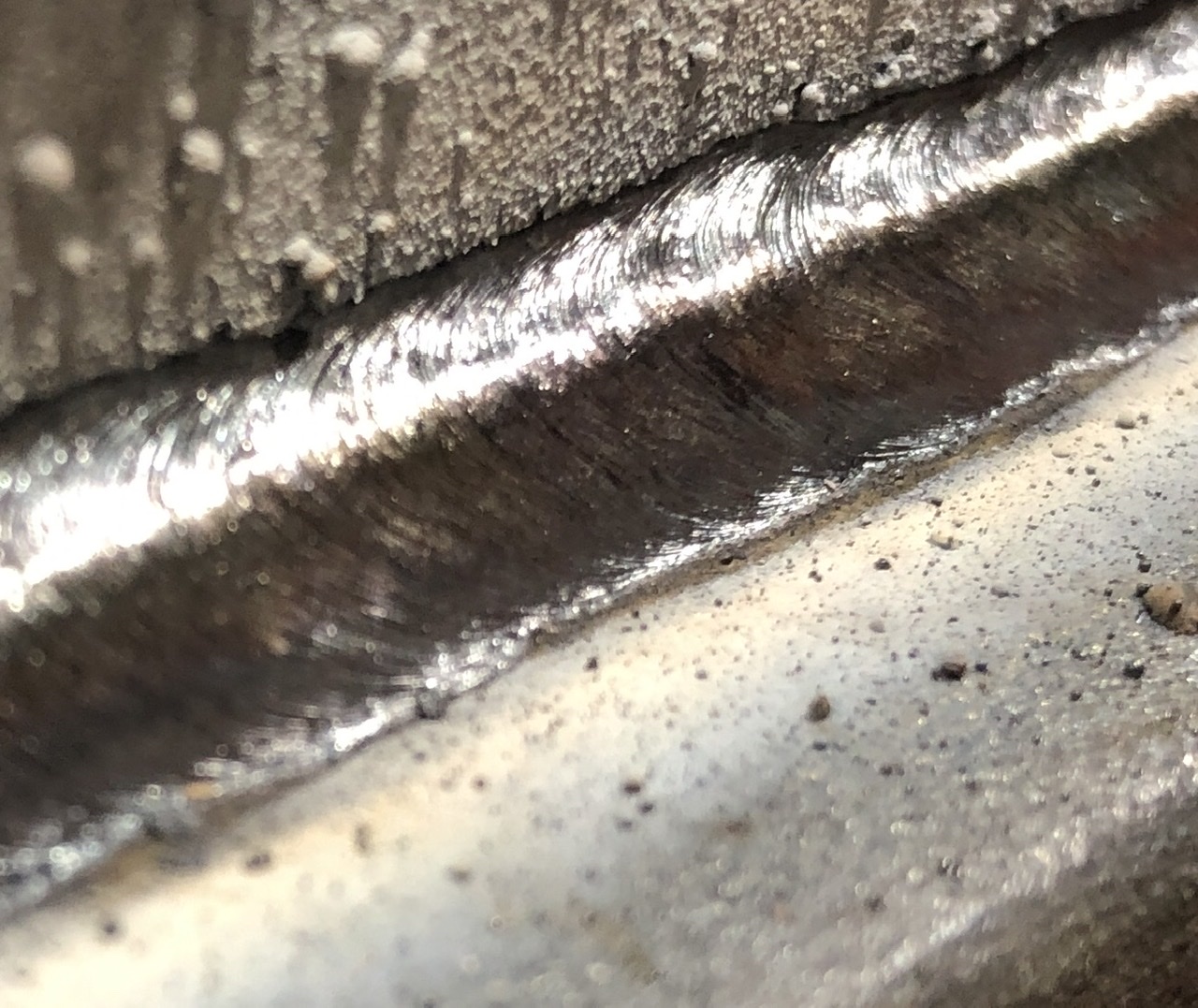

The only time i find myself using DCEN while stick welding is with a 7016 welding a root pass (a real rarity lol).
Usually 7018 or 7024 for structural. One 6013 ive liked before now are FincordM which couple of places ive worked have used them for general purpose sort of welding, but any pipework thats not specced for LowHy has been the same across the board, the good ol' faithful, Murex Vodex 6013.
