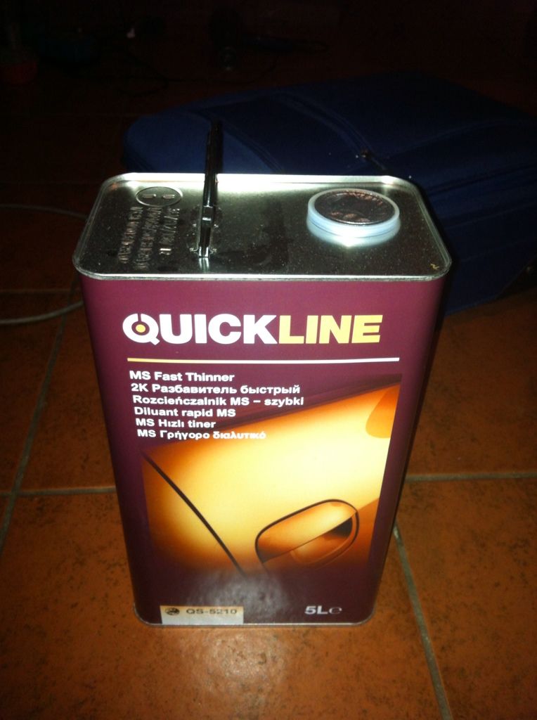

S squazy84 Banned Messages 730 May 13, 2013 #1 is this the correct thinner for lechlar 2k epoxy primer?im not sure i trust the paint supplies shop assistant i bought it from

A anjum Member Messages 1,204 Location London UK May 14, 2013 #2 No, that looks like normal 2k thinners. There's a special thinners for lechler epoxy.
langy langys rodshop Messages 6,095 Location London May 14, 2013 #3 Incorrect thinner, use a paint factors that knows better

C Chipper Member Messages 1,550 Location UK May 14, 2013 #6 I use 2k thinners with it, no problems, but not 'fast'. Same with Jotamastic, they do their own but no probs with 2k thinners.

langy langys rodshop Messages 6,095 Location London May 14, 2013 #7 squazy84 said: Aw man, I knew they were bullshitters! Why does it always have to be this way!? Can you recommend a brand or part no applicable to the lechlar epoxy? Click to expand... 00516 LECHSYS EPODUR THINNER or 00556 LECHSYS EPODUR PF THINNER
