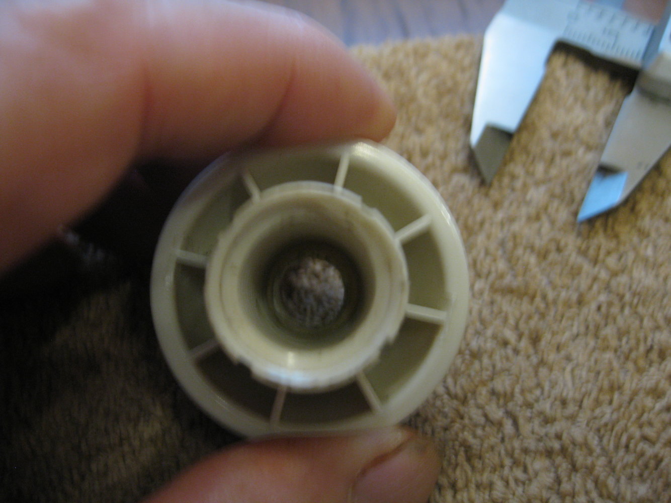

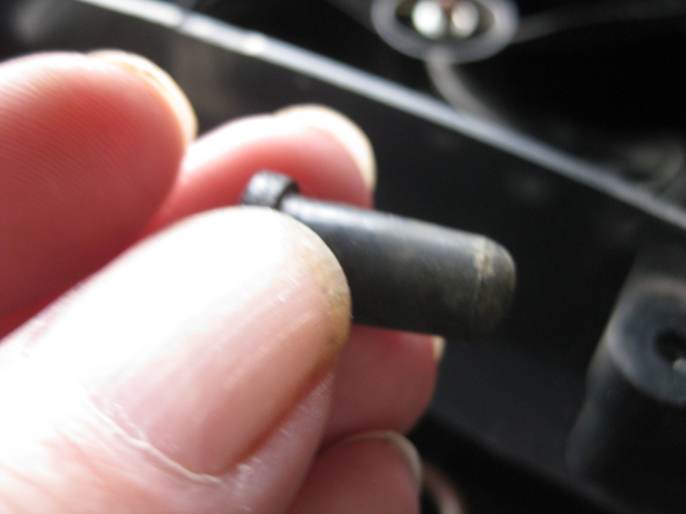

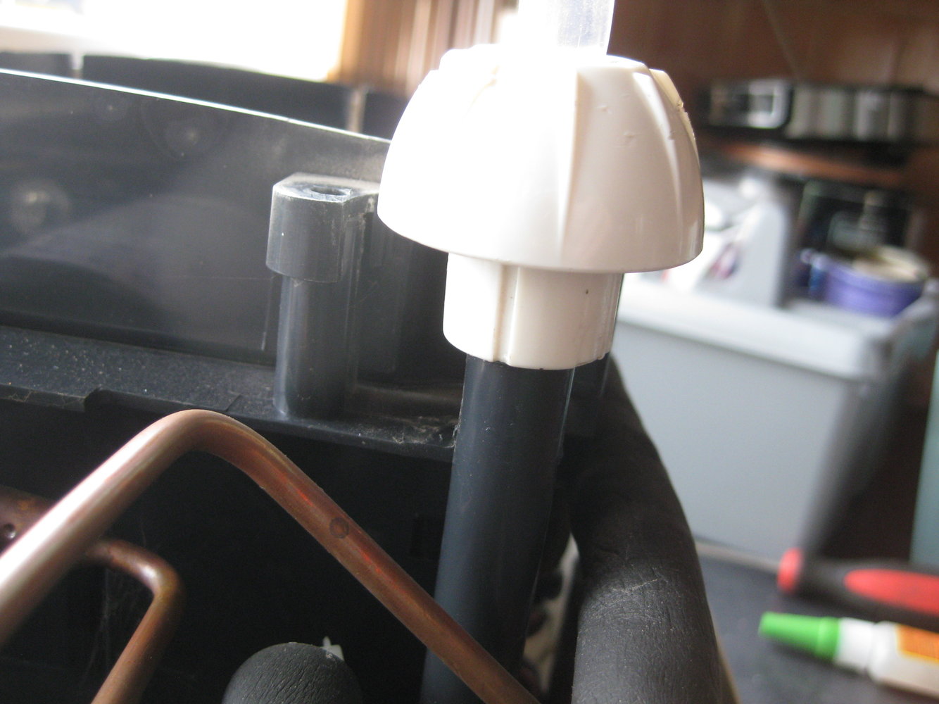

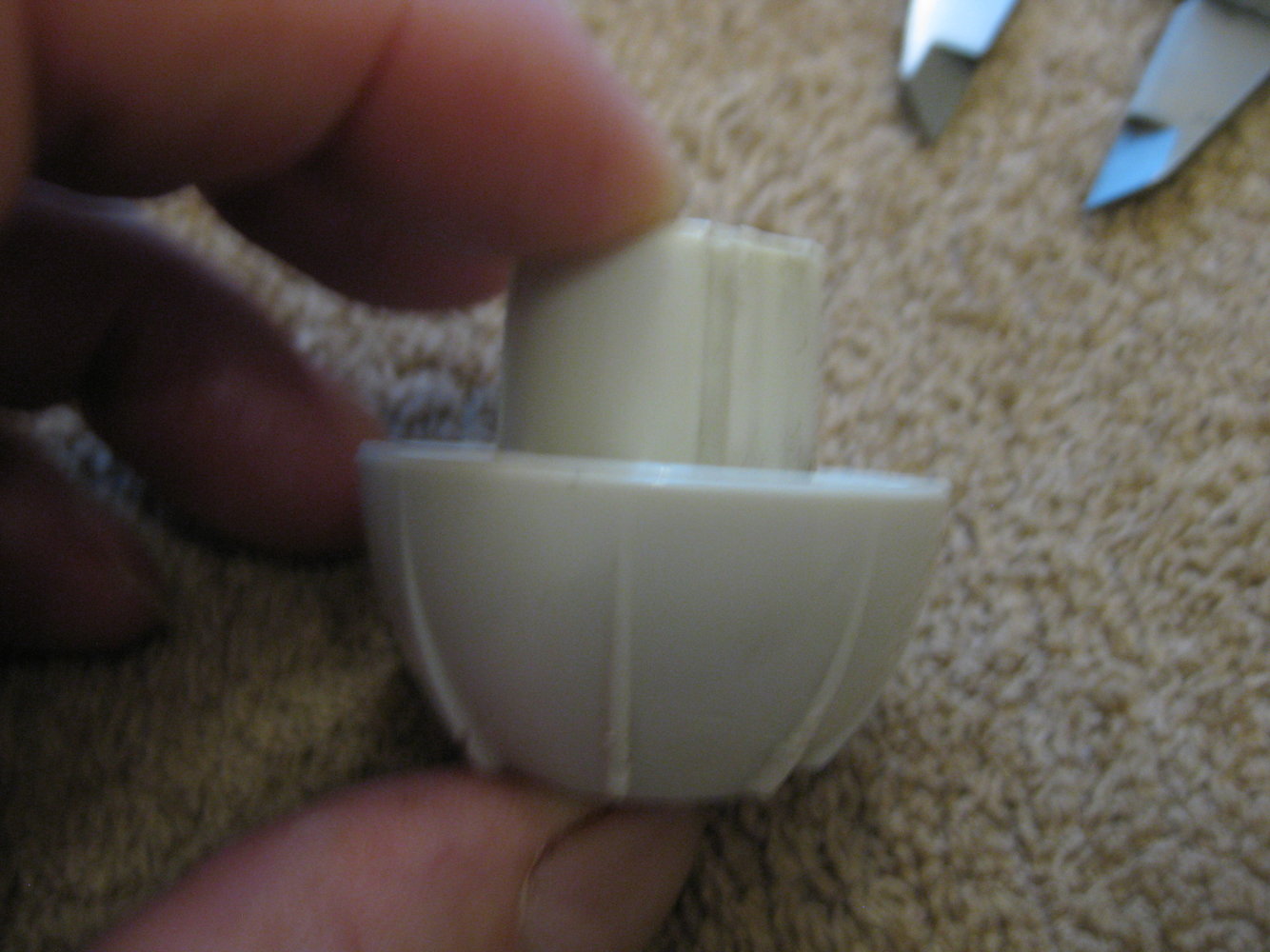

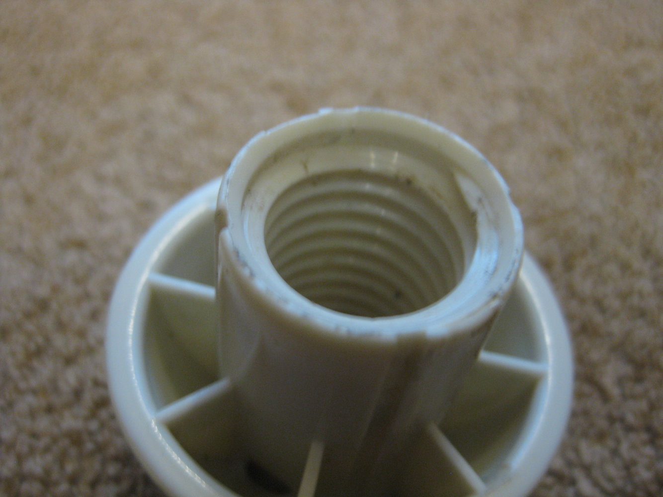

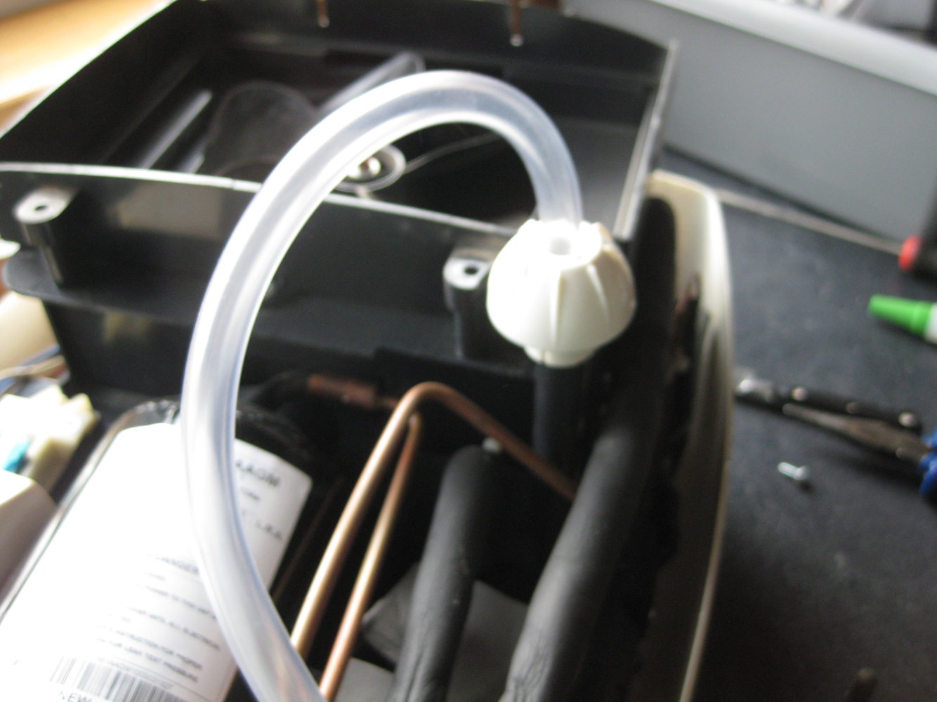

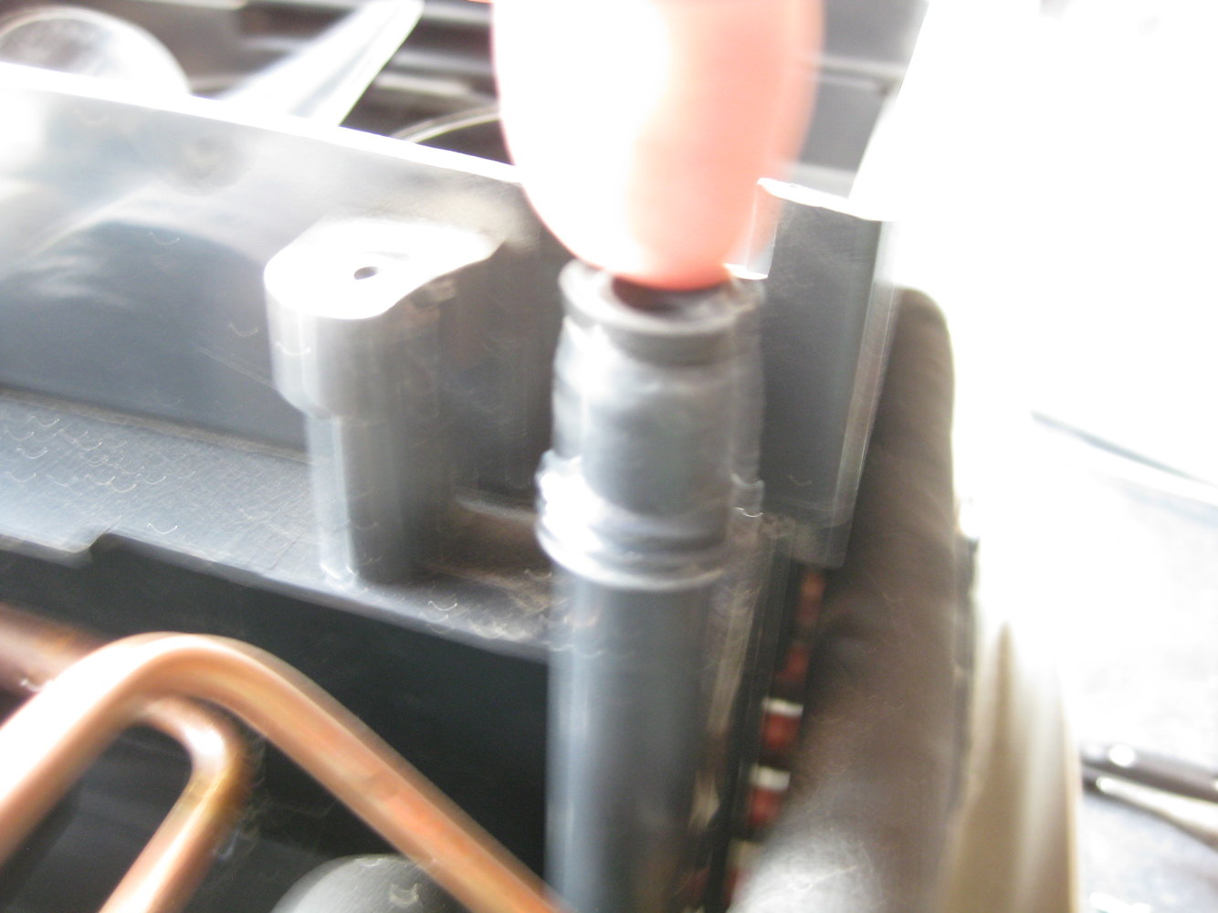

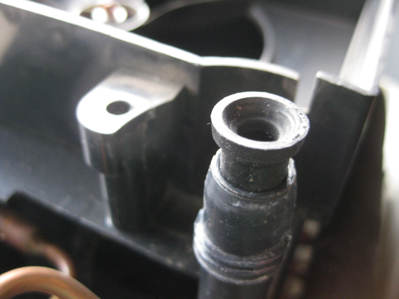

I have a fairly modern dehumidifier that has the facility for a connected in auto drain facility . I want to set it up safely for use in a wet room
It appears to be a long internally threaded tube to which to other end allows the connection of a pushed in clear plastic pipe .
This internal threaded tube has to need to have around 50 mm of 14 mm internal clearance in the tube after the initial screw on thread of 25 mm so it will not press down on an automatic sealing plug and send the unfrozen condensate to the internal removable water holding tank .

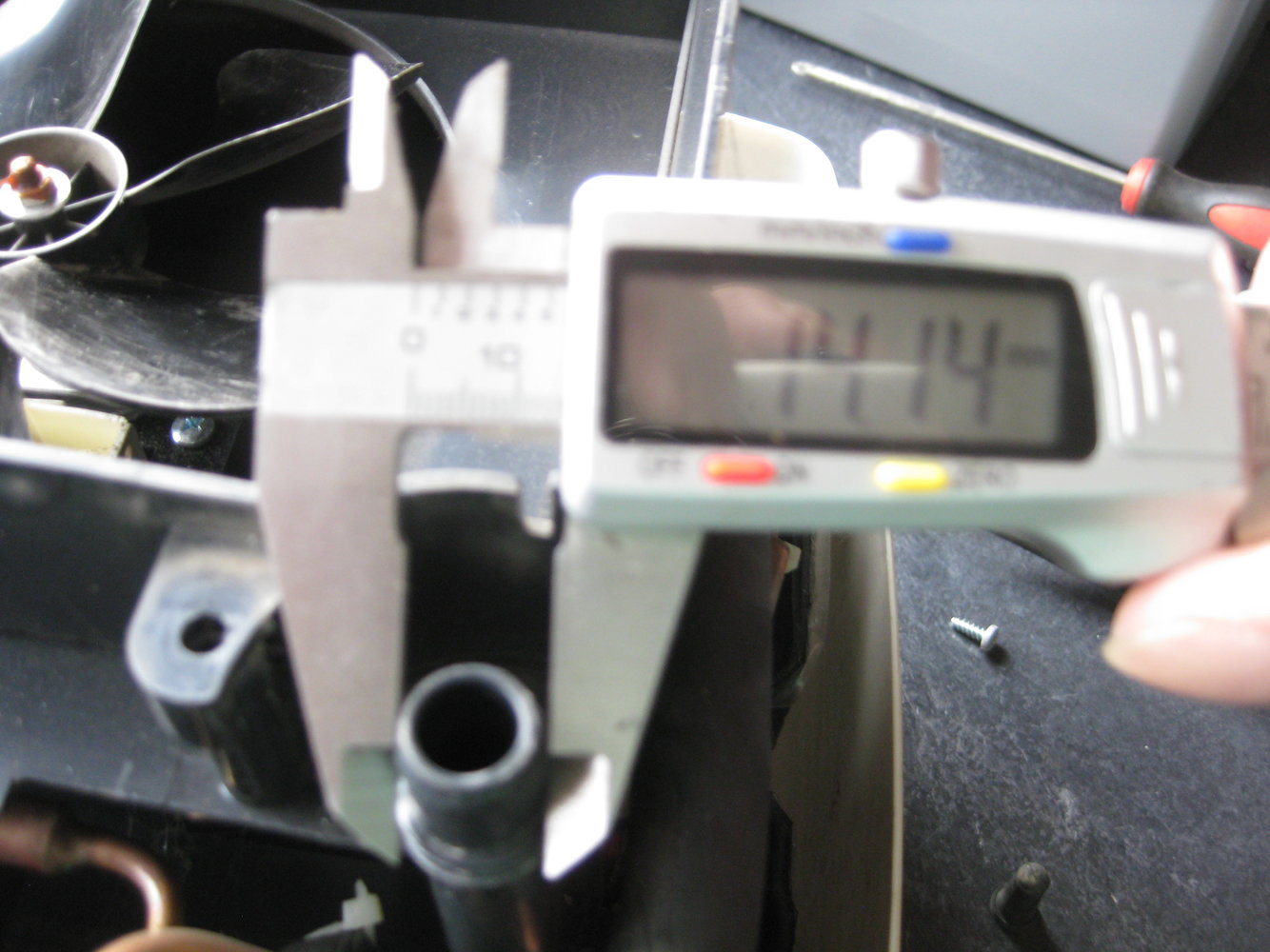

I'm having difficulties trying to identify the thread form , all I can give is it the spigot it will be fitted on the spigot thread down a 22 wide hole & is 14.51 mm at the root dimeter ( .580 of an inch ) Not sure if it is a metric . or bsp type plumbing parallel or a slightly tapered thread as I cannot measure down the hole that far.
