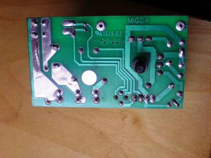

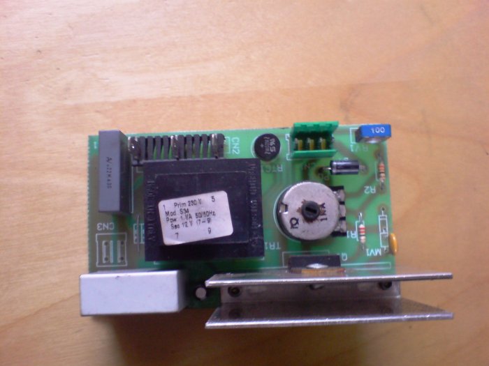

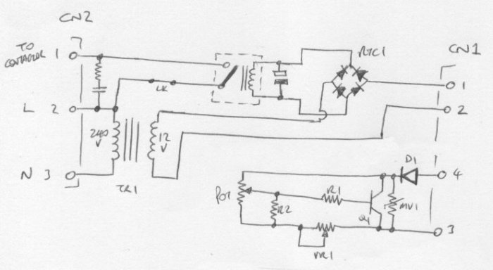

R R Kraft Member Messages 1,228 Location Wyoming, USA Nov 9, 2011 #21 Still should be approximately,this one.:http://www.eddiem.com/projects/mig/speedfix.html Robert
Wedg1e They call me Mr. Bodge-angles Messages 7,892 Location Teesside, England Nov 9, 2011 #22 Yep, does look a lot like it. I see the PCB relay does switch the transformer directly, wonder if they fail very often...
R R Kraft Member Messages 1,228 Location Wyoming, USA Nov 10, 2011 #23 It seems that the transformer failing is a relatively common failure. Robert
