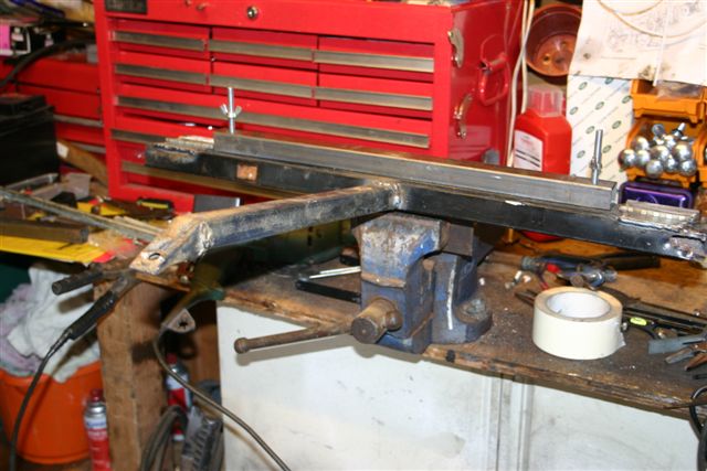

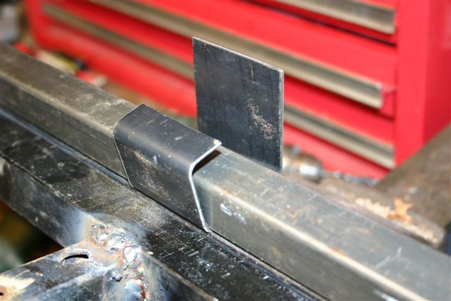

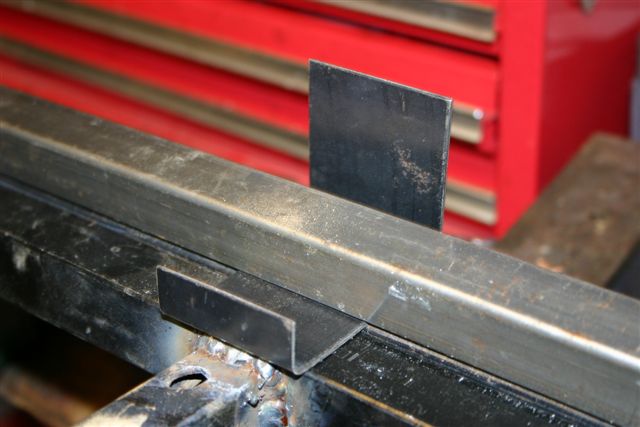

This is my attempt at making a tool to bend thin metal plate.
Its based around some box section i got from an old desk, a piece of angle plate i had made up for a chassis repair on a Lada but never used it, and some hinges from a cable management arm from a server rack.
All welding done with my Clarke 100EN and Co2.
So...Here it is
