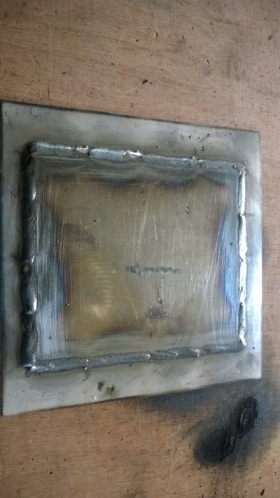

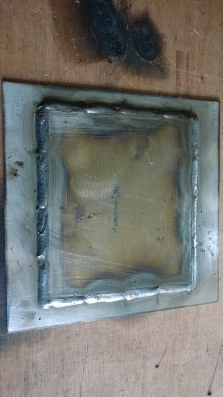

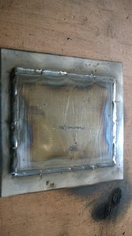

good evening all...
this afternoon i had some time to do some practice welds of 3mm plate to 1.5 mm plate...and for my first attempt i think all is good..seem to have good penetration of both pieces and with no blown holes and minimal distortion...what do you guys think....

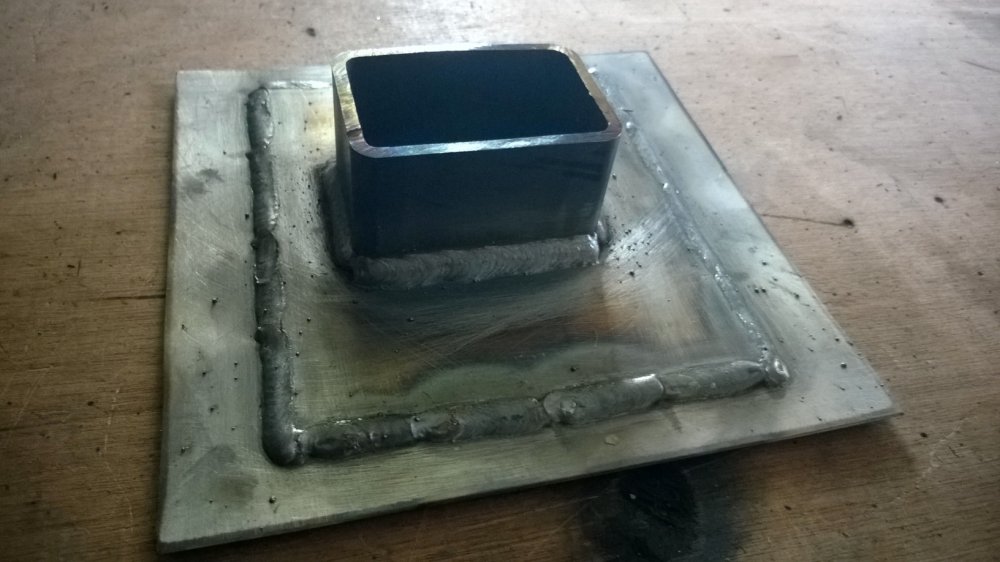

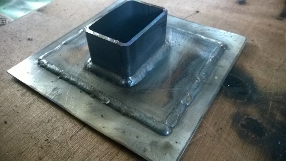

ok cool..well the reason is i love drag racing..and planning to build my own pro street motor..the 3mm will act as a spreader plate and the 1.5mm will be inside sill that the spreader plate is welded to...at the moment i am experimenting with lots of different techniques to find what works best for me...

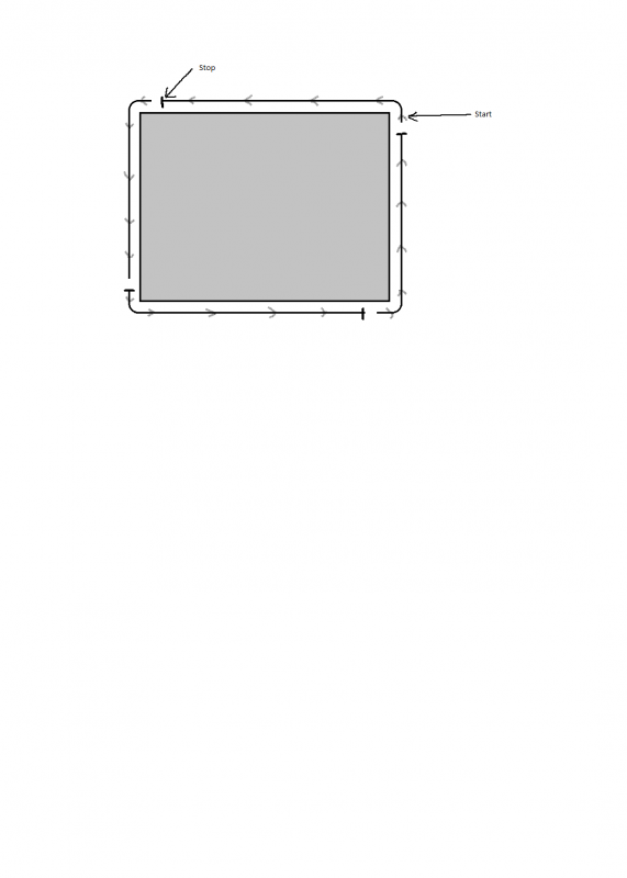

Couple of things to try which would make a better job of it:
Firstly, Rather thn have so many stop/starts along each side, try to weld each side in a continuous pass. Each stop/start is a potential weak point, especially with dip transfer mig welding.
Secondly, due to the potential weaknes in a stop/start, dont start or finish your welds on corners. Best practice is to start 10mm or so, away from corner, then weld to the corner, around it and then progress along the side. When you come to the next corner, stop 100m short of it.

sorry..i only just read your reply...thanks for the information..i only did it with that many stop starts just to keep the heat down so i dont distort the metal.but will give it a go....thanks...
