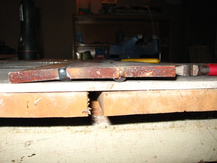

In the first picture the top row shows starting out, finding a decent wire speed. The second row was at a 14 setting.

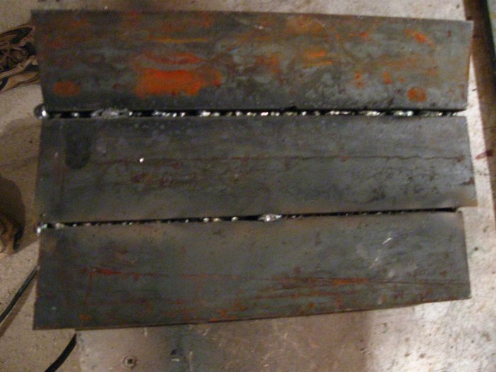

The second picture shows the gap and penetration (or lack of).

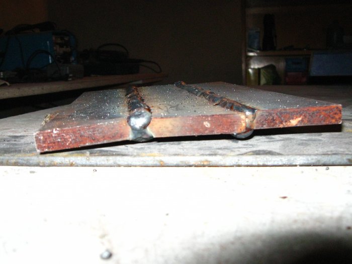

Third picture. Yep, thats 10mm!

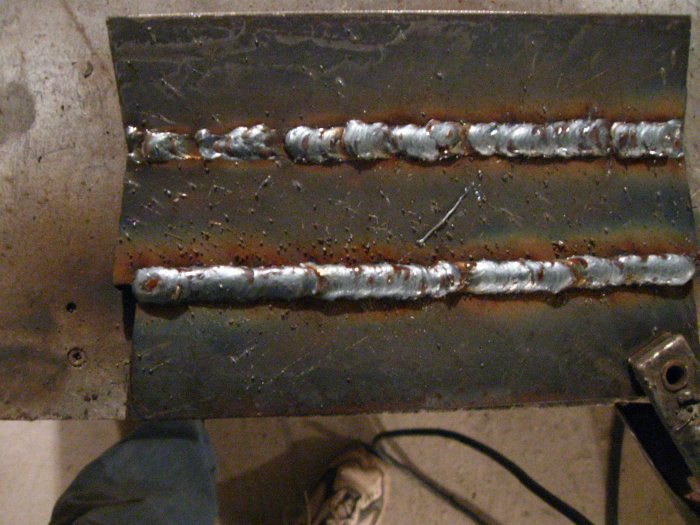

Fourth pic. I figured what the heck and welded the other side too. I wanted a single long bead without any breaks but my left hand kept getting too hot.
Wire speed at 12.

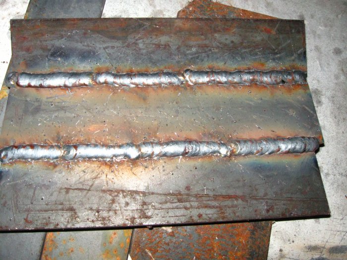

Last pic. Side view to show height of welds.
As you can tell, I'm no expert. Apart from ve-ing the sides what would improve the welds? Should I have done a wider weave? I don't have anything that can cut that steel to show a through cut of the weld.
Wire speed at 12.
