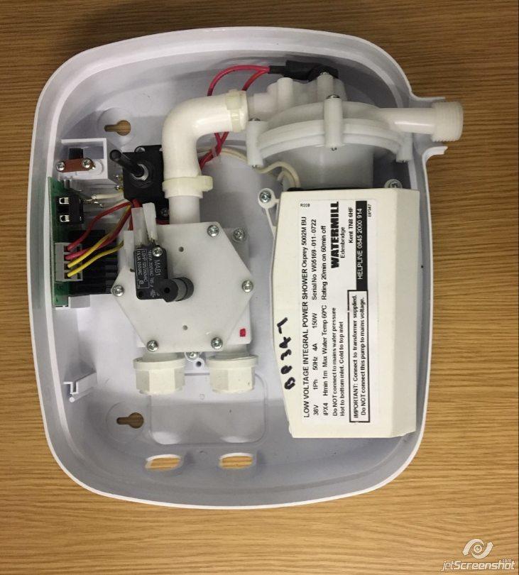

As per title how much anti gravity thermo flow do you get from the DHW water system ?
there must be some. ??
I have my bath and shower fed with two 22 mm from the storage tank, cold direct to the bath/shower hot though the tank then to bath shower is tee'd of then down to 15mm to the shower, which is a semi power shower single pump in the shower cubicle with a twin silicon pipe temperature adjuster ie as you go towards cold it shuts the hot and opens the cold, the two are mixed before the pump, that then pushes it out of the head.
My problem is; if the hot is turned to max hot, the pump cavitates and hardly any water comes out of the head, the pump does have anti scald, but that shuts the hot solenoid off in the event of the hot being too hot but when it cavitates I still have voltage to the solenoid.
Now if I turn it to full cold the pump runs fine. I have tapped the hot solenoid valve to see if it is sticking, makes no difference
I seem to have nearly equal flow at the bath mixer, from my experience the hot is allways slightly slower due to the rigoures of the flow throught the tank etc and the anti gravity of hot water, I believe.
The shower and bath are fed through an warrick / surrey flange, but I also have an upright tee off the flow joined as high as poss and restricted, to the tank breather because was still struggling with some kettling at times because of the immersion, but even if I close the restrictor valve it makes no difference to my issue.
I am going to back flush the shower with mains pressure but I will have to disconnect the pump electrical feed, and I could do with blocking off the breather whilst back flushing to make the water reverse flow through the whole hot feed. I dont want to damage the pump due to hammer
Any other ideas ??
