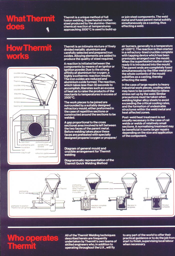

In the past, when I've been filing materials (mild steels & aluminium) in the bench vice. I had often not cleaned up the metal particles.
I was reading about thermite recently, and wondered if I had been in any danger from the risk of a reaction?
The bench stays clean now (good practice), but it still makes me wonder if there are any other possible dangers; eg. grinding m/s and aluminium composites...?
