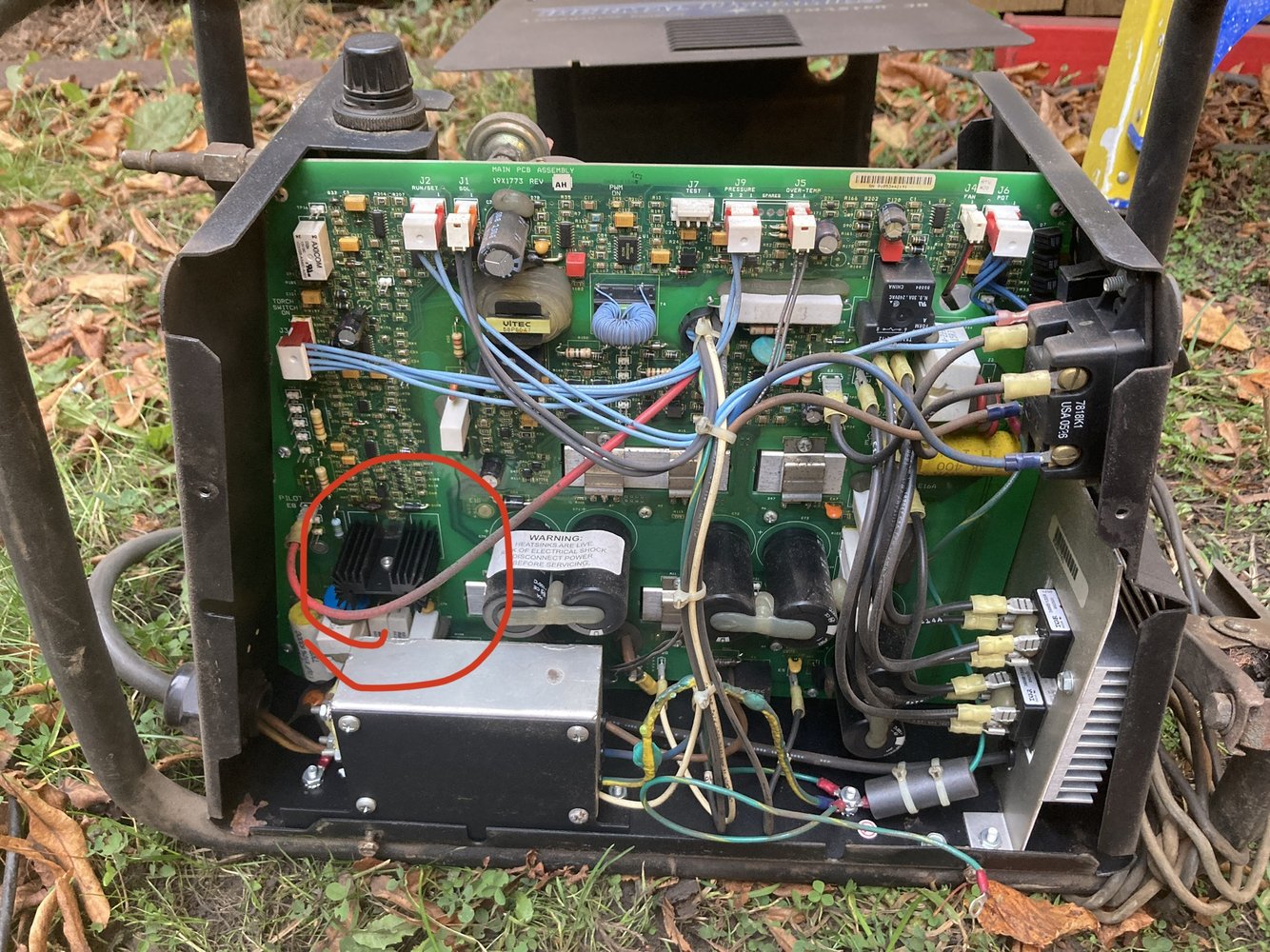

Hi all, I picked up this cutmaster 38 a little while ago and couldn’t get the pilot arc to start so it’s not cutting at the moment, I’ve swapped out the torch consumables but still no luck.

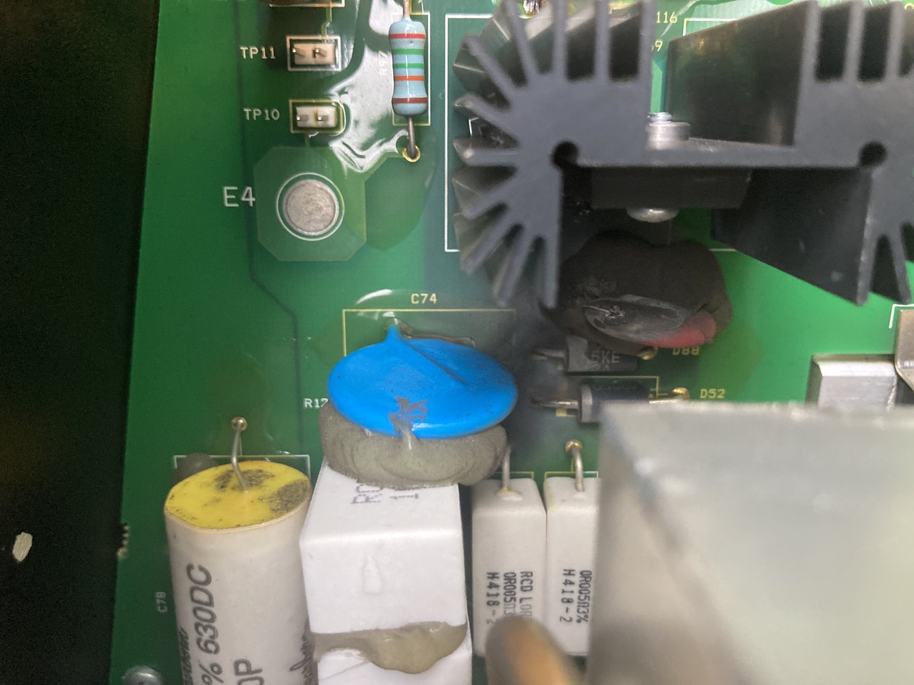

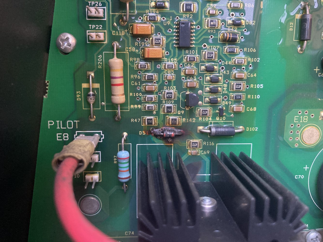

After cleaning it out (it was stinking) I can see it has an issue on what I believe is the circuit for starting the pilot arc.
Does anyone here have any knowledge of these machine or can point me in the direction of someone who does?
I work with some electronics whizzes so if I can get some photos or part numbers of the failed diode and power device I can probably get them replaced.
Any advice welcome,
Cheers
