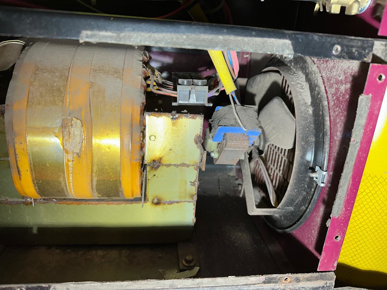

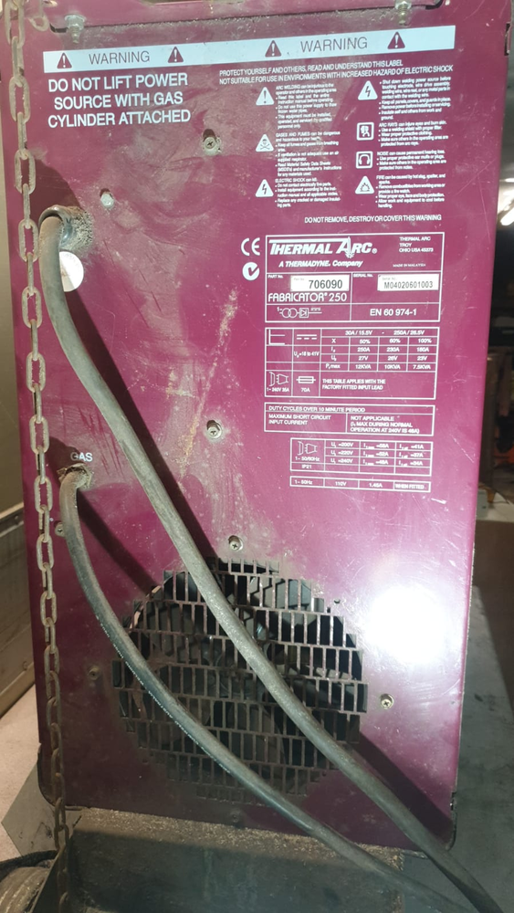

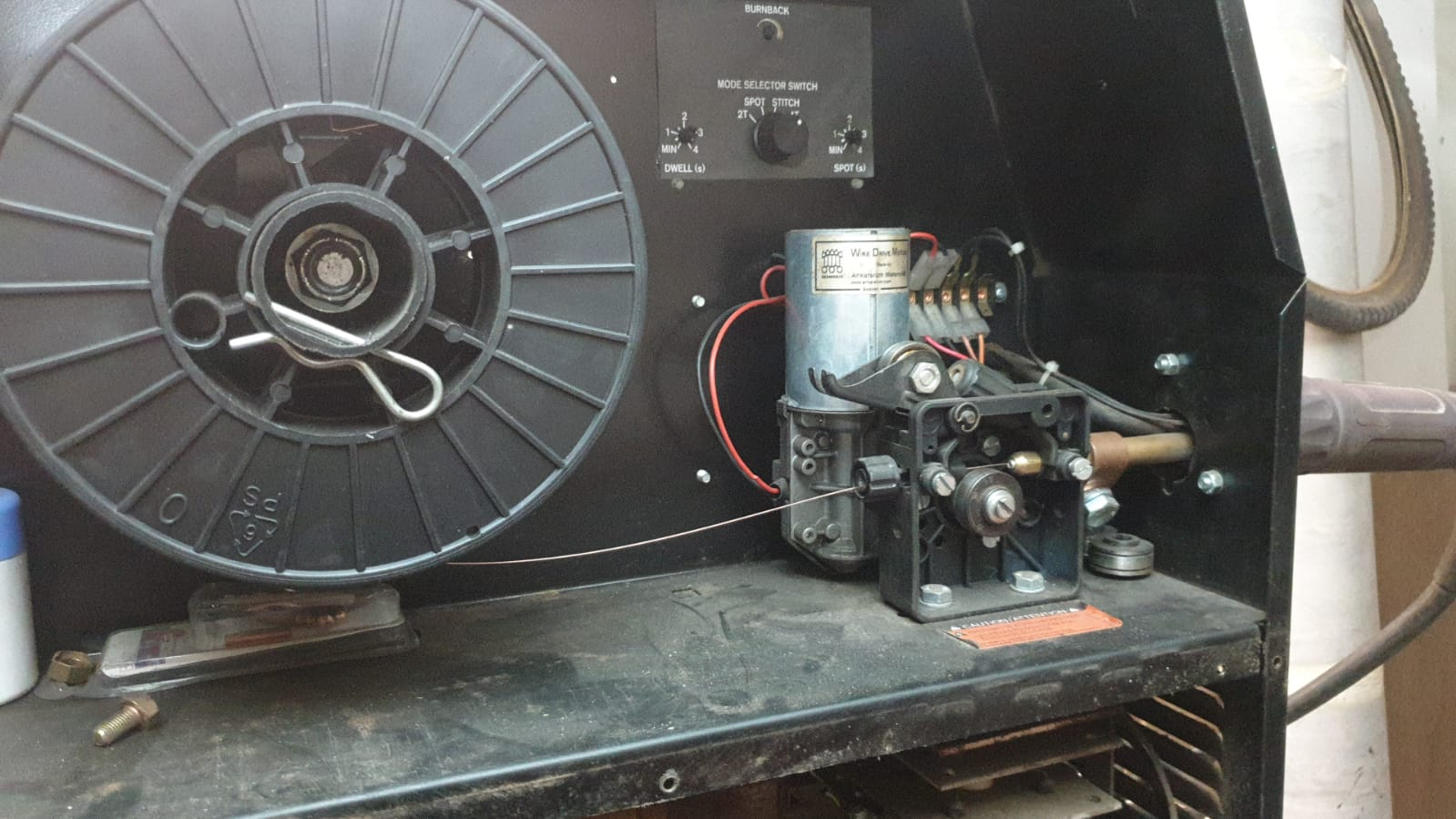

Hi there,

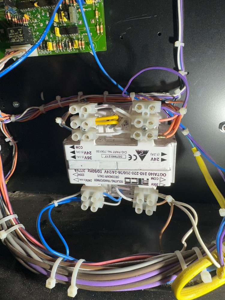

I am fault finding a welding set for a family member, at first the set was not doing anything but I found the neutral or common going to the isolating transformer was 240v down to earth. I have disconnected the three cores of the cooling fan to temporary fix this issue. for some reason the fan has 250v on all three cores which is strange but I have disconnected this completely to continue fault finding the low power output. after this the machine is arcing away like it should but with low power.

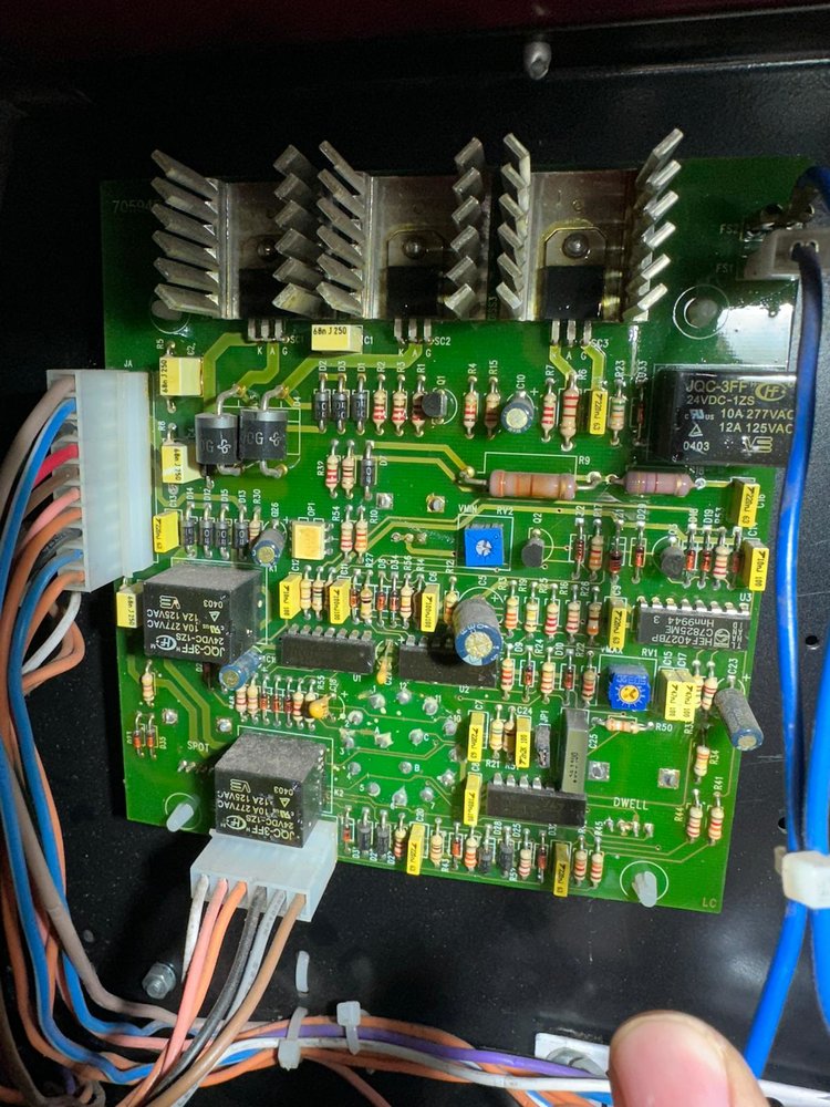

I've been using ChatGPT to assist me and it is recommending check the following;
PCB - Cant see any visual damage
Rotary Switch - Visual tests ok got a bit lost checking for ohms when switching - unsure which of the 16 terminals should be switching to which but looks ok and all similar resistance readings.
Power supply - This seems ok now that I sorted the shorted live-neutral fault
Capacitors - I can do this no problem technically its just hard access

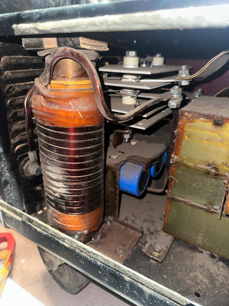

Rectifier plates and Diodes - I cant actually see the diodes within the plates so unsure how to carry this test out.

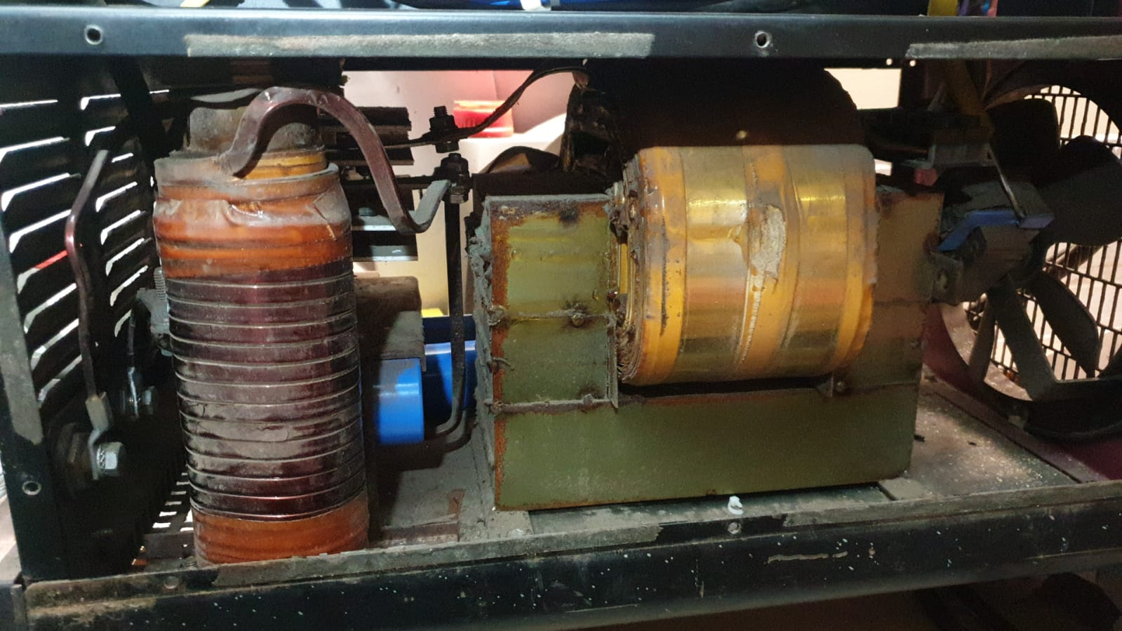

Transformer (main) - Very hard access
Inductor & Coil - Again hard access
I had a look at these visually and they seem ok although dusty but to test them all individually is going to require a full stripping of the machine to gain access and to disconnect each item from the rest. So I just wanted to ask firstly if there is any other common faults that I should be aware of or quicker ways to test the capacitors, rectifiers and main transformer without stripping out to gain access.
Also why has the cooling fan got three cores? and how would I test the fan seeing as its got 240v on all three cores am sure its knackered but would like to confirm, but i dont understand the three cores.
Cheers,
Shaun
