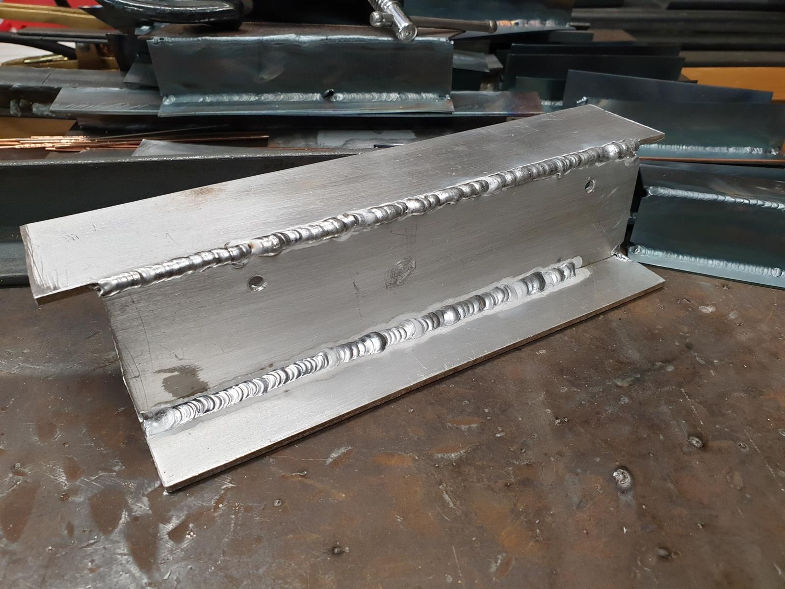

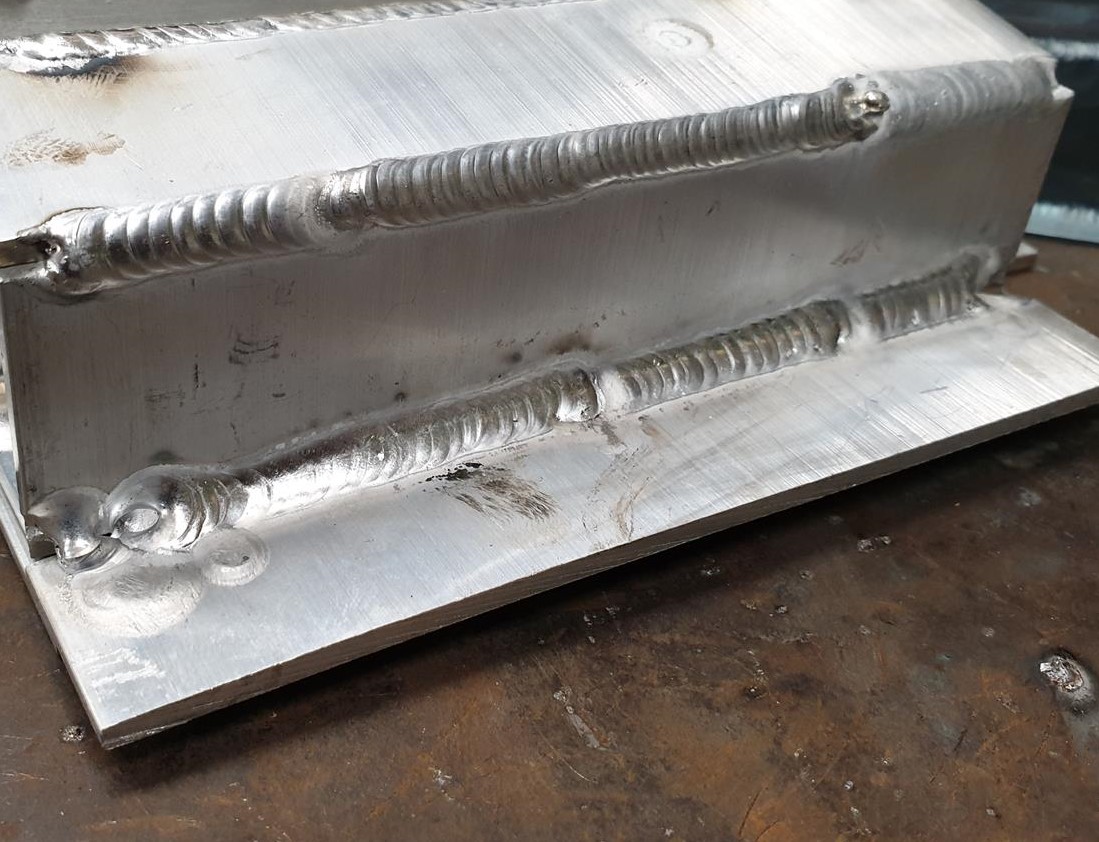

This is what I could do before the lesson with aluminium:
And after with more current, faster travel speed and several of the other things I already mentioned:

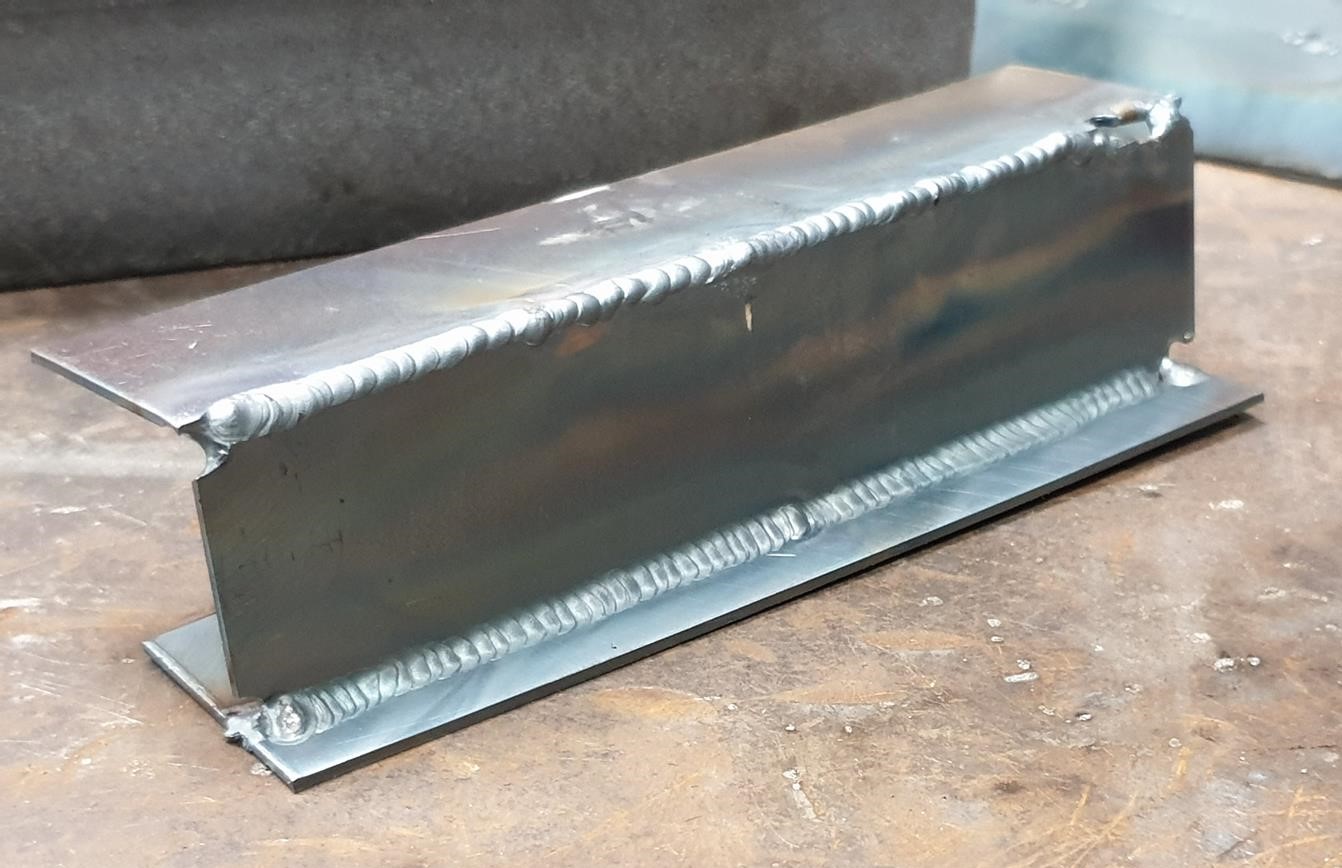

And this is steel after the lesson with 1.6mm filler (I've been practicing fillet welds a lot more than outside corners on steel):

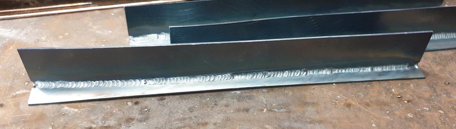

A longer piece where I used some 1mm mig wire for the first few inches on the right and then went back to 1.6mm filler for the rest of the run:

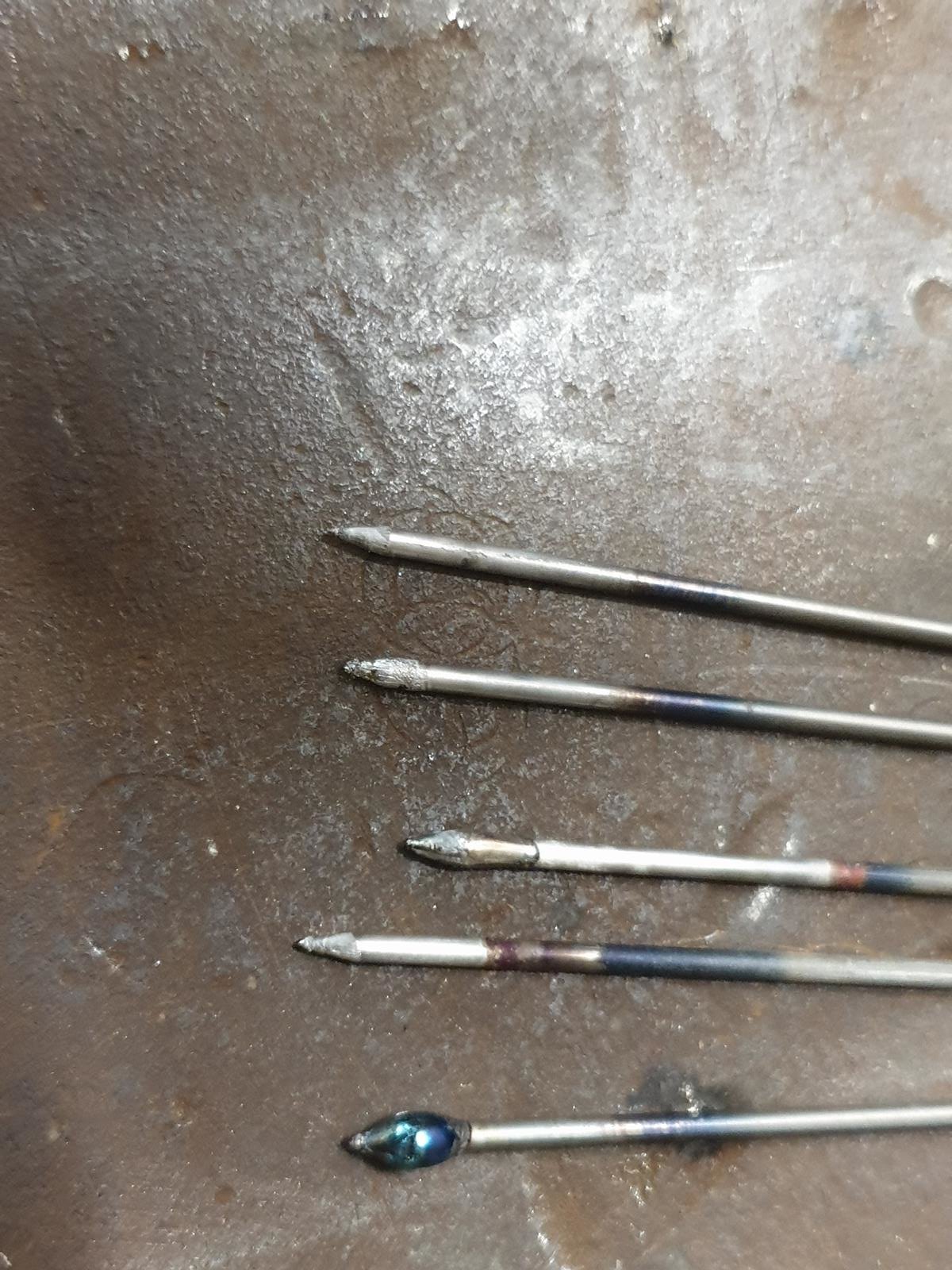

And the fallout of the practice that I've been doing:
