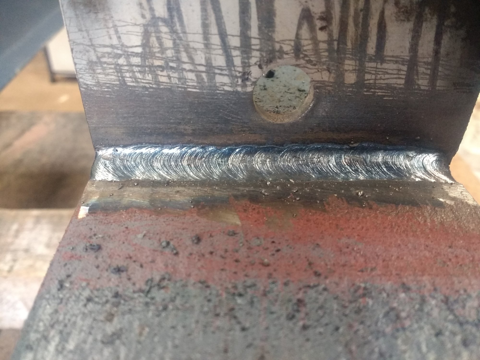

The first 15mm of my welds can sometimes have a hole in it with slag in it. The rest of the weld is real good.
It feels like it takes that 15mm till the weld sounds better, could I be starting too slow.
Ill get a couple of photos tomorrow if it happens again

do what I do have a striking plate on the return clamp . strike the rod up on that then transfer to job
it works a treat as the rods already hot stops a cold start and spatter all over
ha, agree with b spark exactly what I do ,my rods are rarely used so find it pays to use this method on old rods.
