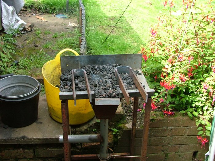

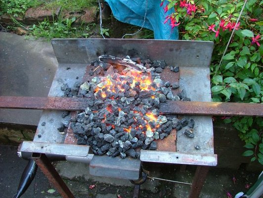

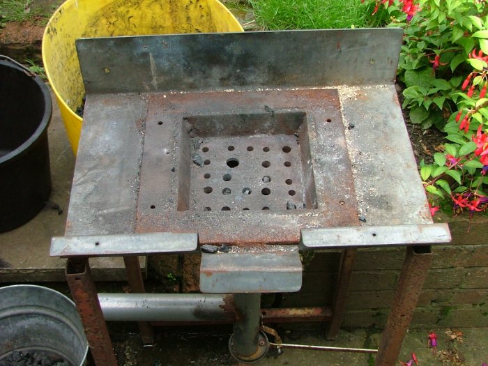

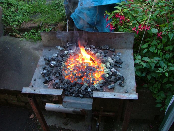

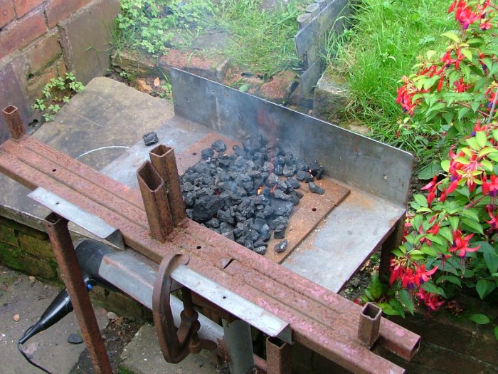

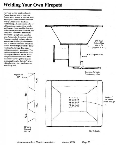

I've noticed a bit of interest in forges so I thought this might be useful to someone.
These are the plans ? I used for my forge, the only difference to this was I used 1/2" rather than 3/8". The fire pot is set in the middle of a metre square piece of 3mm sheet in an angle frame. Its the same design forge that I have used twice at different smithing courses. For a blower I use an an old extractor fan.
